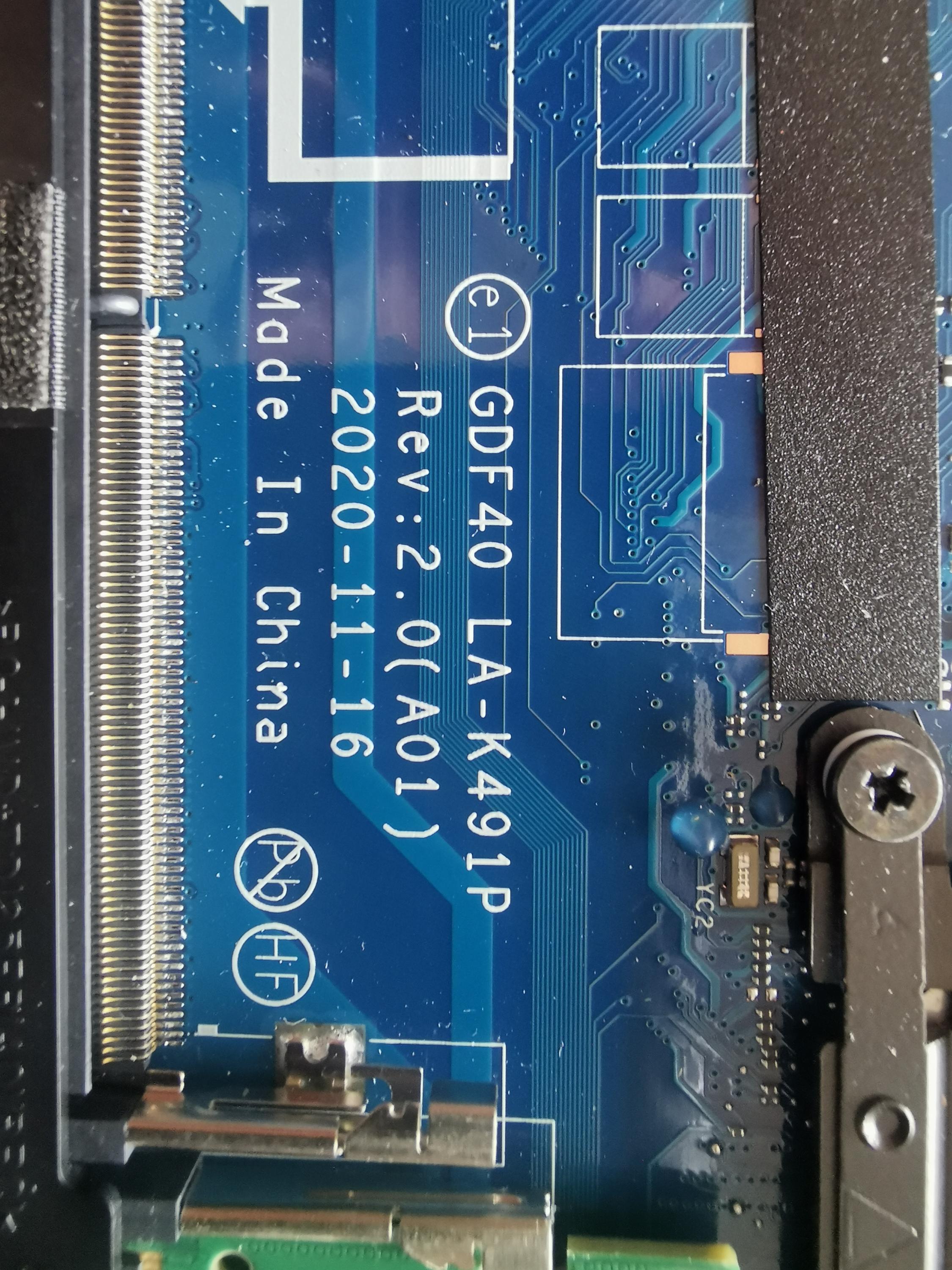

    Hello Everyone, cant you help me unlock Dell Lattitude 5420 main GDF40 LA-K491P rev 2.0

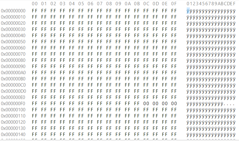

                            Hi guys I'm looking for some help, please.
                            I've got a dell latitude 5420 (CPU 11th) with a 0001 code, would anybody be able to help? I'm not sure if I've read the correct bios chip.
                            Many thanks P

                              48kb seem so far away from the real capacity , can you post a picture of this code !

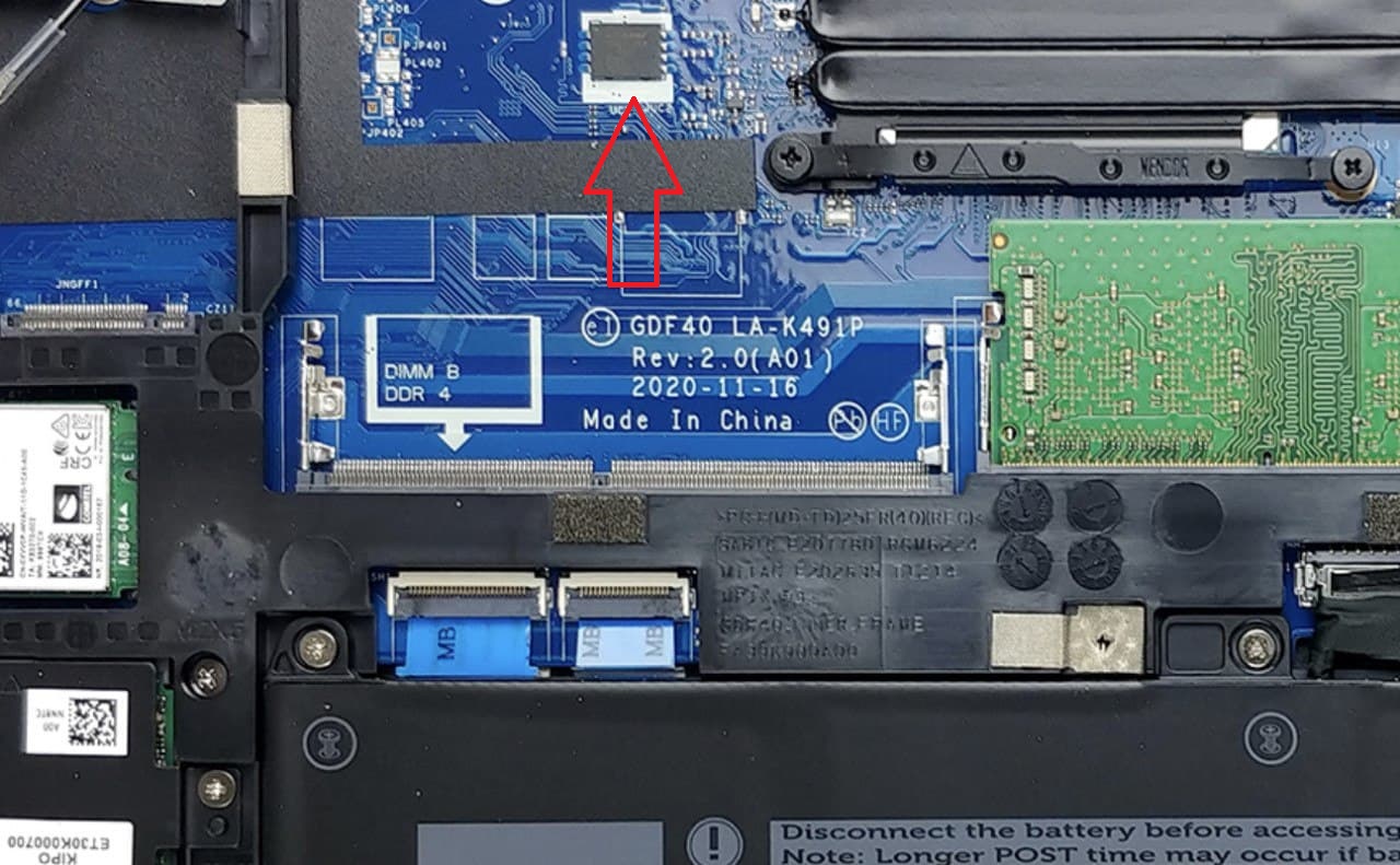

                                Hi lapfix
                                I attached a screenshot of the code and of the motherboard, not sure if I'm reading the right chip
                                Many thanks

                                  25r256jven

                                    No it isn't , you must find a chip write on it = Q256
                                    And picture of this code = 0001

                                          The AsPogrammer I used detected the chip and read it as 25r256jv

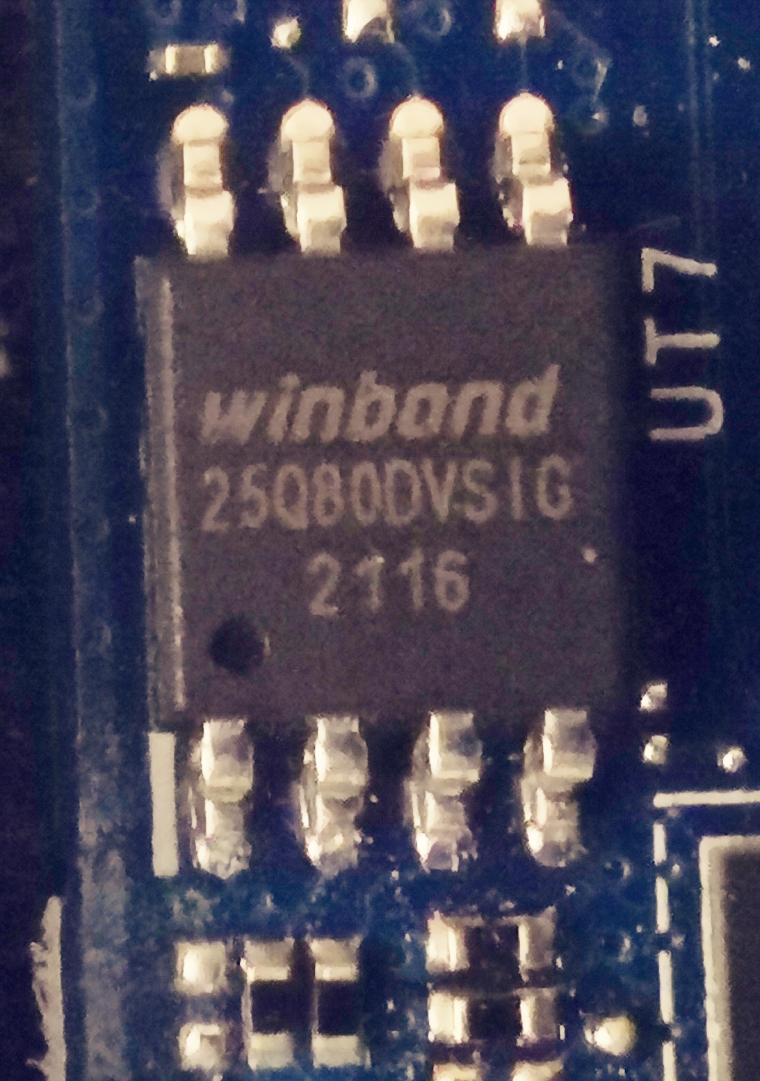

                                            EC dump request – Dell Latitude 5420, GDF40 LA-K491P Rev 3.0, MEC5107-LJ
                                            by mirjana
                                            I need the EC firmware dump for Dell Latitude 5420, motherboard GDF40 LA-K491P Rev 3.0 (A02).
                                            The embedded controller is MEC5107-LJ (UE1).
                                            The EC flash chip is W25Q80DV, 8Mbit (1MB).
                                            I already have the 32MB BIOS dump (W25Q256JV), but my system is still not powering on — just amber blink. I suspect the EC firmware is missing or corrupted.
                                            If anyone has this board and can share their EC dump from the 25Q80DV, I’d be very grateful.
