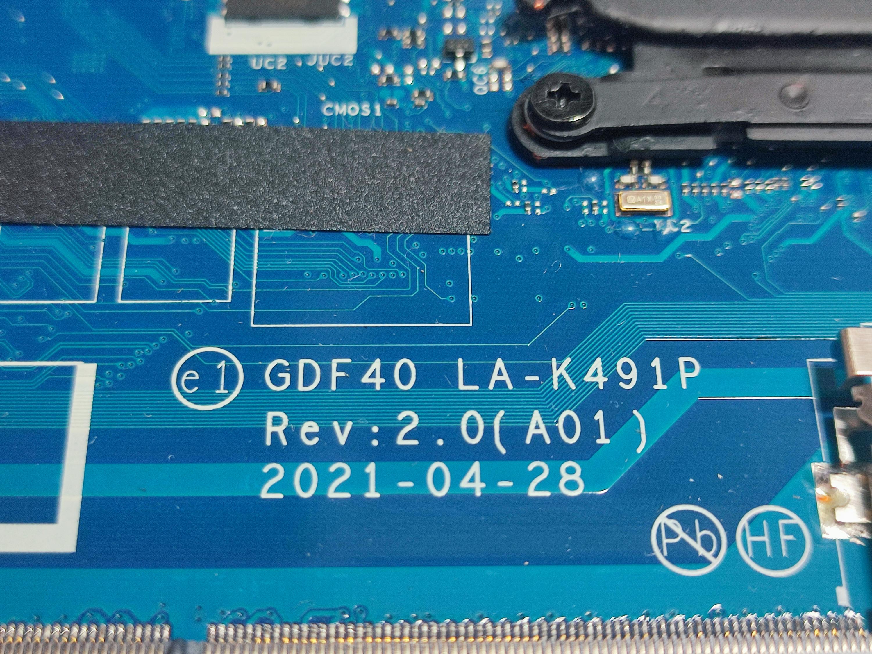

    Motherboard: GDF40 LA-K491P REV:2.0 (A01) 2021-10-15
    CPU: i5 11th
    Reg Model: P137G
    Service Tag (ST): D2DJKN3
    Secret [encryption-type] password: 8FC8
    i need help !! thanks in advance

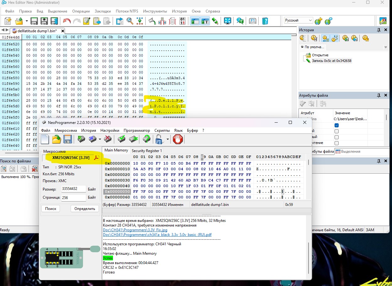

    I tried files and they did not work. I still get a black screen with the fan spinning.

            Not working , but reading again, it shows that there are changes in some parts compared to the original

                  you read twice same dump and when compare you find some change !!
                  if yes whish programmer and software do you use !

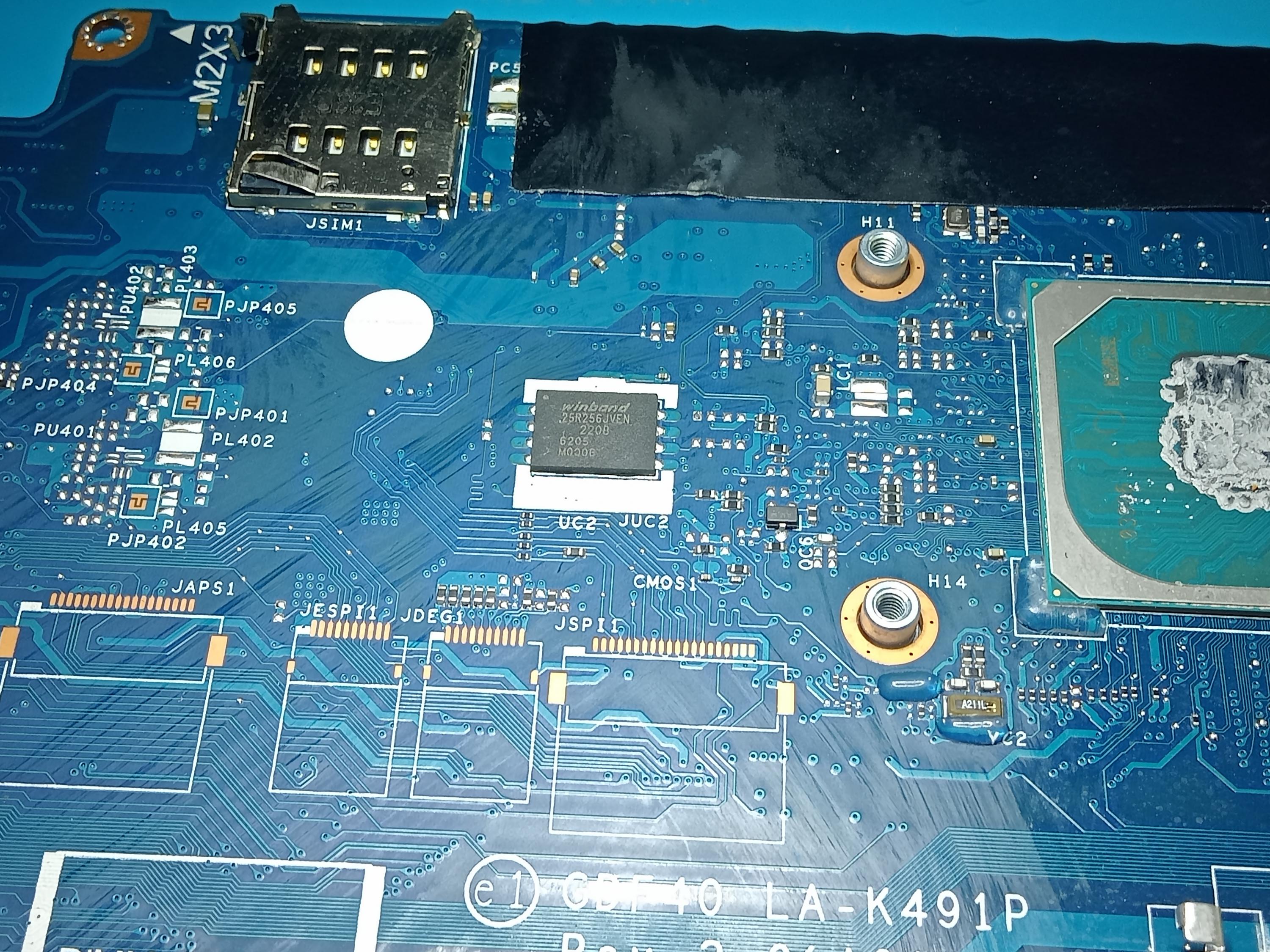

                          Is this your Service Tag "C4YPWD3"?
                          Always add some information about your device, such as (Model Number, Serial Number/Service Tag and Motherboard Number).

                            S.TAG:- C4YPWD3
                            Dell Latitude 5420
                            your Me region corrupted. Here i build a fresh new bios so any one can use this and add there service tag as him/her laptop from bios setup

                              no , After modifying and installing the Bios chip on the motherboard, the aforementioned error occurs
                              Originally posted by DZ-Developer
                              thx for help but the same problem
                              I tried file and they did not work. I still get a black screen with the fan spinning.
                              Then I lift the chip again and read it, I find a difference from the original file that I read before installation

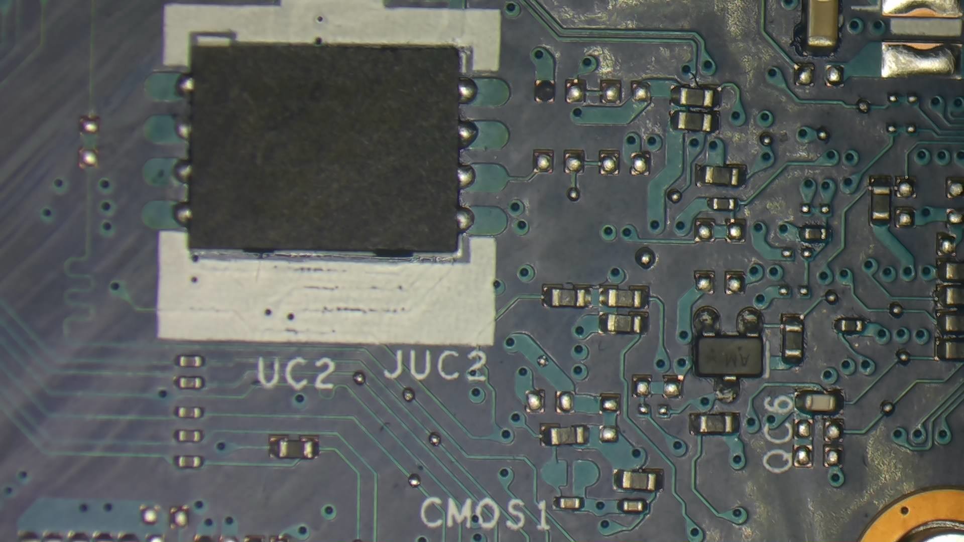

                                  #496
                                  Re: need bios dump dell latitude 5420 (cpu 11th)
                                  Hi all. something everyone has other BIOS flash drives, but I have this ...
                                  is it possible to flash it on ch341?
                                  in the selection options there are no options for my flash drive, I chose a similar one. Is it possible to do so? dump saved please tell me

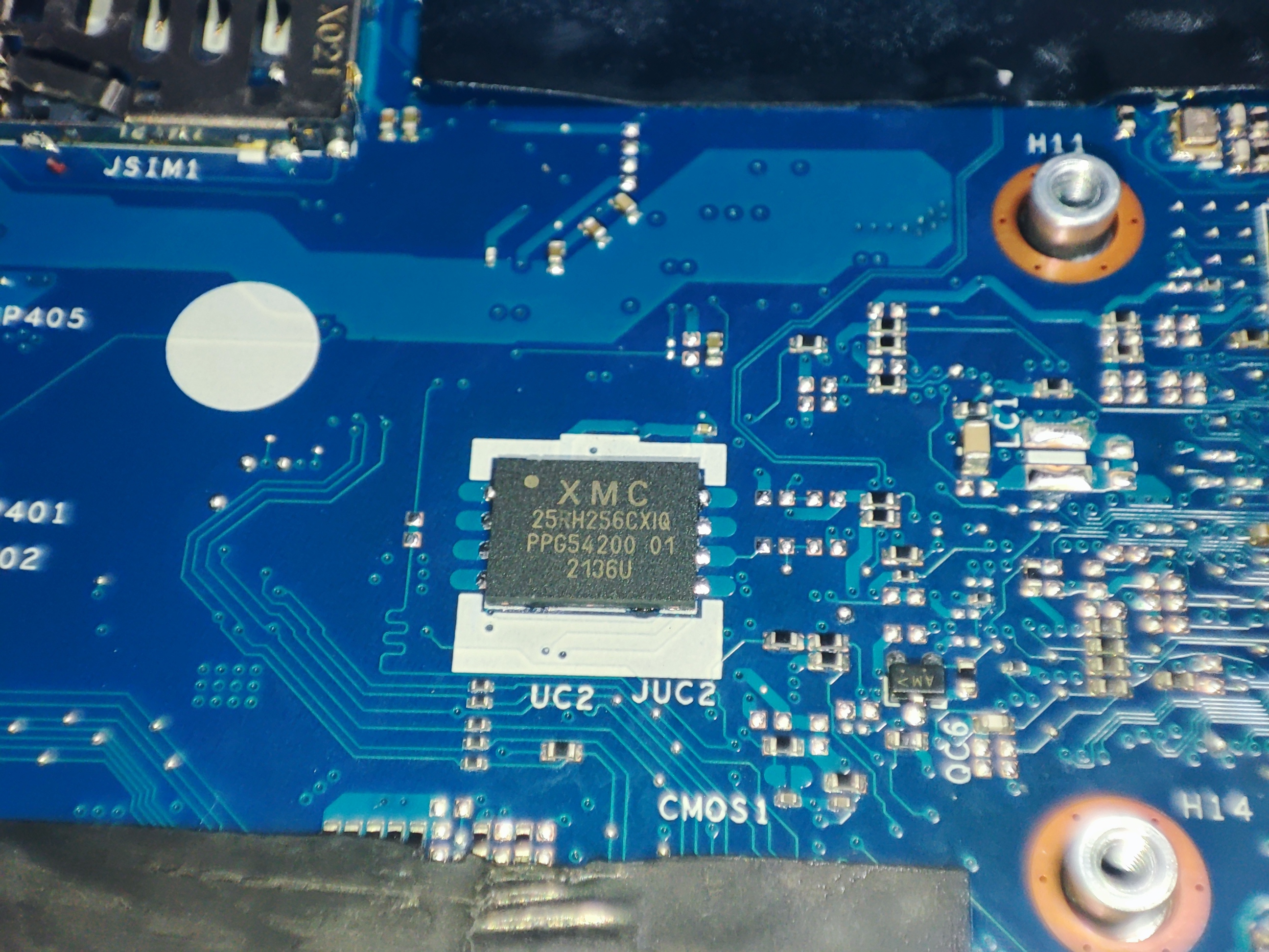

                                    Hi, is 0001 support available? 25R256JVEN chip latitude 5420. Dell does not want to help I tried many times. Can clip read the chip or is soldiering needed?

                                      Better desoledering and upload here...somone will help you

                                        Haha I dont know how to desolder unfortunately I was trying to do with clip but just get ic not responding. Dell dont wanna help beacuase it has computrace and company lock. I buy it like this. Anyone want to buy the laptop? lol!
