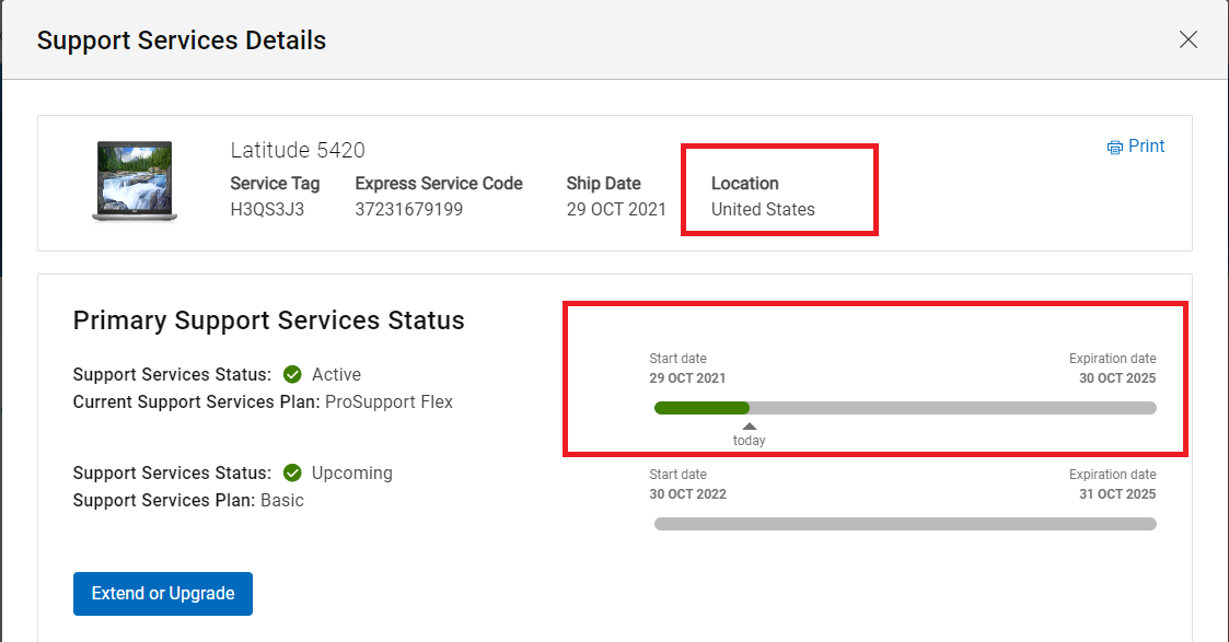

        Re: need bios dump dell latitude 5420 (cpu 11th)
        Anyone service tag H3QS3J3-8FC8 currently locked and need unlock admin pass?
            The device has a very long warranty, please contact DELL support.

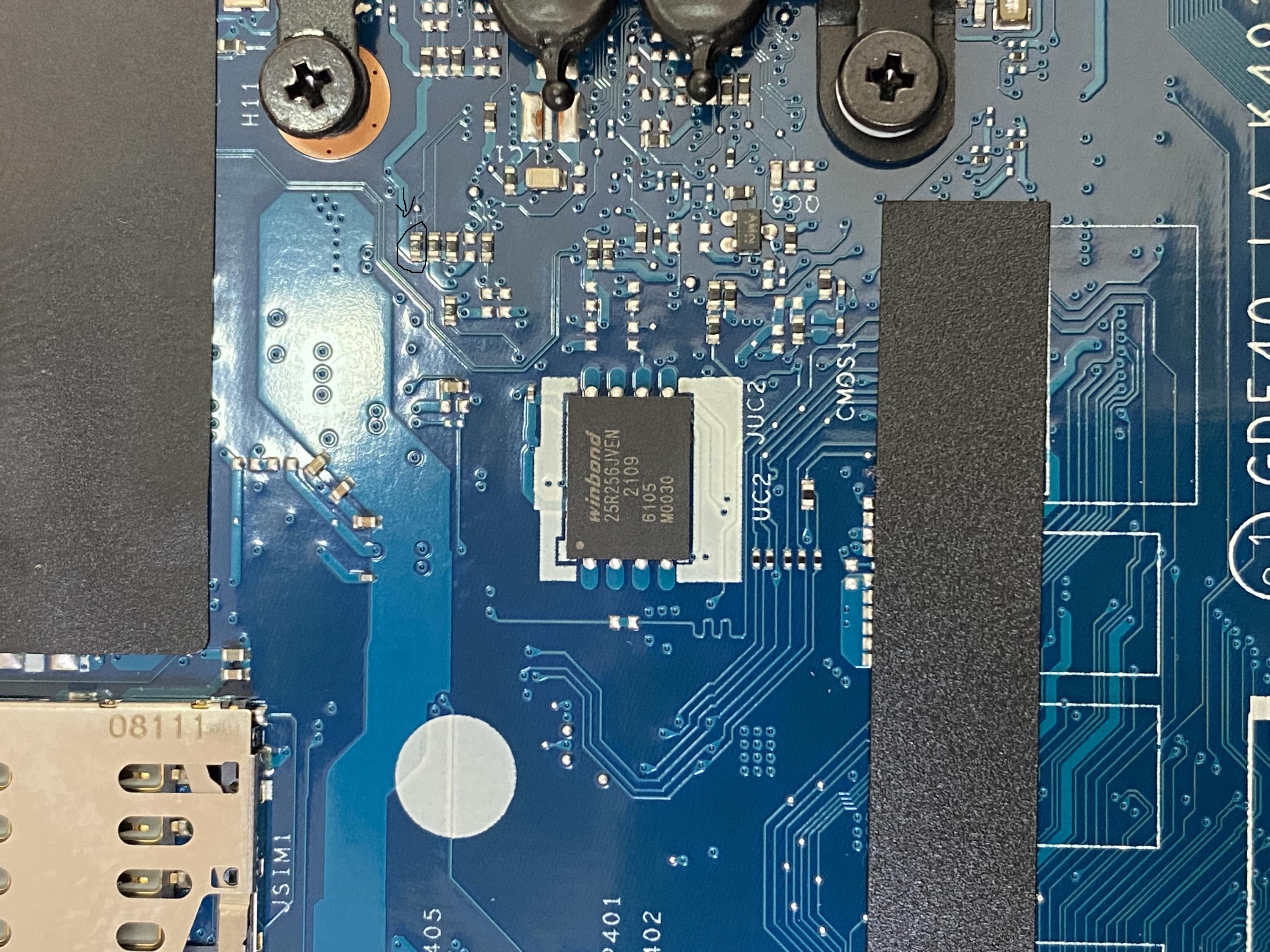

            • amine23
              • Apr 2017
              • 89
              Hello hoaca338 it dosnt work clean me my backup need repair
                  If with the original file (the locked file) the device does not work, then there is a very high chance that you have damaged some component on your motherboard yourself.

                    #249
                    every thing is good i changes the bios winbond 25q256 now is turn on but the laptop show only diagnostic colors

                      #250
                      Try testing the output through the HDMI port.
                        there is no external display and there is 6 codes white and 3 oranges it mean recovery bios is corrupte

                            #253
                            Hello bro
                            i have found the problem its an resistor removed by hot air i need to know the value of resistor

                                  #256
                                  Hello bro
                                  Hi Bro did you find the value of the resistor, I have an operating board to measure.
                                  • amine23
                                    • Apr 2017
                                    • 89
                                    • Algeria
                                    #257
                                    not yet bro
