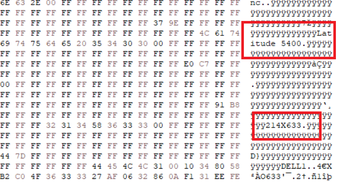

    Hello, there is a dell 5420 11th gen i5 with locked bios (board model GDF40 LA-K491P Rev 2.0), i've tried a dump belongs to someone else and it worked except that there's no nvme detection, when i went back to my original backed-up dump it didn't work, i think it's corrupted or something, could someone help to check and unlock please ?
    here's my original dump
    Any help with this one please..

              Is this your sevice tag : Service Tag: 214X633
              Try:
                Try:
                No, my ST is: H5456D3
                did the tech-guy screw with the original ?
                  I saw it on your file
                  • mohammedsf
                    • Jun 2014
                    • 16
                    • Lebanon
                    #109
                    Re: need bios dump dell latitude 5420 (cpu 11th)
                    I see, so i believe my original is lost..
                    how to deal with lost/corrupted/dead chip in this situation ?
                    the second file (Working - missing Option ROMs.rar) works but lacks nvme drivers, can you fix it for me please,,
                    could it be flashed with a working official file ?
