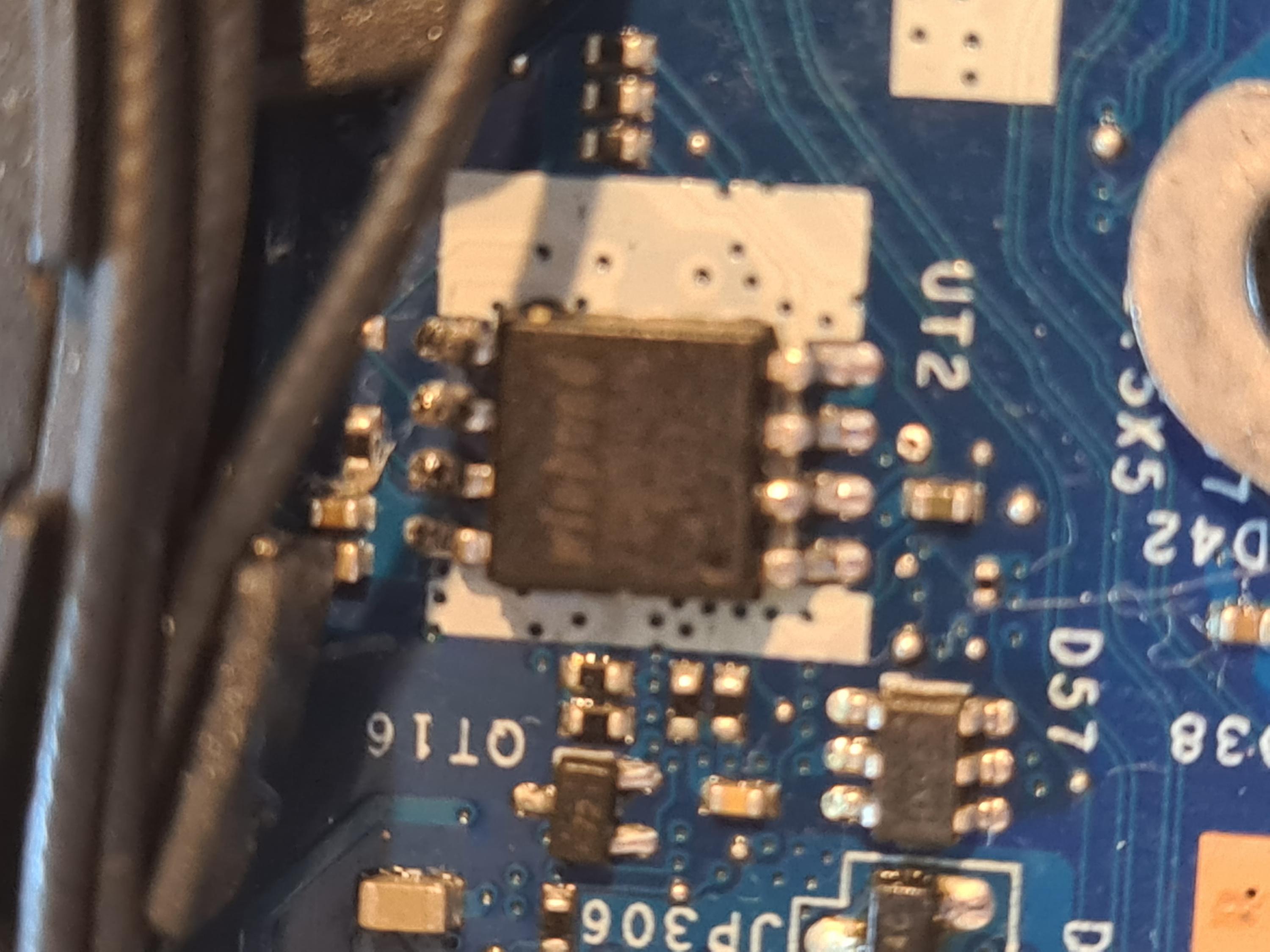

    I was trying to remove a bios password, I removed these chips and read the data from them and unlocked them via the awesome tool on the forum but upon soldering them back now my darn laptop wont switch on and the power button flashes and also the charging port is illuminated
    I likely messed something up, am using a tl866 programmer, also could anyone be so kind as to show an image of bios chip orentation for this model incase I made a booboo

          Sometimes the unlocker tool doesn`t work.Are the bios at post #1 the original backups.Post a picture of the bios chips on the board

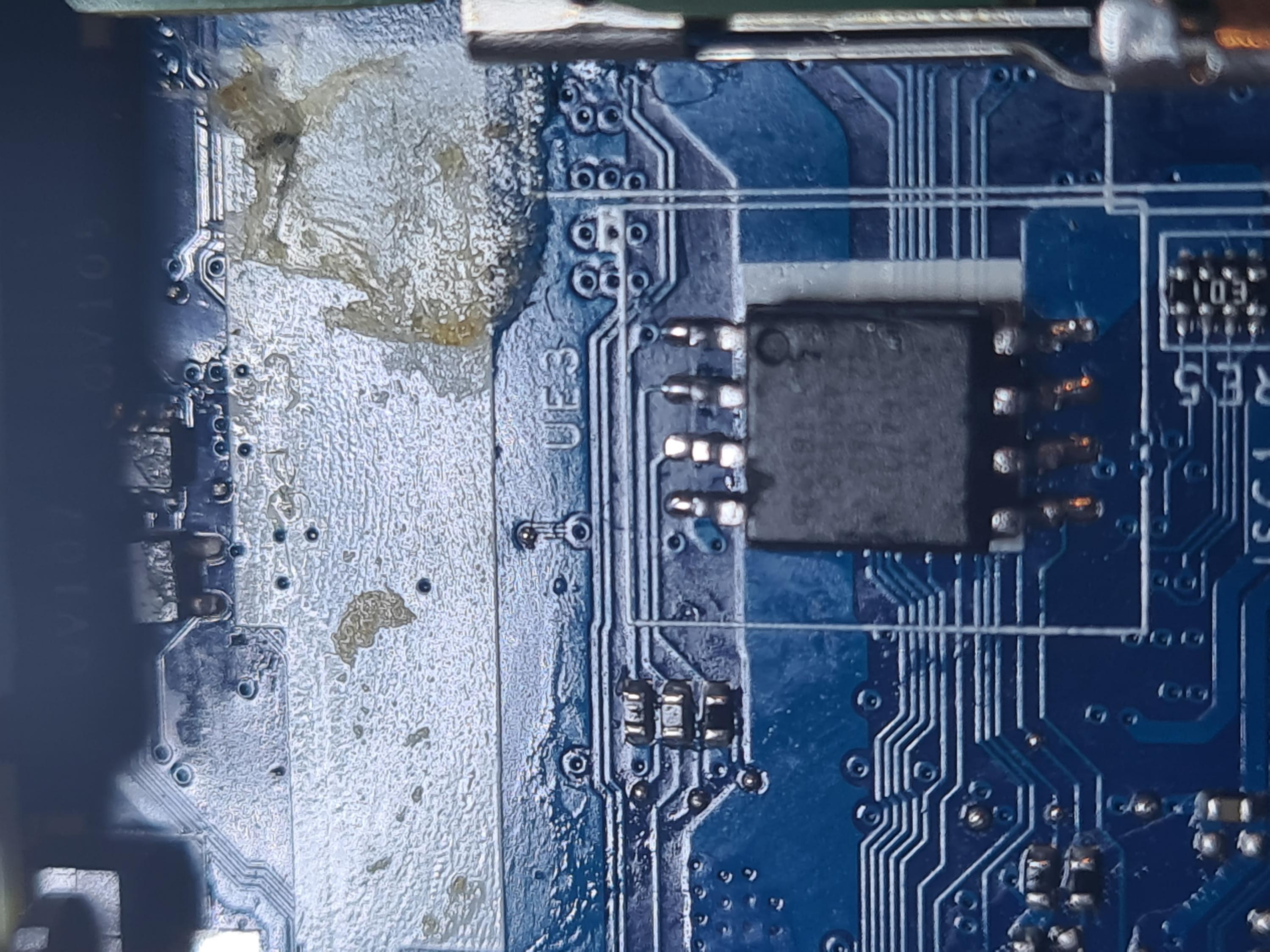

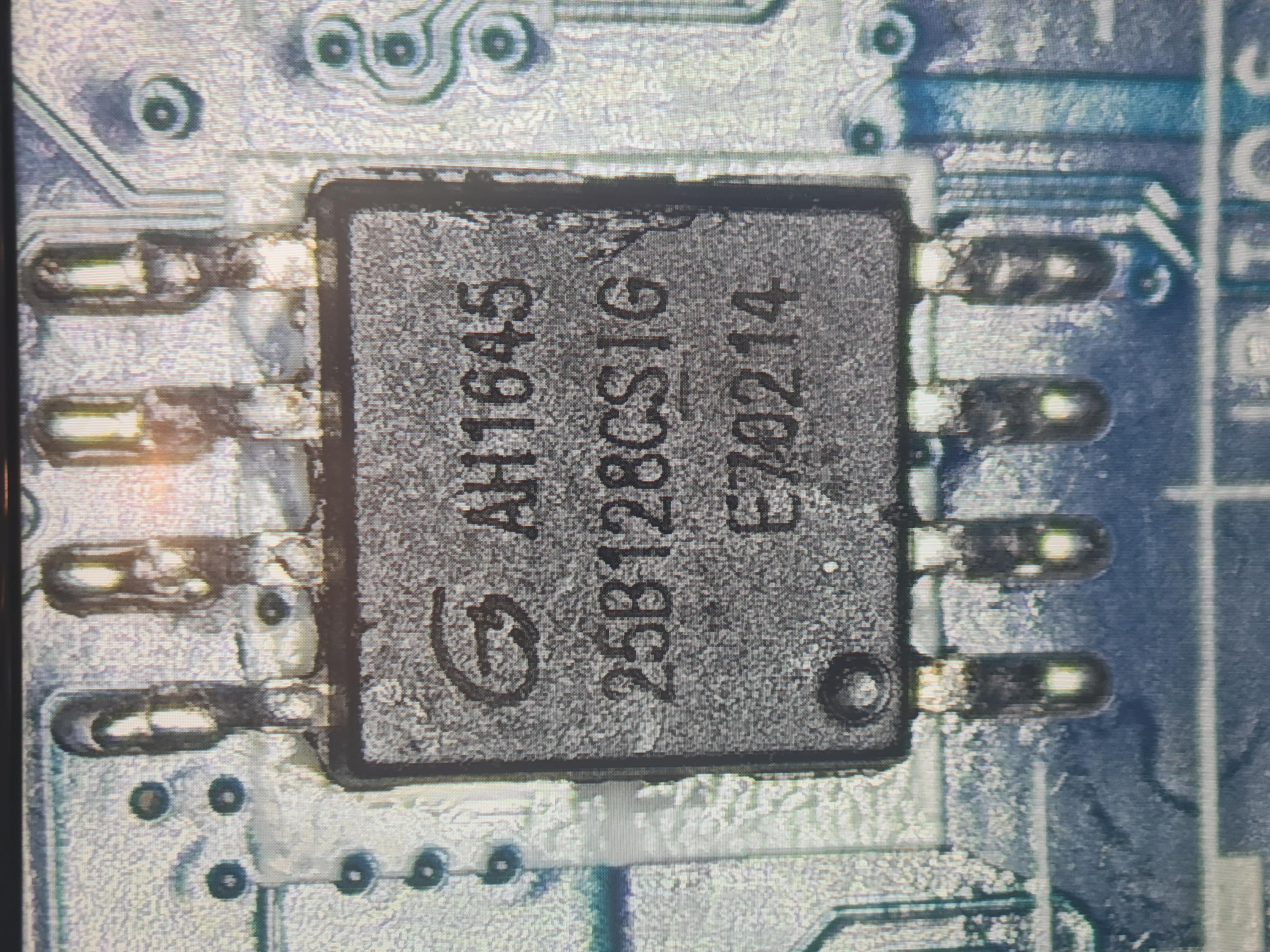

              Here's the pics

                  Check UT2 ,the 1st picture, pin 4 of the chip is GND.Test the pins with a multimeter. Looks like its the wrong way around

                    Orientation was correct , I checks ground with multimeter and was algood. Currently got a power light and charging port light. I think my reads maybe bad can anyone please help. Thanks

                      No start/image was fine leading up to desoldering and reading of bios. Also very well soldered back
