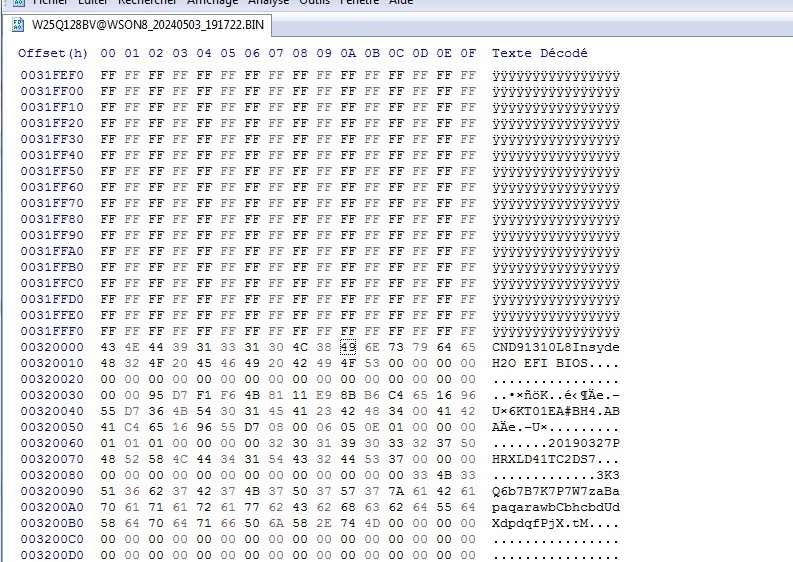

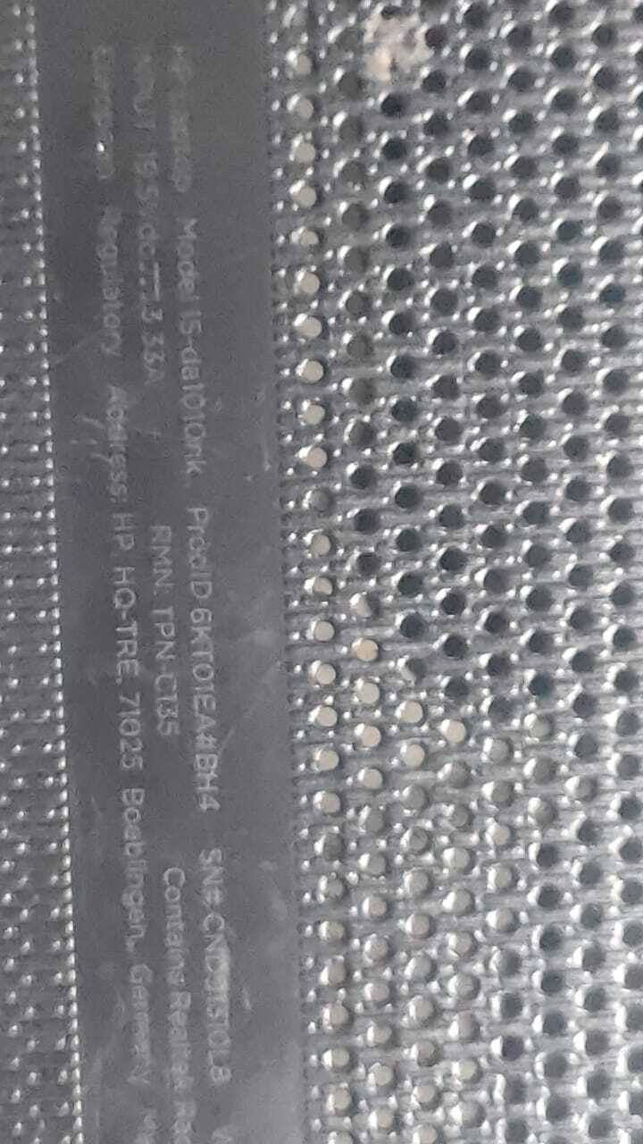

hello
build bios i7 8eme gene G07FP
SN IS CND91310L8Attached FilesComment
Every donation made will go towards server fees and maintenance costs.Comment
DMI and KEY WINDOWS @ 320000-32103FAttached FilesComment
