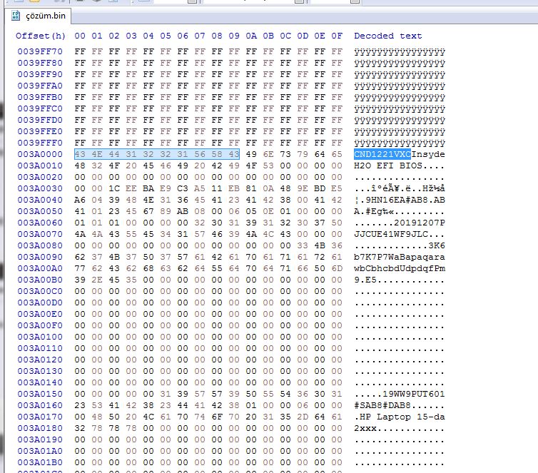

            LA-G07FP REV: 1.0 need bios
            HP 250 G7
            EPW50 LA-G07FP REV 1.0 need bios
            old bios
              • 21453
              Re: LA-G07FP REV: 1.0 need bios
              Originally posted by tugrul63
              HP 250 G7
              old bios
              The bios you posted is for a 15-da2033nt ,the serial is CND1221VXC
              What serial number do you have on the case ? .
                sn:CND1221VXC
                  • 21453

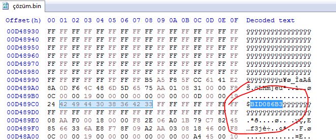

                  Re: Bios for LA-G07FP
                  Your bios version is BID086B3 .
                  There`s a virgin bios in this thread -> https://www.badcaps.net/forum/showth...ighlight=086B3
                  Use a hex editor and copy your DMI from your backup to the virgin bios, the offsets are 3A0000 - 3A103F

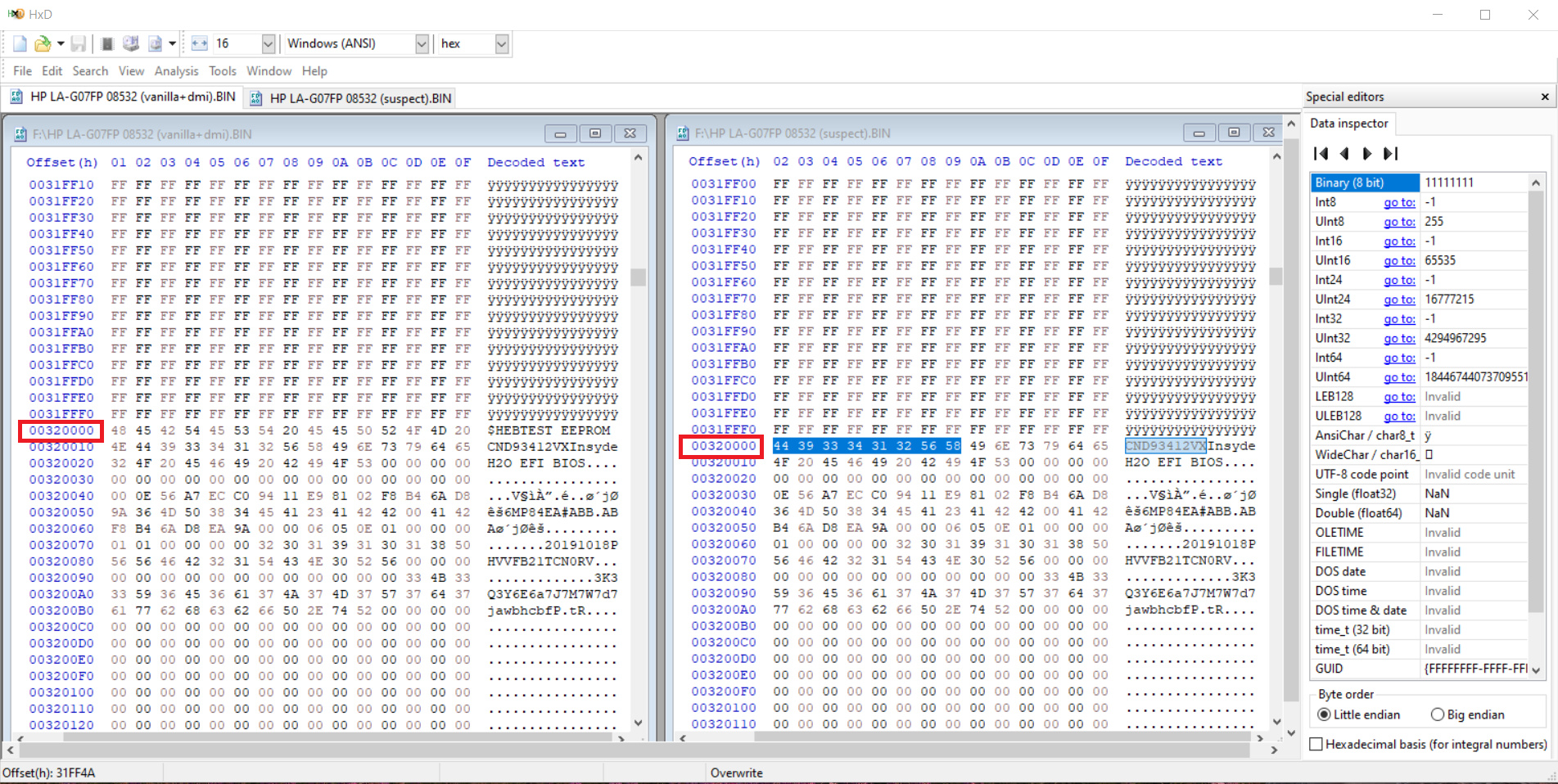

                      I have this laptop here as well. It shuts off after a few seconds. I found out which BID number I have so I downloaded the corresponding bios here. Then I inserted the DMI of the original Bios in the downloaded one.
                      Now the laptop turns on, stays on after some ram training but the screen remains black. A new screen does not change a thing.
                      Could somebody please take a look at the attachement? It contains the original dump and the clean HP bios with my DMI inserted.
                                With its original bios the laptop switches off after six seconds.
                                With the new bios it stays on, but does not post, so for me there's at least something with the bios. Unless the new bios doesn't to the point where the original crashes.
                                I can not prove to myself there's a bios problem.

                                  Here's the reason
                                  • dr.thodt
                                    • Apr 2016
                                    • 83
                                    • Netherlands
                                    Thanks for pointing me to that hoaca388. I fixed my mistake.
