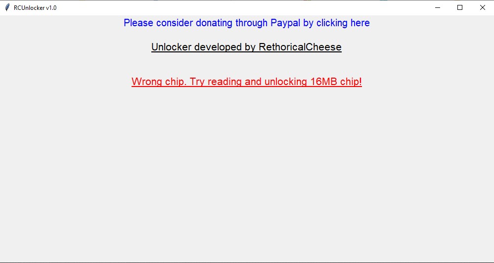

                              #54
                              Re: hp elitebook 745 g6 amd bios unlock
                              Didn't work

                                #55
                                Originally posted by bioteux
                                Didn't work

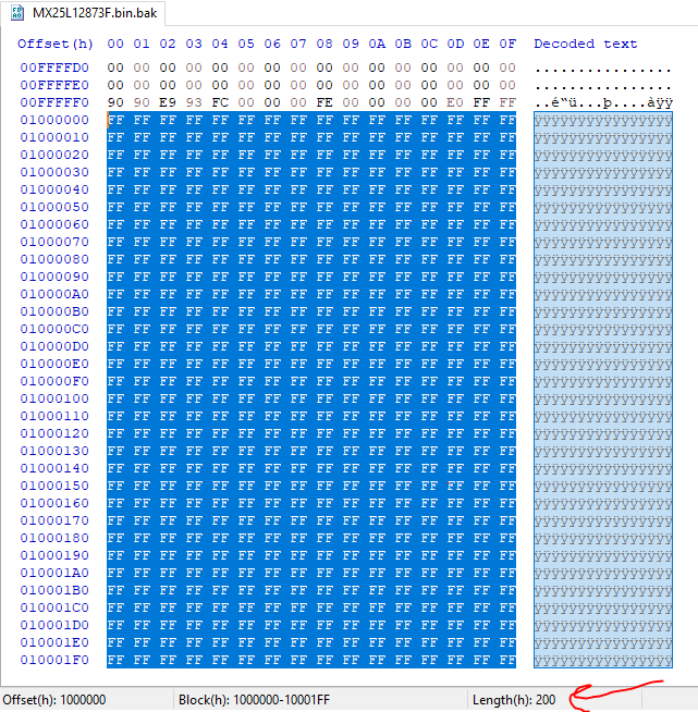

                                You are facing this error because your BIOS file has a larger size than the normal file, delete the extra (200h) length in the end of your file and try again.
