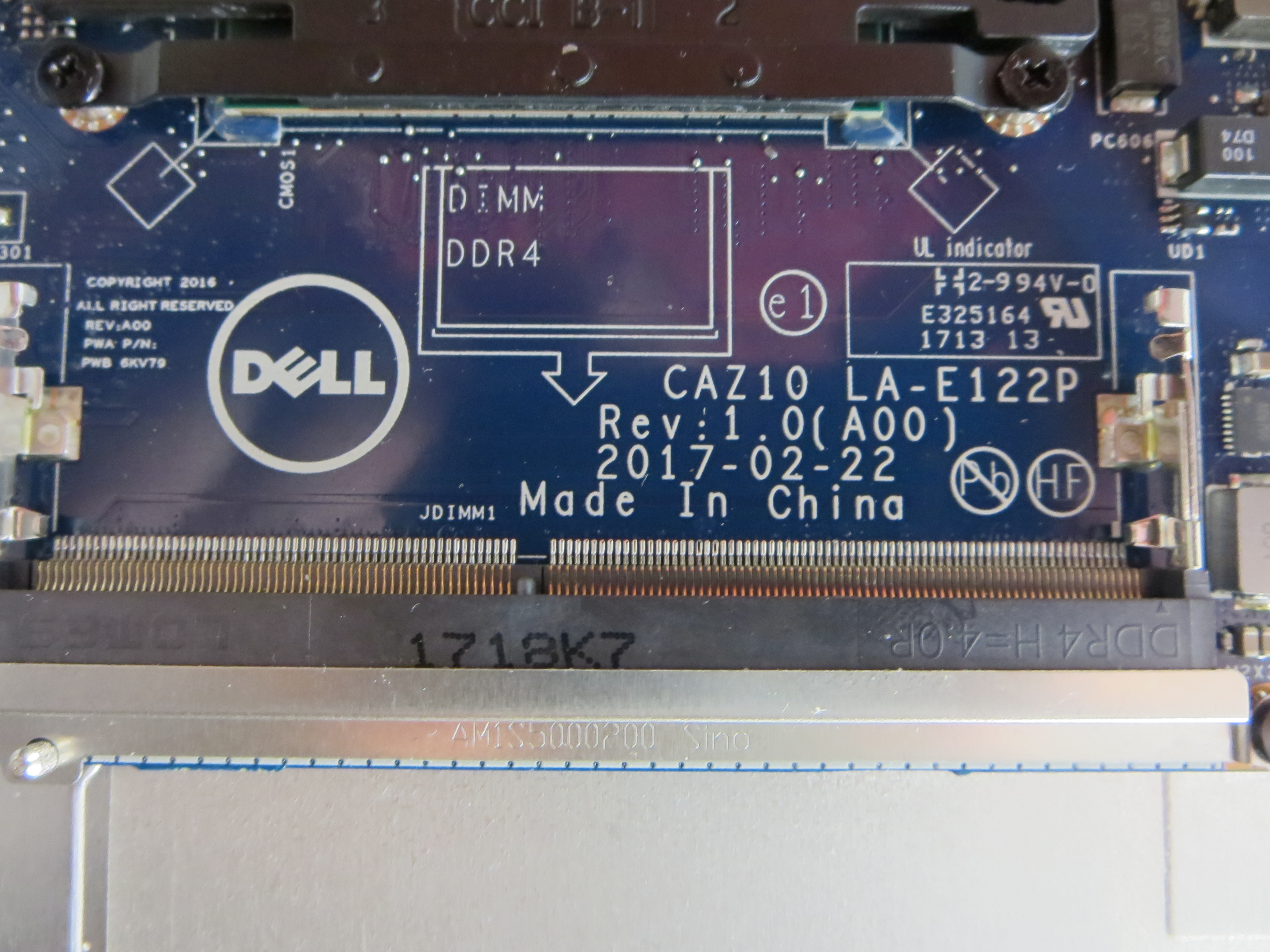

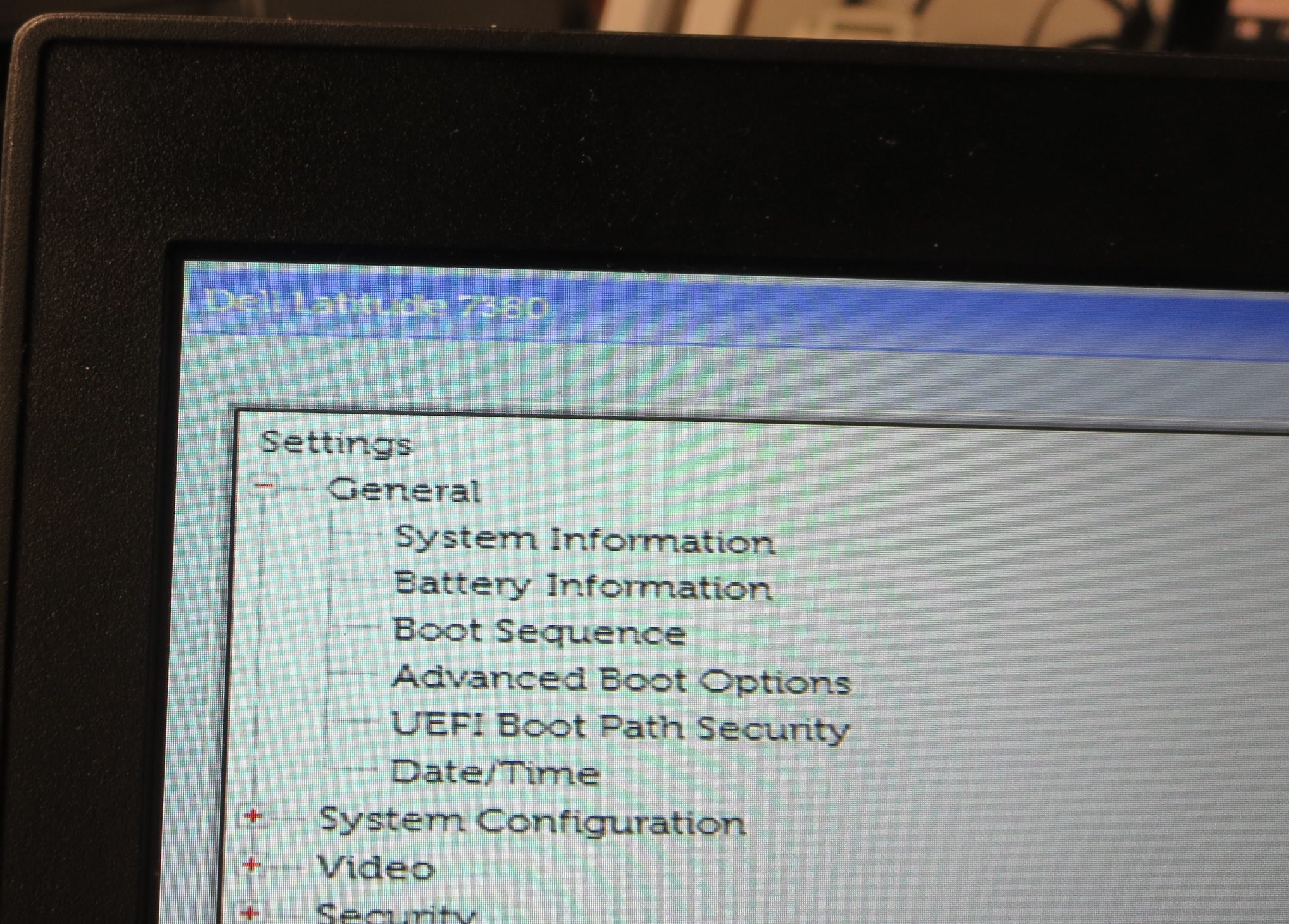

    Hi there,
    I need bios dump for Dell Latitude E7280, i5-7300U, CAZ10, LA-E122P.
    The original was not working (power up for one sec and off).
    Found one file on "alisaler", flash it, power up ok, but on the bios show as E7380! also some coils are whining...thanks!

      Re: Dell Latitude E7280
      Hi Bassbabu,
      Thanks for your reply,...I got and old bios file ver. 1.9.3 for 7280, LA-E121P and is working better!
