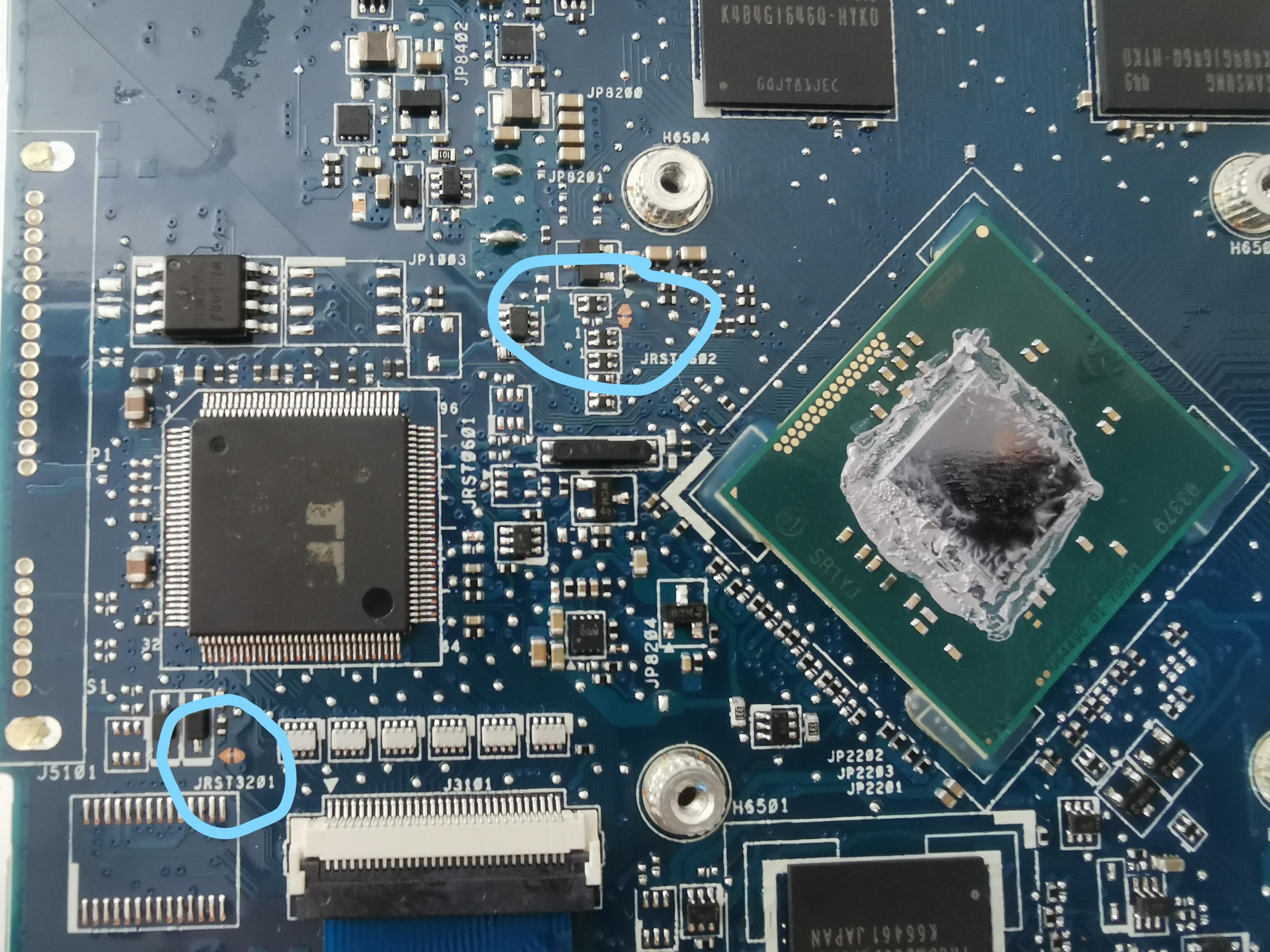

    Hello, i need the bios password of a toshiba laptop model cl10-b-103.
    I doesn't found a password reset pin on the board, and doesn't found a dump freee of password. Could you tell me where i can found in the dump ? Which line ? Otherwise i put the dump with the message if anyone can tell me the password. Last solution if anyone have a good dump i can flash it. Thanks

    Hello , i answer to me so my answer can help the community. There is two reset pin on the board. One name jrst3201 under the ite chip and the other named jrst0602 on the left of the cpu. This last one is the good one to delete the password. For info i have hard to use it because it seems the contact is not good. The solution i used is to open the laptop put on the end of the table and fil it on the keyboard so the screen is in the fall so i can put a flat screwdriver on the pin and made contact. So i start the laptop ( mine without battery only ac adapter) and the laptop shutdown after few second. I release the screwdriver and start the laptop again and YES no password again, only date and clock reset message. Hope my info help someone. Thanks
