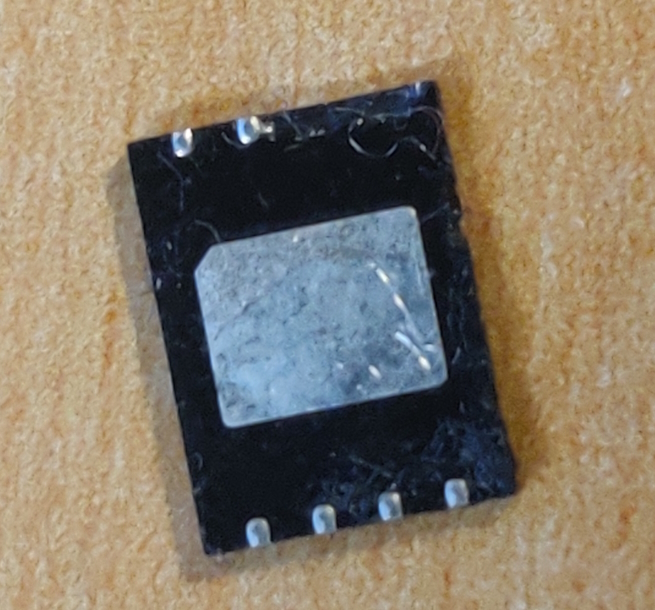

              Hello guys!
              I've read a lot here, but unfortunately I can't get any further. Actually I only had one problem with my BIOS, then unfortunately I destroyed two contacts when unsoldering the main chip, so I haven't found a way to read it yet.
              For this reason I bought two new chips. These also work and the notebook is running again, but I have no idea how to activate MPM. Because the DMI information is incorrect and I cannot change it. When booting, the error always appears that there is a problem with the Security Device Unit.
              Since I can't get to the data from the main chip or don't know whether it's possible because of the broken contacts, I only have a backup of the original EC available. I have a backup of the new bios, but I don't know if that helps.
              I read something about this bin file that you copy onto a USB stick and boot from, but unfortunately this doesn't work. Then I read that you have to set the region to a valid one, but what exactly can I do to move forward?
              It's about an HP Elitebook 850 G5. Have already found all the data:

                      I flashed the file. Unfortunately now only the fan turns on and Power and F11 light up. Only black screen and no boot.
                      However, I have to admit that before I saw your post, I tried a bios update, but that didn't change anything. I uploaded your file immediately afterwards. Is it possible that the EC chip now also needs to be reloaded?

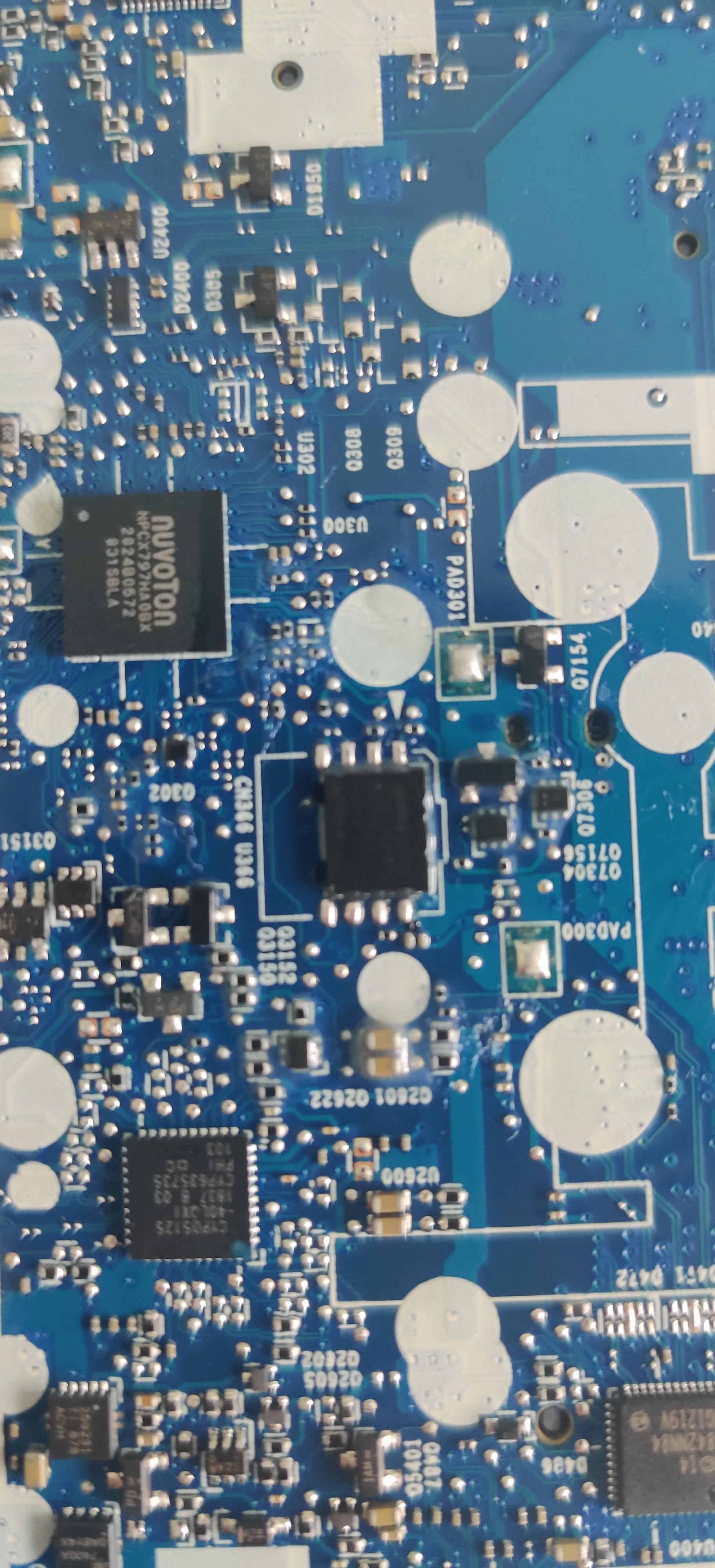

                              Fan rotates and F11 lights up. I don't understand that. The last thing I did when the laptop was still running was to update the bios to the latest version. Is it possible that some controllers aren't working with your files?

                                Carefully check the bios chip area, especially the small components around the bios chip pin.

                                  I think my motherboard is broken. I soldered all the pins again. The notebook no longer wants to start.

                                    No longer starting just look for an unsoldered pad or a short around the IC

                                      Okay, I'll check it out. Actually not much can have changed because I always read and write with a pogo probe. So at the moment the laptop starts up without a picture and only the fan is running and a lamp is on, even without RAM and SSD no beep code. I'll check it again and report back. I thank you all!
