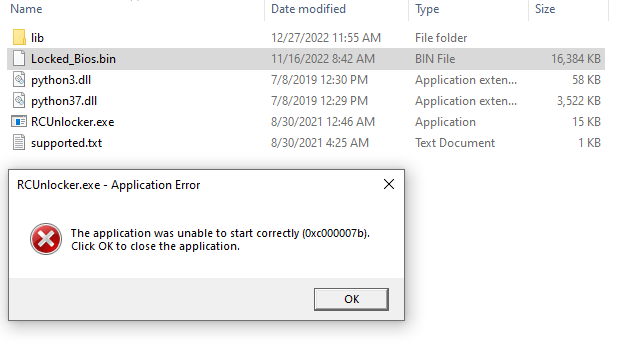

      Please help, I'm trying to use the RCunlocker by dragging a .bin file the the .exe but fails. I will attach a screenshot. Do I have to place the RCUnlocker folder to a specific location?
      Thanks in advance

        What python version do you have installed?

          drag in "exe"

            Version 3.11 Sir

              Yes, that's that I'm doing. I drag the .bin to the Rcunlocker.exe.
              @peste

                  post the bios here...

                                    I used the HPUnlocker instead and it works. Thank for responding Sir.
