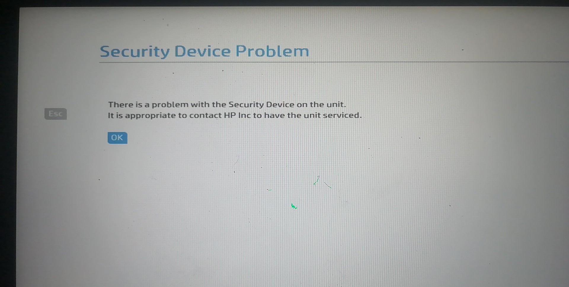

              @RethoricalCheese
              HP Elitebook 745 G5 Security Device problem
              after i used rcunlocker to clear password from main bios i got this error
              i tried many bios but same problem , i put back the original but no change

                #607
                Re: RCUnlocker
                Clear main bios VSS region and later add SN etc back in bios.

                  #608
                  Re: RCUnlocker
                  thank you sir
                  problem solved after Clear main bios VSS region
                  mpm unlocked
                  write back data
