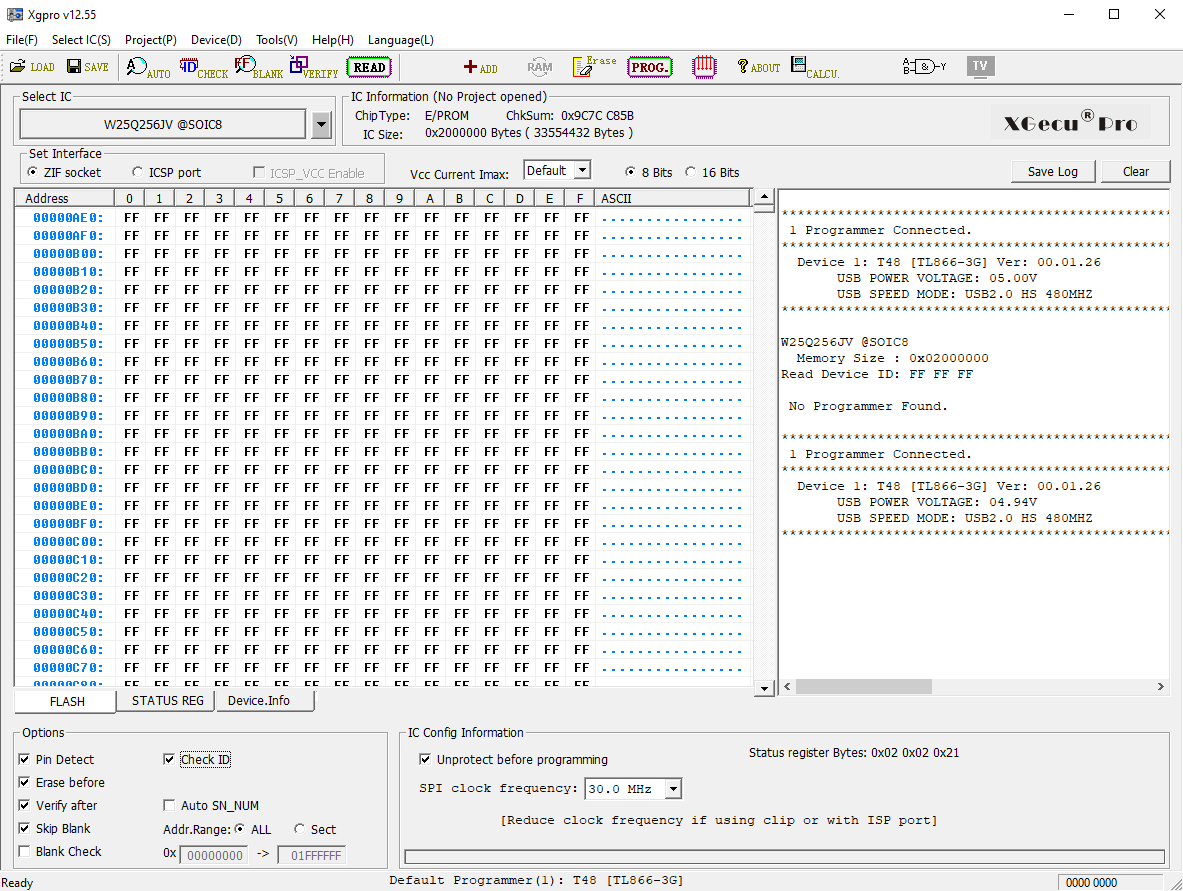

                          I have tried it again and verified.

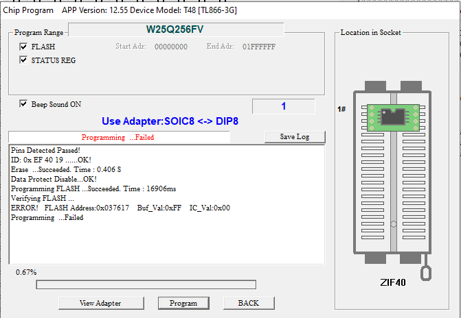

                              Appreciate the help. But....I am getting this error when I program the EC. Help please!
                                I don't know exactly what the problem is, most likely bad contact between the programmer and the chip. What is the connection type - wson8 to dip8 adapter or something else?

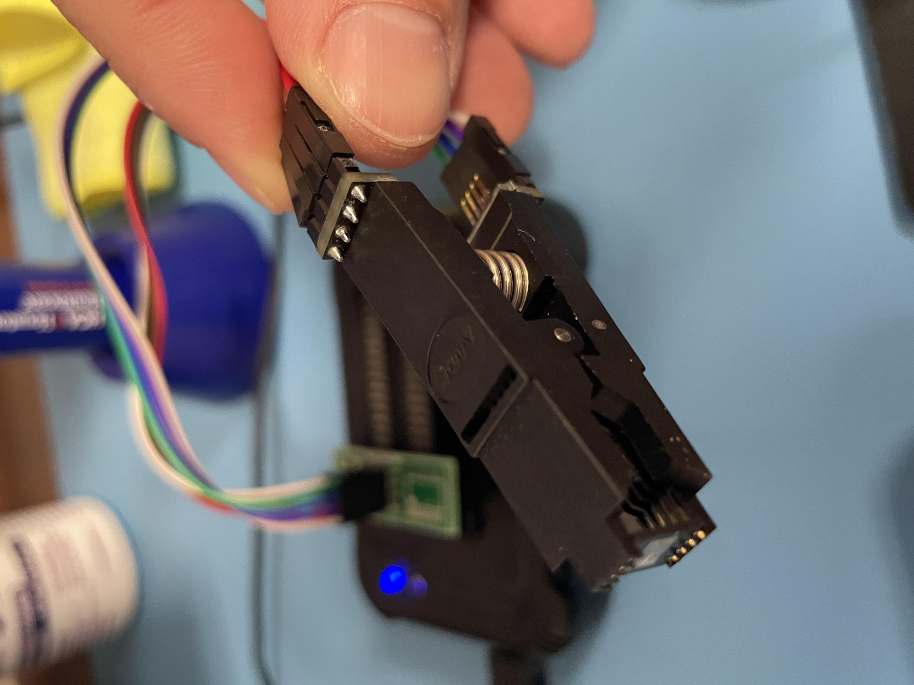

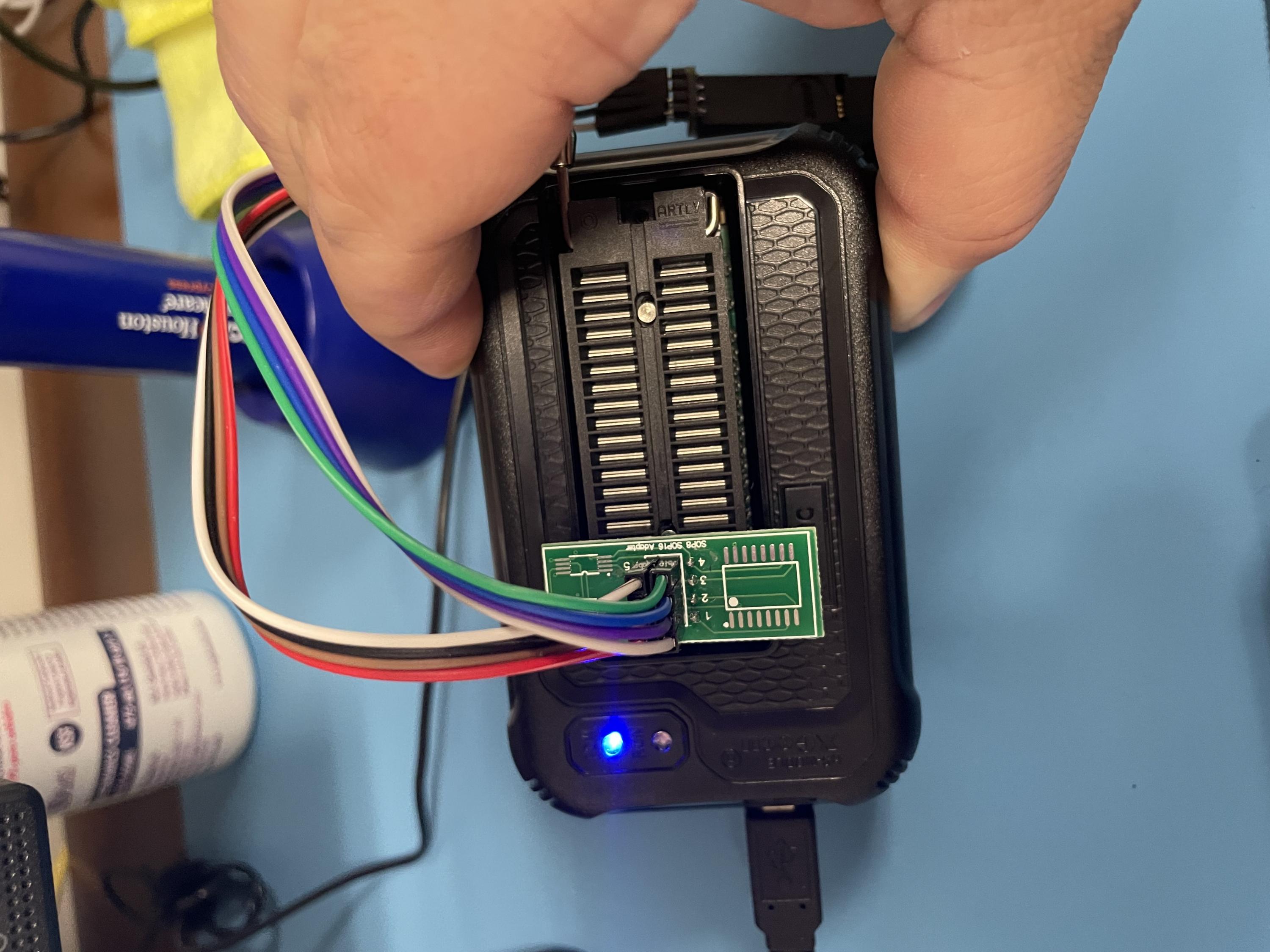

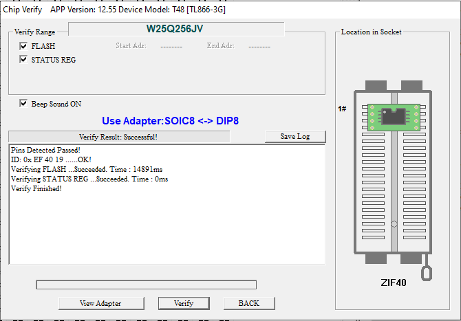

                                  I was able to program the original .BIN file back to the EC with no issues. I am using a tester clip socket.

                                    So what's the problem then, program the unlocked file the same way.
                                    This "tester clip" as you call it is not intended for use with WSON8 SPI flash chip hence the problem. This clip is designed to be used with SOIC-8 SPI chip.
                                    So as I already supposed - your problem is a bad connection with the chip.
