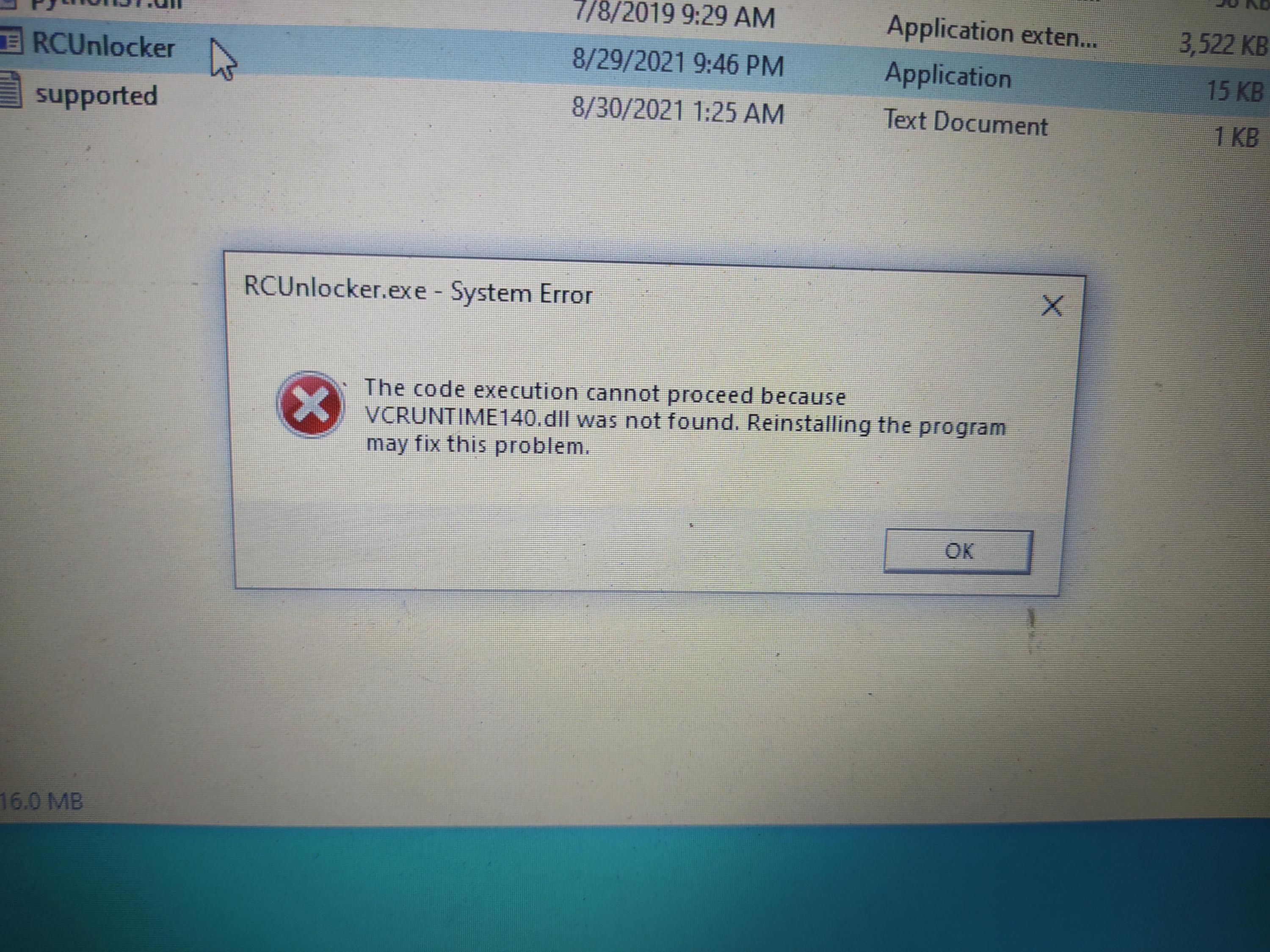

        Pls how can solve this issue,I've reinstalled the operating system, install a new vcruntime but I still get the same error message.
            Originally posted by Stefax2001
            I already reinstalled Microsoft Visual C++ 2015 Redistributable, nothing has changed.
            Originally posted by Vesko356
            Install both x32 and x64 files.
            Thanks, it worked.
