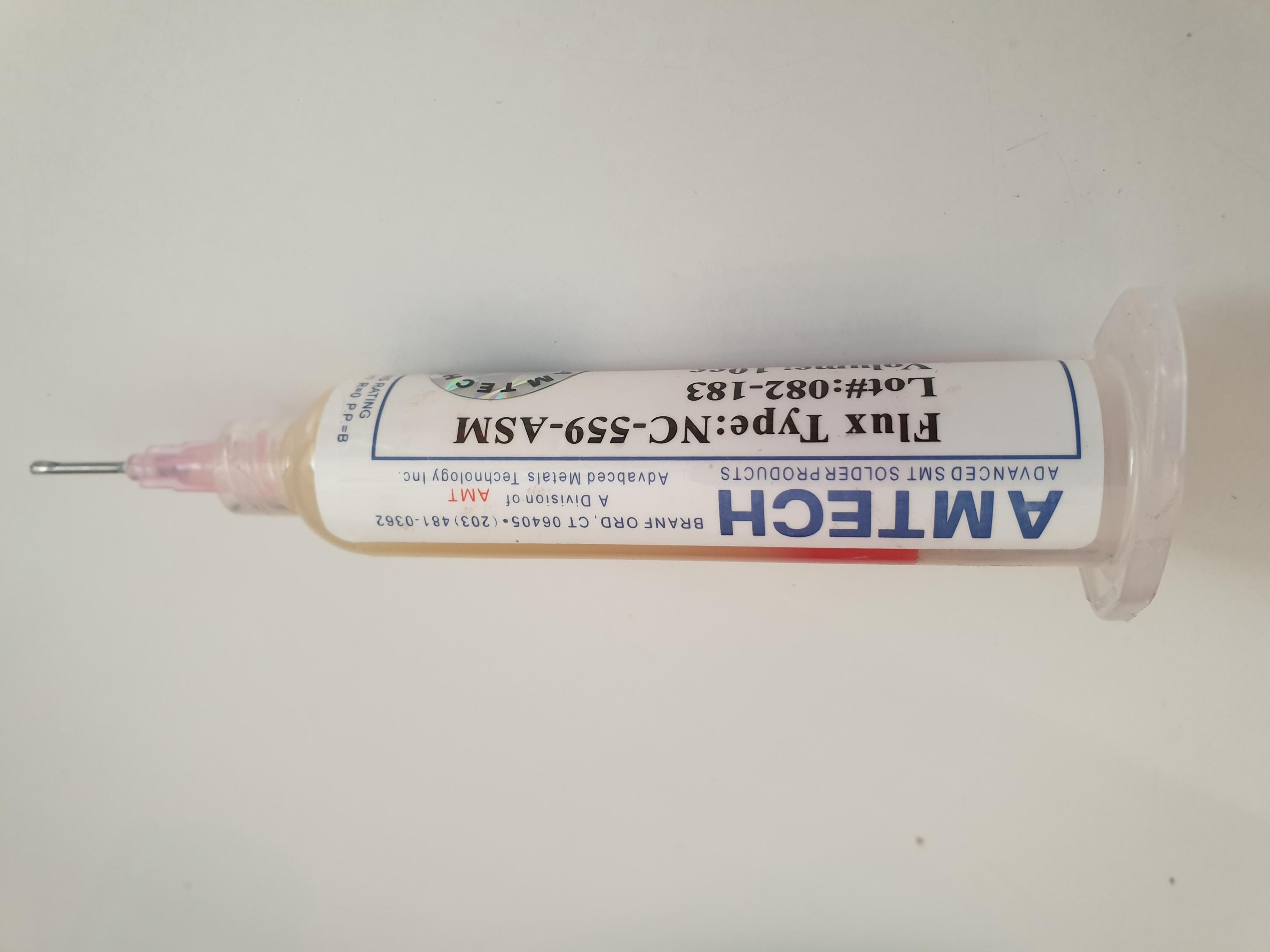

                        • hoaca388
                          • Jan 2022
                          • 11131
                          • Viet Nam
                          #272
                          Re: RCUnlocker
                          Originally posted by slightly_delayed
                          Hi, didn't work out....
                          Shaky hands, clumsy soldering iron, narrow space...
                          Don't get fooled by the pic/image in post #259 - no "big copper"-spots, about 2cm2 with tiny space between prone to soldering shortcuts (easy- and frequently)...
                          I'm again looking for other solutions/approaches....
                          Sigh....
                          You need a smaller tip soldering iron and a flux type.
                          Become a Badcaps supporter
                          Thanks to all supporters.
                          • slightly_delayed
                            • Nov 2021
                            • 11
                            • NL
                            #273
                            Re: RCUnlocker
                            Originally posted by RethoricalCheese
                            Those are huge. You just need experience and better tools it seems.
                            and
                            [ATTACH]255786[/ATTACH]
                            [ATTACH]255787[/ATTACH]
                            Thx RethoricalCheese and hoaca388
                            You're both right. Your advice is most welcome....
                            I'll try to use the copper-pads directly without soldering, have to cut the black top plastics from a SOIC8-clip, hopefully the pins' distances will be ok..
                            Will report back...
