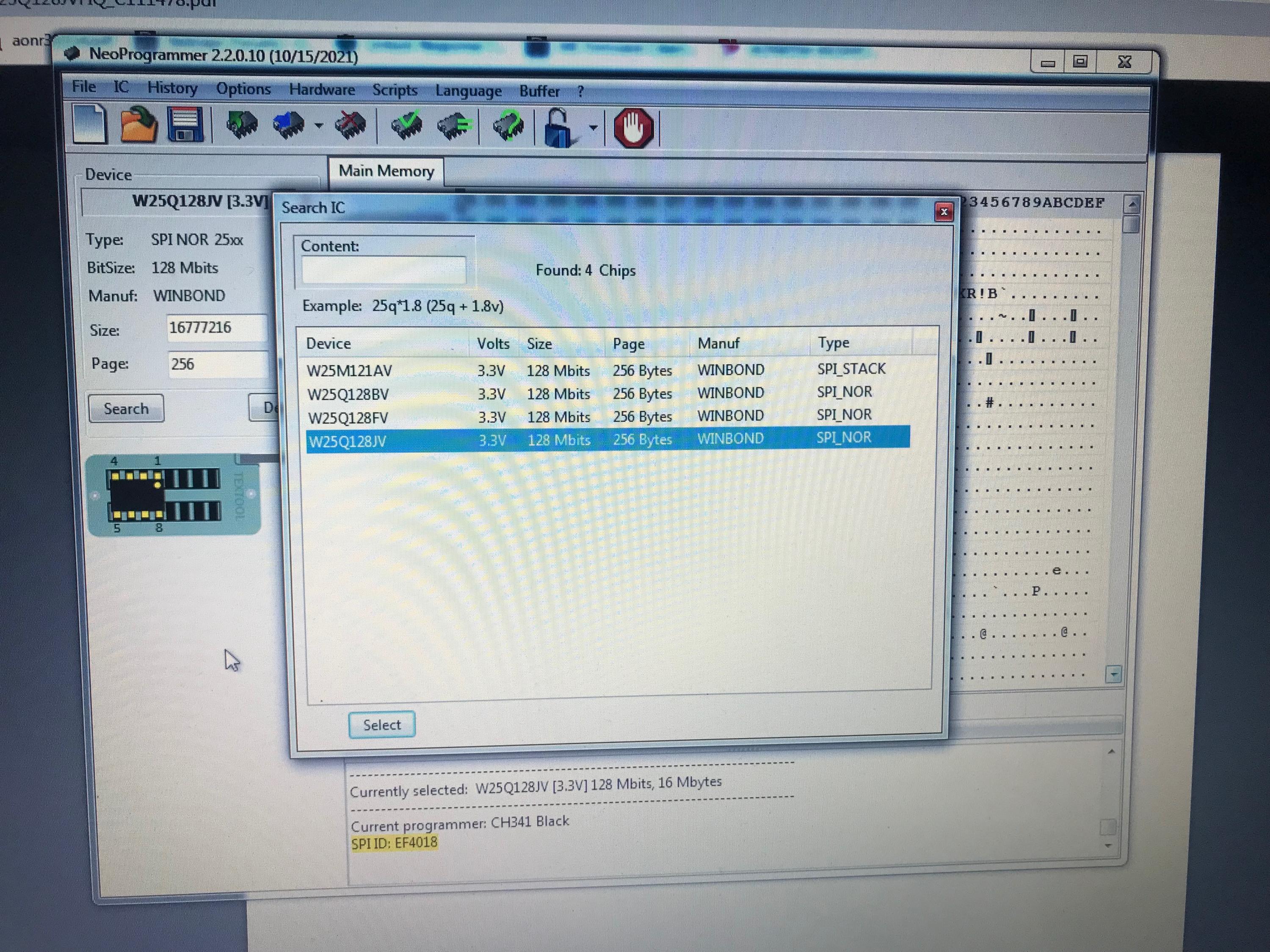

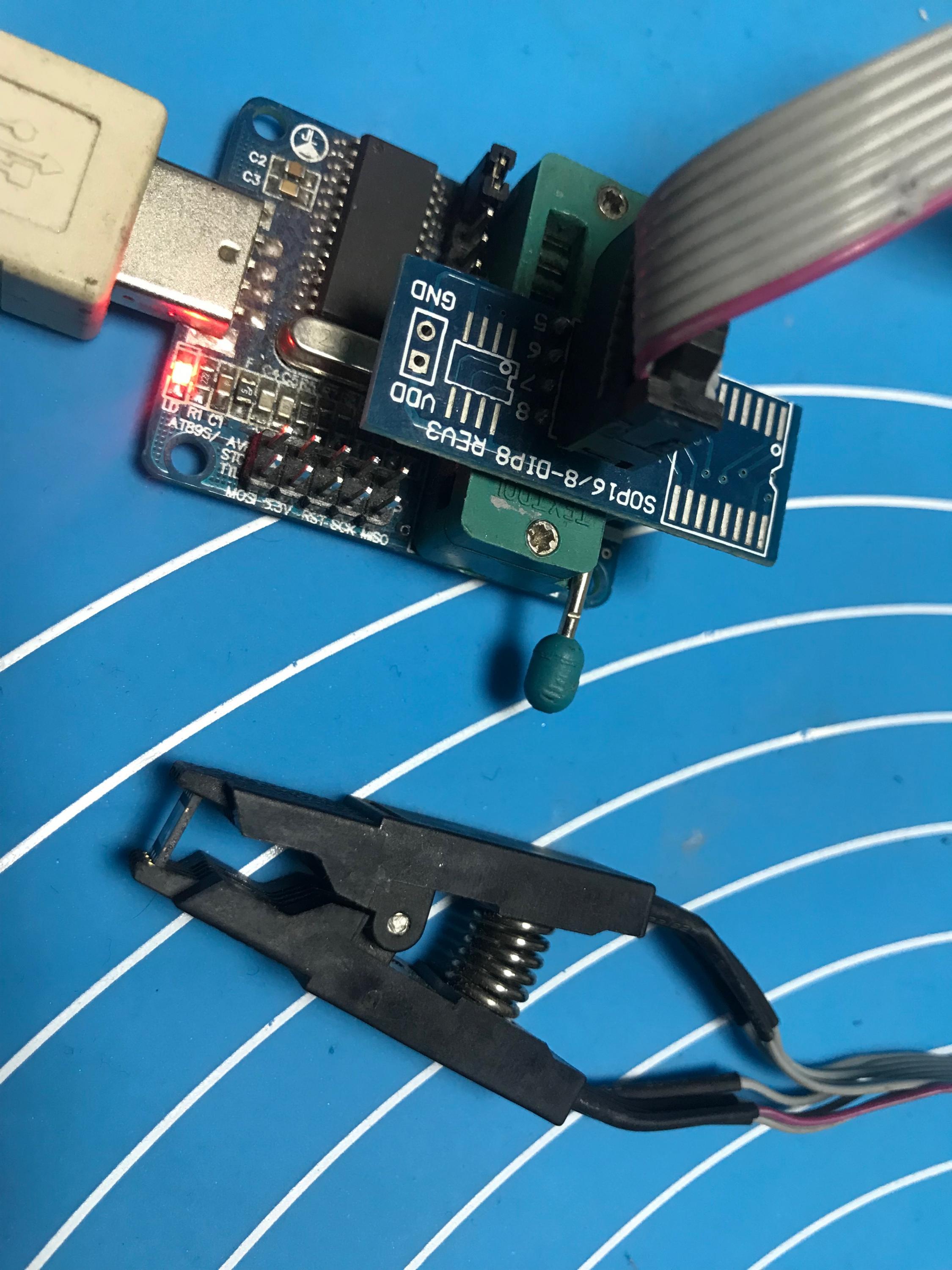

          Off topic: reading messages here i saw many had problems reading correctly WSON BIOS chipsets and I want to share my way. I desolder BIOS chipset from motherboard and put it into clamps as in image. I also have an adapter for WSON but I often got bad results - chipset not rcognized, bad reading. With the clamp I have no such problems.

            ...I also have an adapter for WSON but I often got bad results - chipset not rcognized, bad reading. With the clamp I have no such problems.
            Well, it depends on what type of adapter you are using for the purpose, I haven't had any problems with mine:
