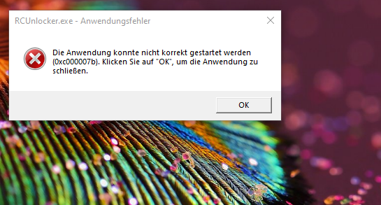

                            #393
                            Re: RCUnlocker
                            Hello, what a shame what am I doing wrong.
                            I always get this error message when I open the RCUnlocker in Windows 10 64bit.
                            Also by drag and drop. Maybe someone knows a solution.
                            Thanks in advance

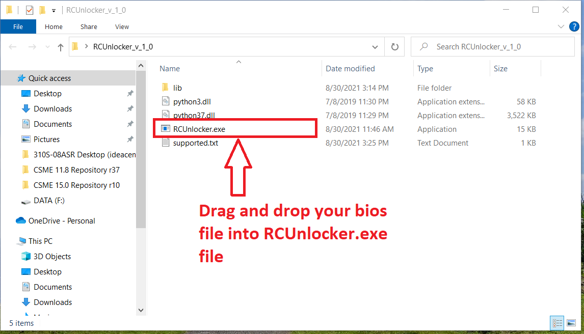

                            • peste
                              • Dec 2016
                              • 13834
                              • ROMANIA
                              #394
                              Re: RCUnlocker
                              Thanks in advance
                              do not open RCUnlocker ... drag the bios into RCUnlocker from the folder ..

                                  • Markus1741
                                    • Sep 2020
                                    • 972
                                    • N/A
                                    #397
                                    Re: RCUnlocker
                                    Sorry drag and drop same error message.
                                    • hpboy
                                      • Jan 2021
                                      • 53
                                      #398
                                      Re: RCUnlocker
                                      For anyone who is having trouble using this amazing utility from @RethoricalCheese here is a full video guide using the utility on a HP ProBook:
                                      Full Video - https://www.youtube.com/watch?v=QnlvlKuPMVk
                                      RCUnlocker Section of video - https://youtu.be/QnlvlKuPMVk?t=558
