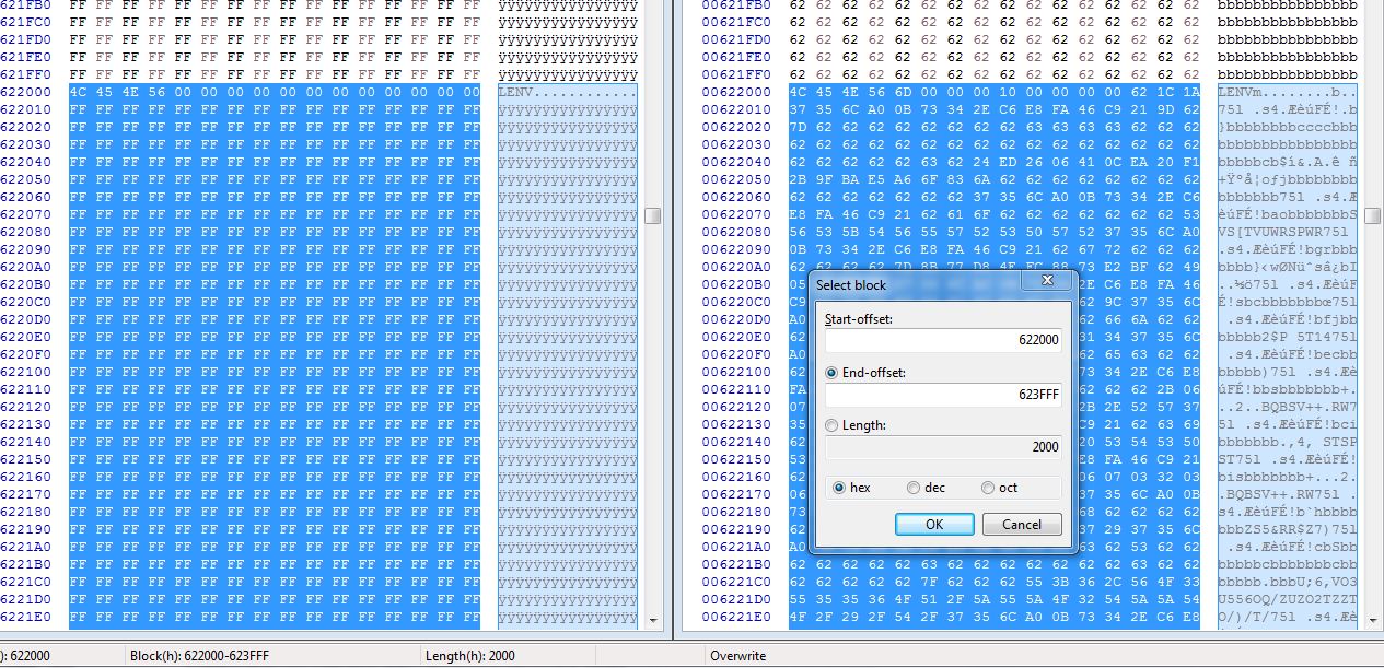

    Attached is a virgin bios extracted from the lenovo update. Open your backup bios and virgin bios with a hex editor. Copy your DMI from your backup using the off-sets in the picture and paste-insert into the virgin bios ,using the same off-sets and save it.
    HxD hex editor https://mh-nexus.de/en/hxd/

                          is ... you have it in item # 27, you just need to replace the DMI information in your updated bios,
                          DMI range 622000 - 623FFF

                                  you do not have the DMI information in this bios I have nothing to transfer to you ... try this..post#7...
                                  https://www.badcaps.net/forum/showthread.php?t=101209
                                  with the bios from post #27

                                      no ... you have to clean the ME region ... but if the bios from item # 27 that is extracted from the Lenovo site doesn't work you have another problem, or you don't write the bios correctly on the bios chip, or the bios chip with problems ..
