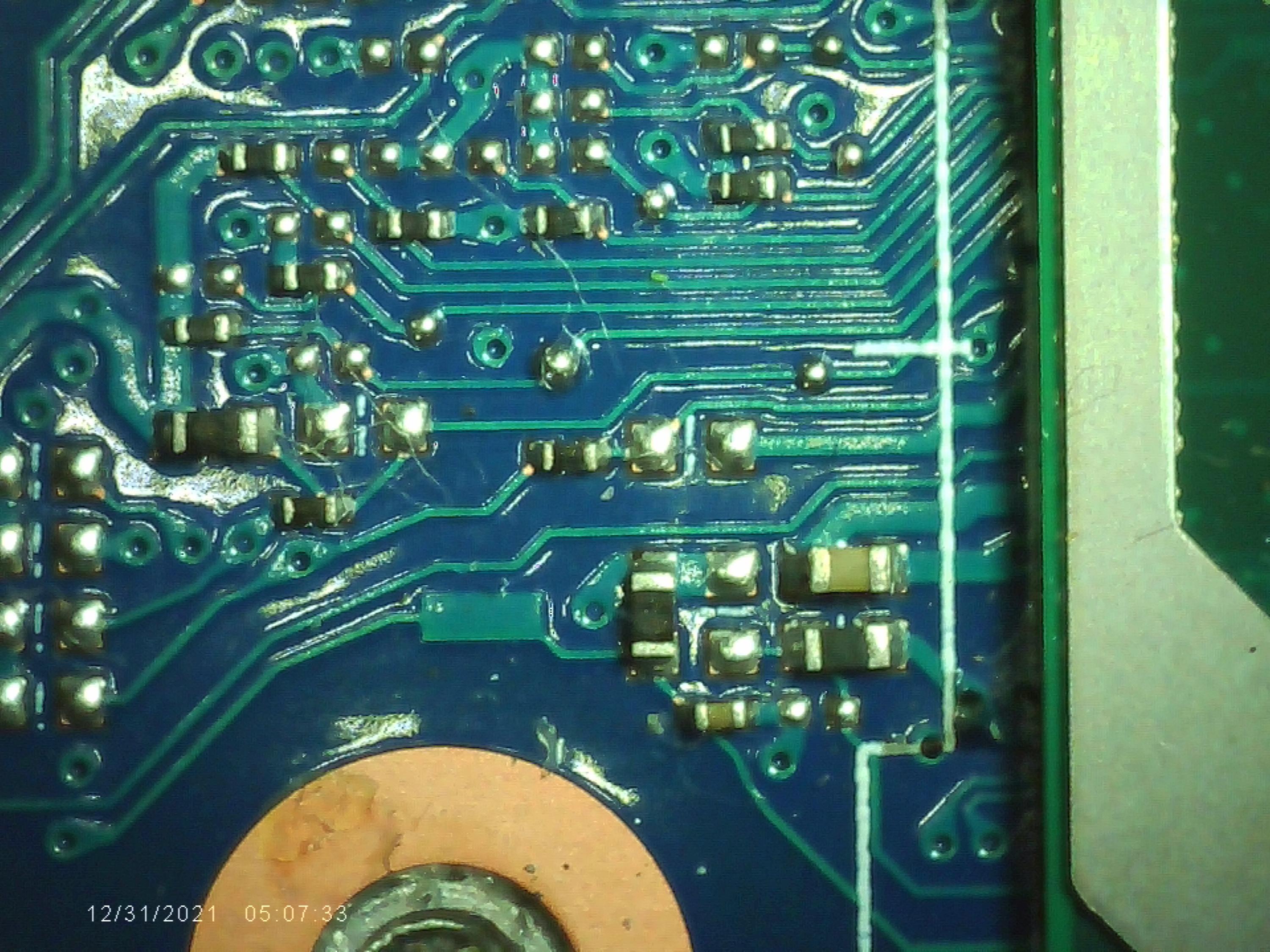

    i have ideapad 3 15iil05 board gs454/gs 554/gv 450/gv 550 nm-d031,
    someone can help me to disable onboard ram?
    is possible just swap resistor?
    here board pic
    thank in advance for any help

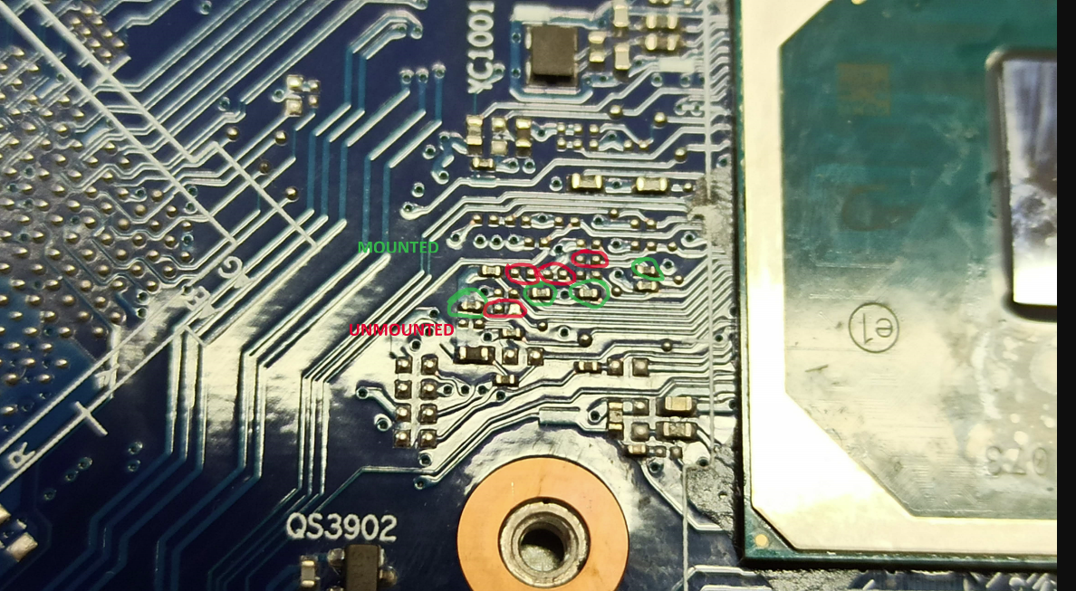

                                Quizás a alguien le sirva, puse el ID de la placa de 6-9 a 0100 y la memoria se apagó, no hace falta desoldarla, subo una foto, en rojo las posiciones donde hay que mover las resistencias a lugares verdes. A MI ME SIRVIO
                                Maybe it will help someone, I put the ID of the board from 6-9 to 0100 and the memory turned off, it is not necessary to desolder it, I upload a photo, in red the positions where you have to move the resistors to green places. IT SERVED ME

                                  id 6-9 0100 or 1000, ? in the picture i see 1000 or i'm wrong

                                    Can anybody help me to disable RAM?There is no resistors like at the picture above !!!although my motherboard looks the same.

                                      It worked for me! Thank you so much.

                                        You got exactly the same motherboard version as mine, just move the resistor RC825 to the RC827 place, and remove RC840.
