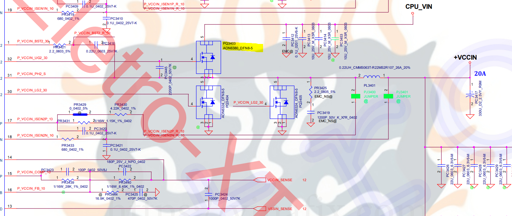

    first issue short in main power rail fixed by replacing a mosfet
    new issue
    unit turns on after 5 seconds it turns off (when battery is plugged)
    unit turns on then off immediately(when batt is unplugged and using charger only)
    main power rails are present 20v , 3.3v is present 5v is present 1.8v is present when unit is turned on 1.8v shows then disappear when unit shuts itself down
    also i noticed that cpu is getting hot then turns off do you have any suggestion what to look next

    You need to share the full history first. Which mosfet did you replace before? If it was related to a power supply for the CPU there is nothing to wonder about the behaviour. A dead CPU is a common outcome after a high-side short.

      heres the mosfet that i replace pq3403 yep iguess it was a dead cpu unfortunate

        how can i identify if its a highside and lowside mosfet

          Yes its a high side mosfet as it receives VIN(19V) on drain pins(pin5-8) and cpu is killed as 19V has gone to cpu. So end of story unless you intend to replace the cpu.

            yes its a goner replacing cpu's is not practical in my situation
