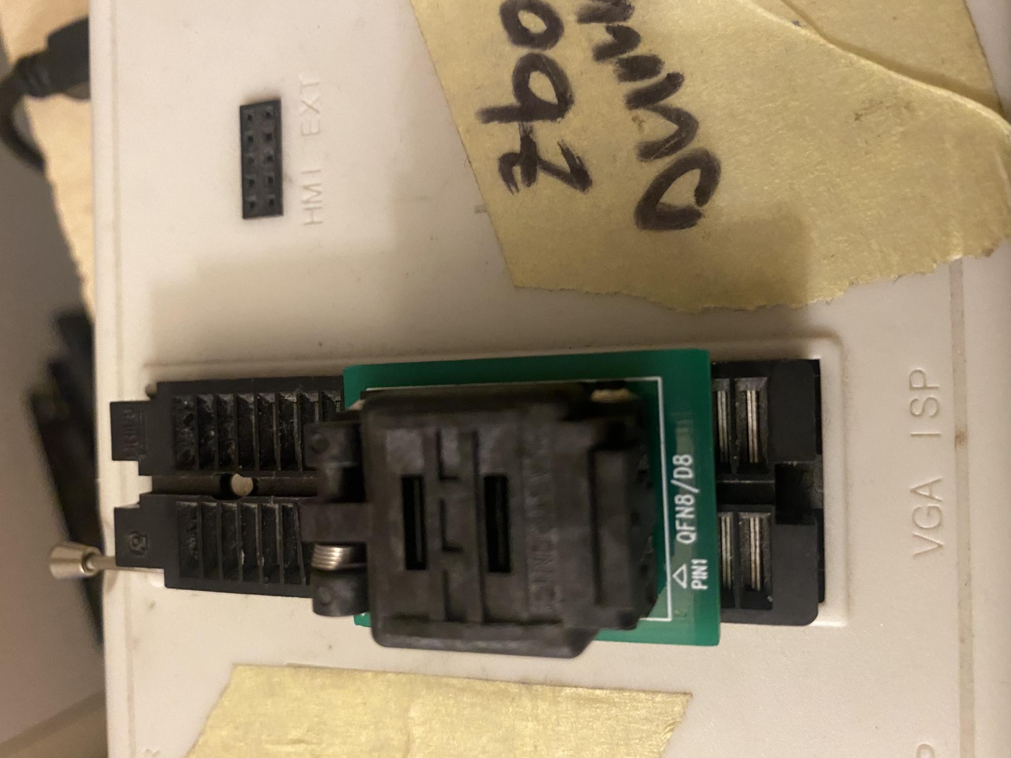

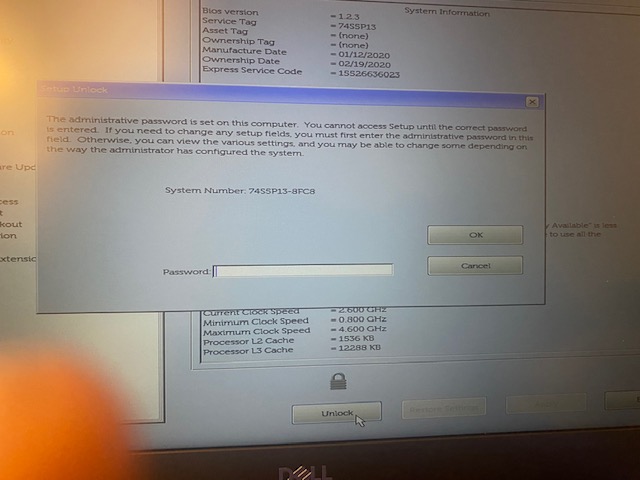

    hello all
    originaly this laptop eda50 la-h271p / Precision 7540 it had bios password, i tried to unlock it, so i install file back on and some bios give me fan spin, but not working so i decided to install back original file which i am including here but this is not working any longer, laptop doesn't start anymore, i was wondering if anybody can help,original file included here

    Re: eda50 la-h271p bios help please
    So the game over in tears and regrets huh?
    (SMDFlea was absolutely right, guide for dumping a bios file should be written.)
    So try it, I hope it will be fine, if not there is another solution too.
    And use verification after programming the chip, also read chip again and compare the content.

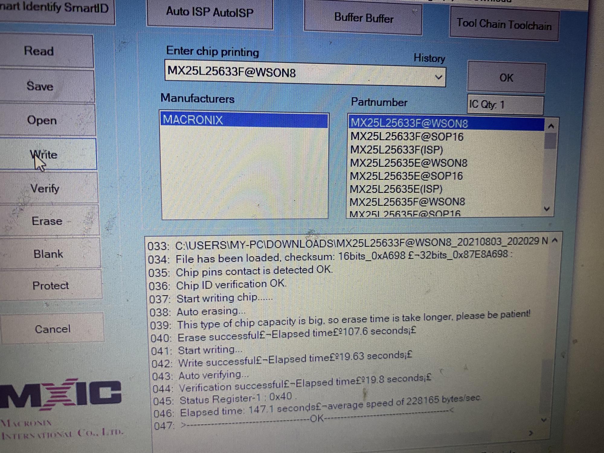

      hi Vesko356 yes in this case i regret taking it on as this seems new generation laptop and not worth it for me, now broken laptop and no solution, i tried this bios and same issue, 1 light, 2 lights and nothing no fan spin or nothing cpu not getting hot

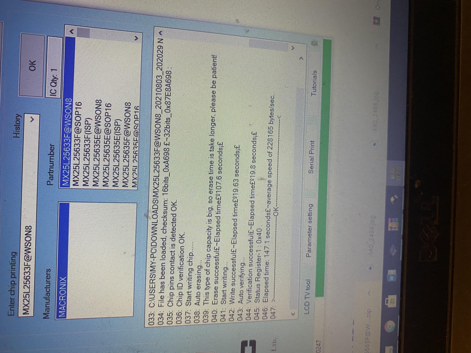

        Strange, it should work with this file. Did you verify the content of the chip? Did you solder/desolder the chip correctly (also check voltage at pin #8)? Take high resolution photos (and upload them here) of the bios chip area. You may have unnoticed damaged some small component from the surrounding area.

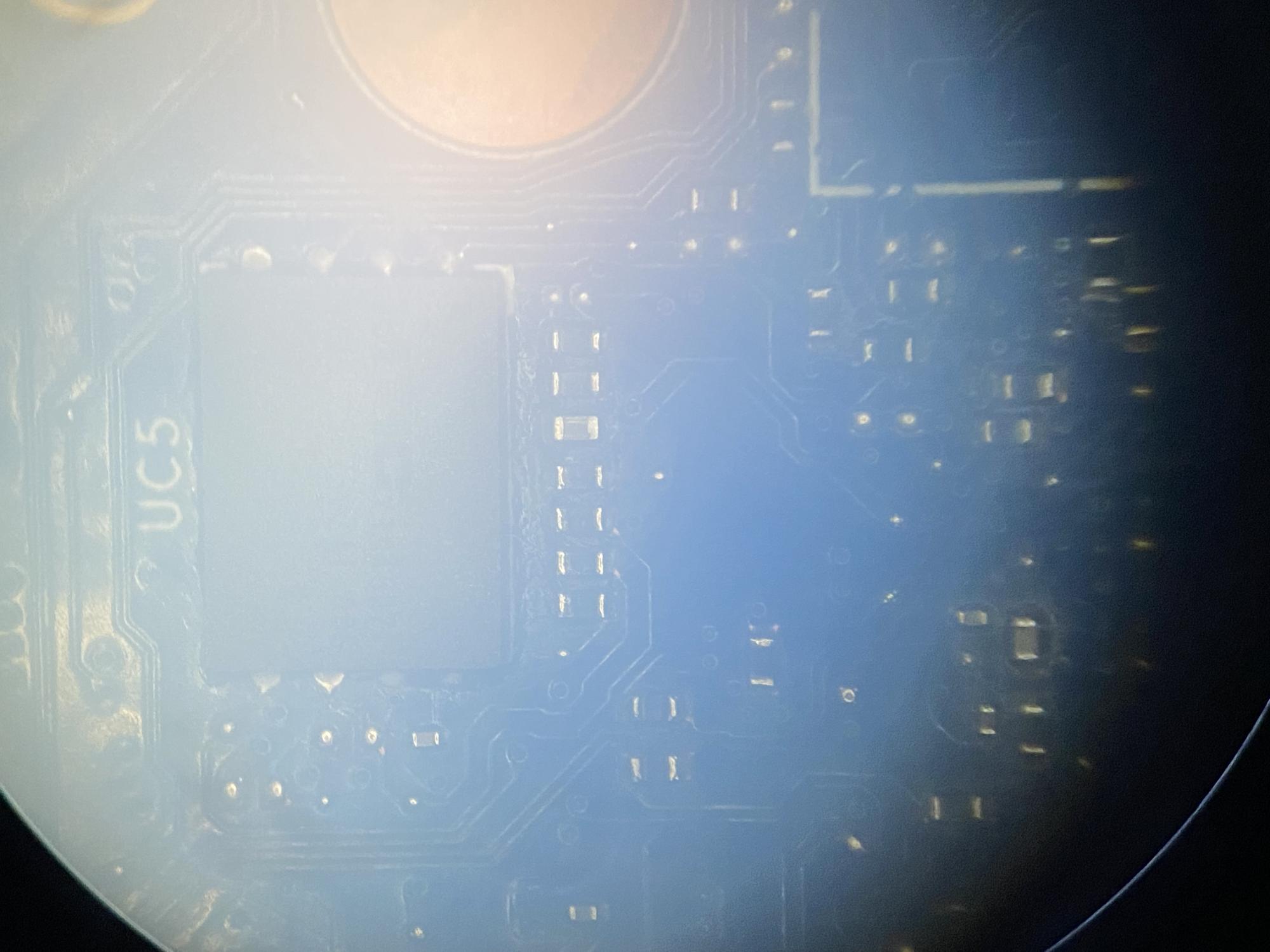

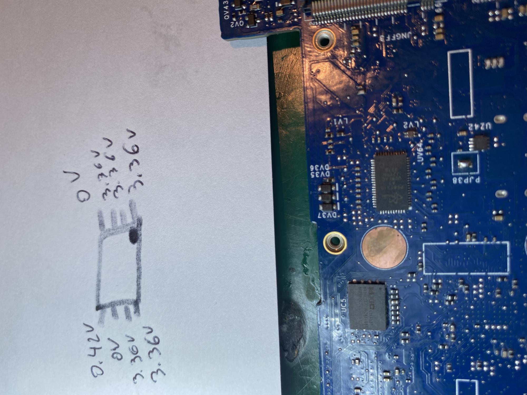

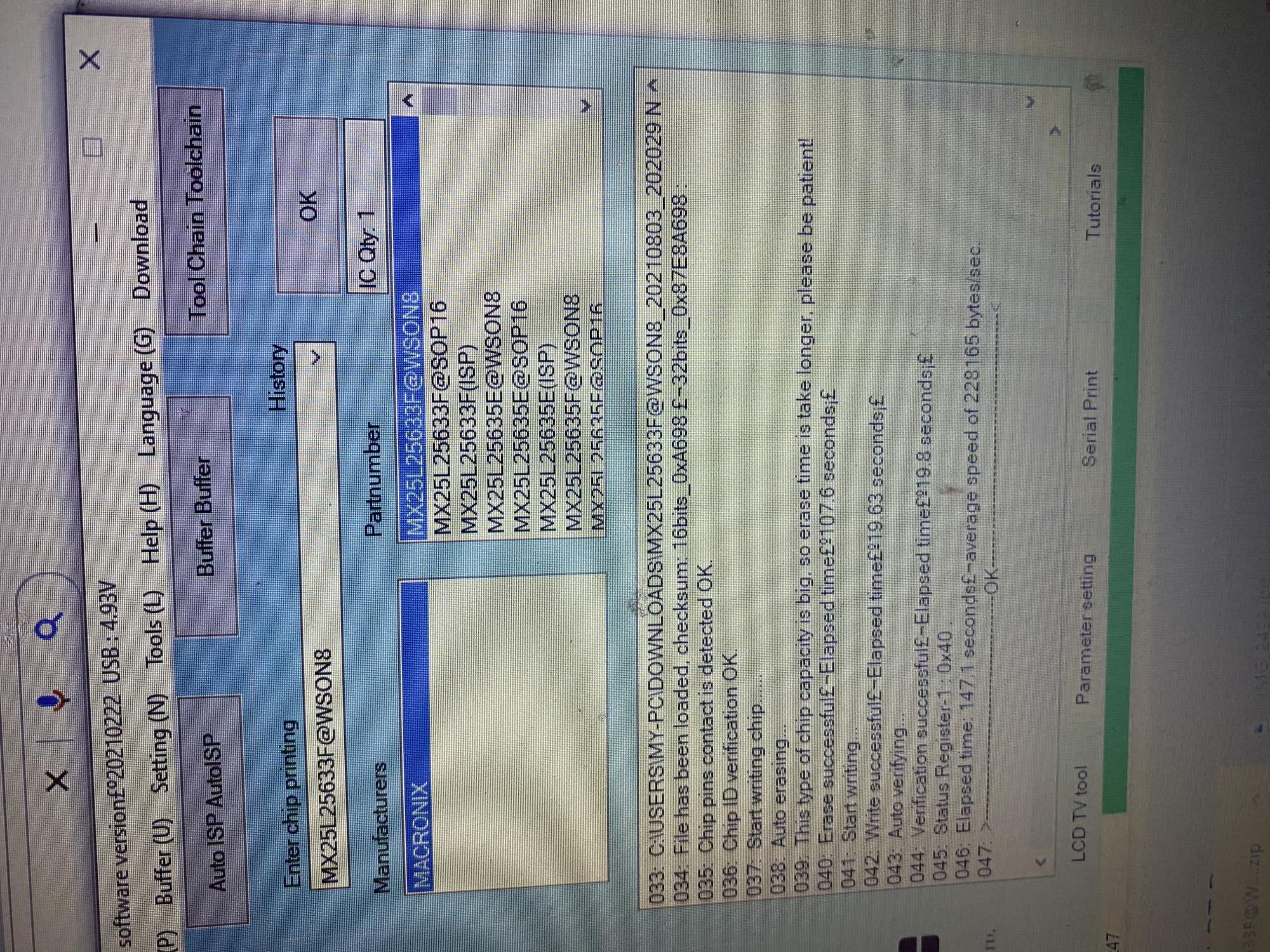

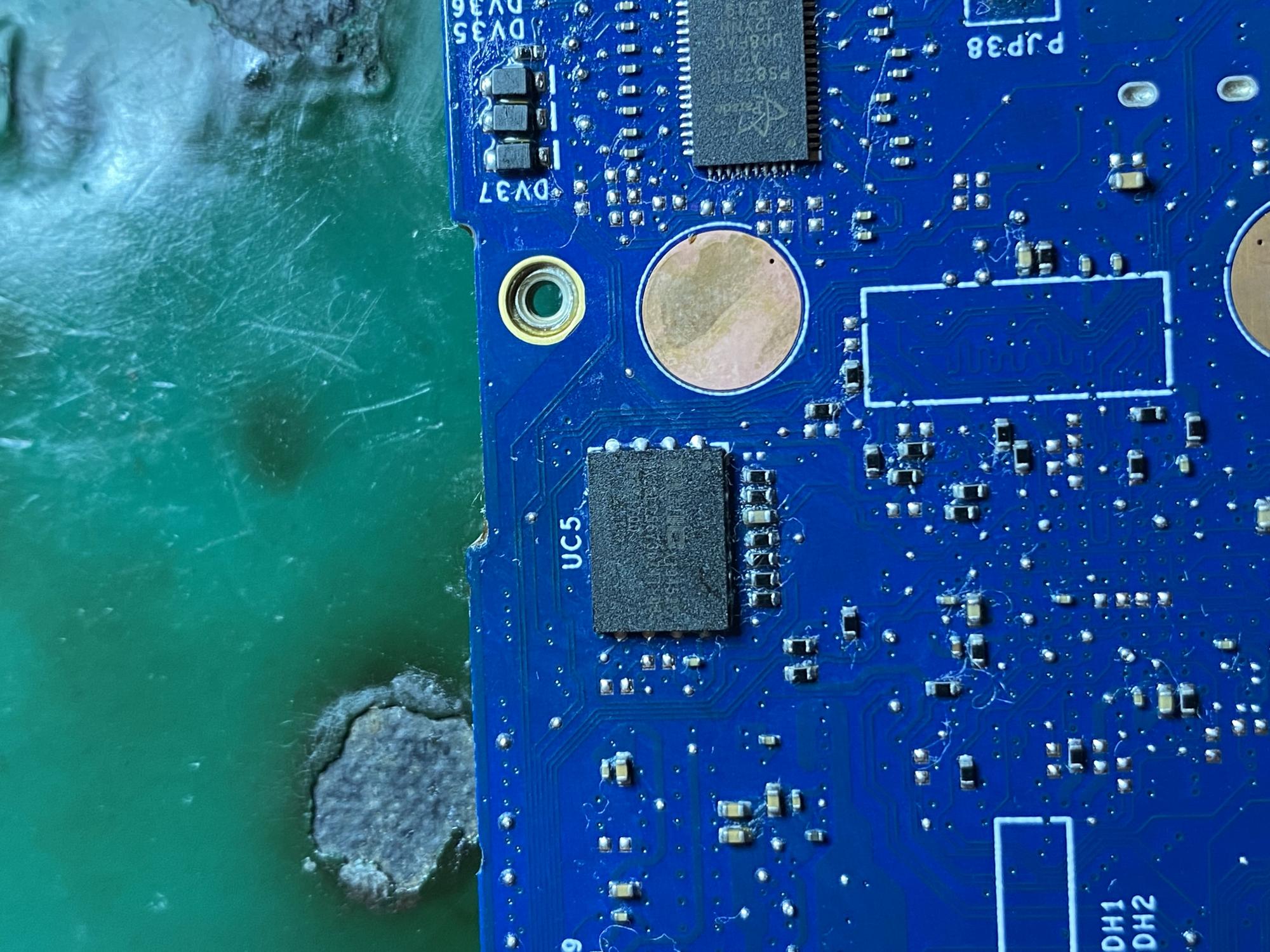

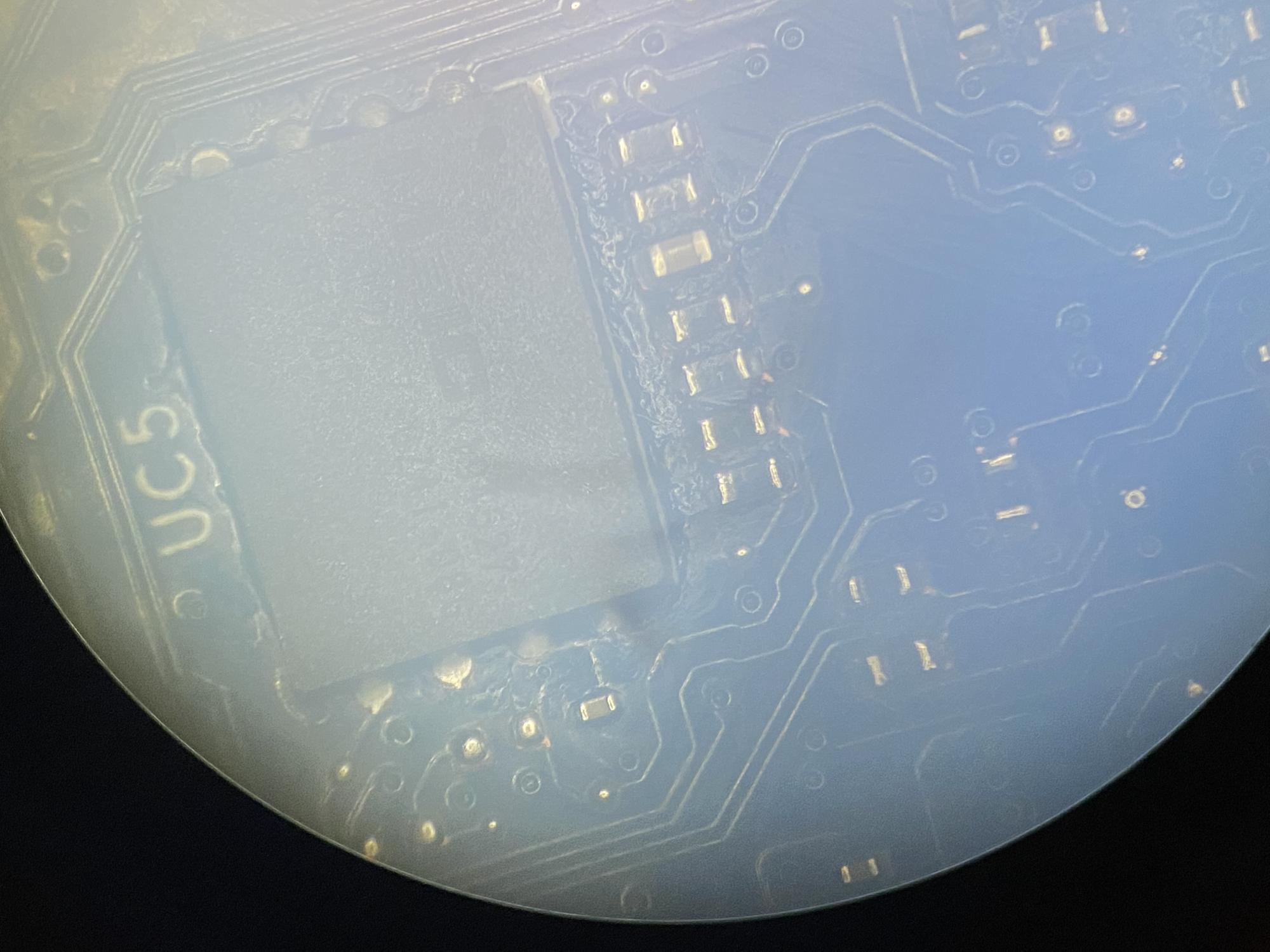

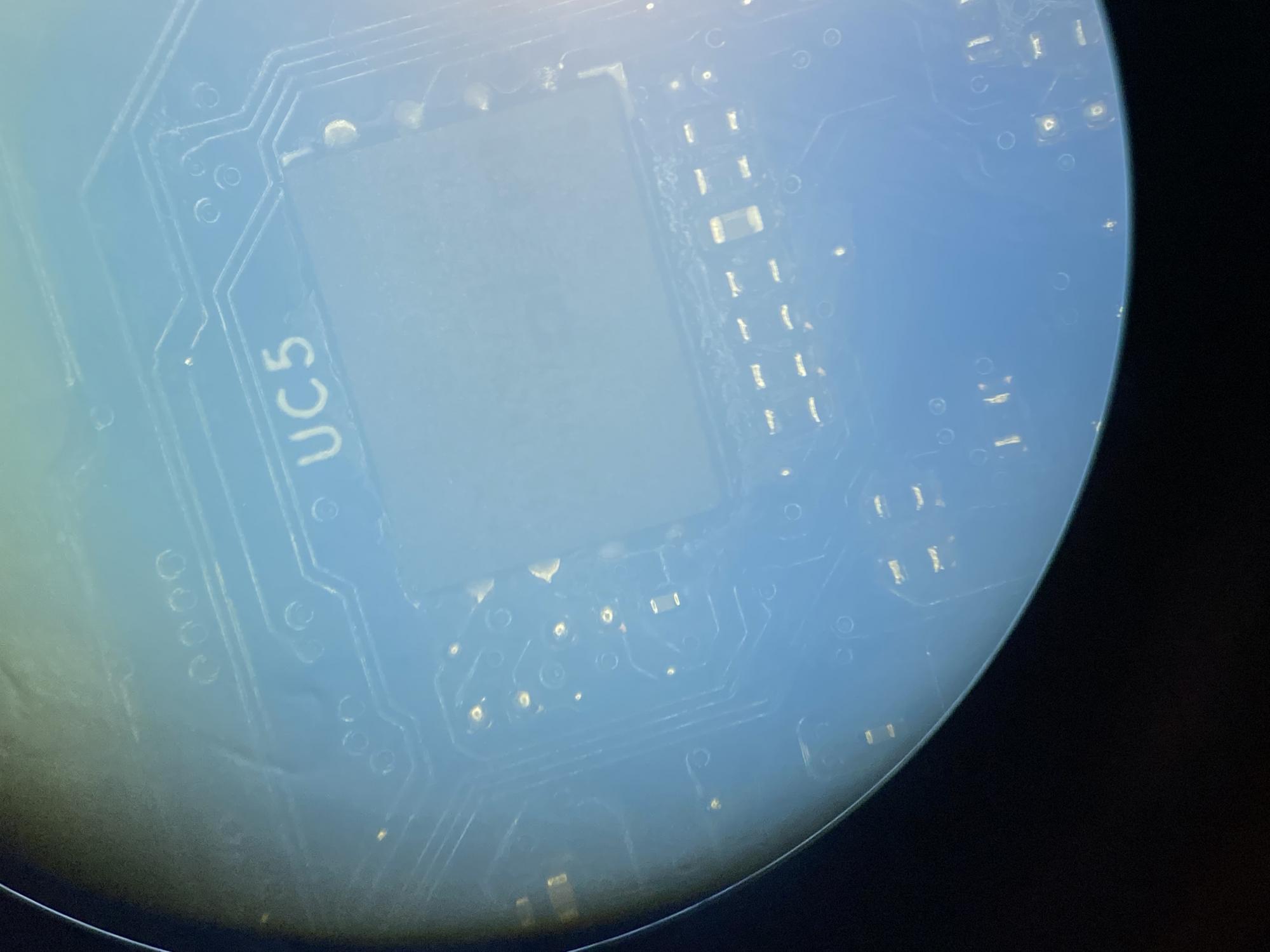

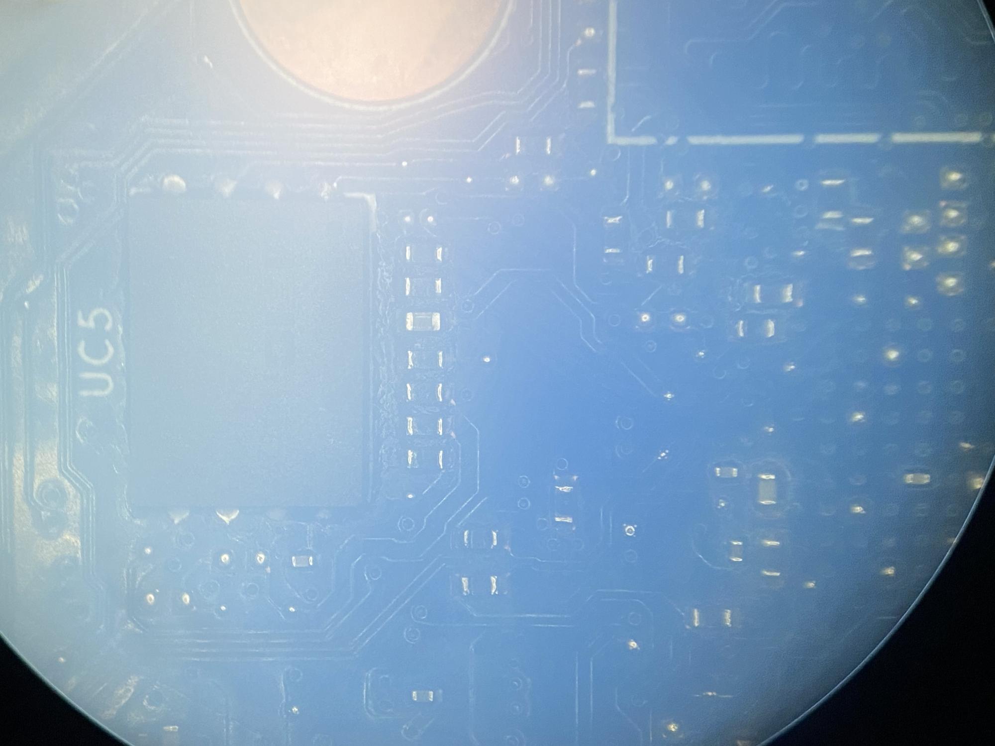

          Hello Vesko356 I have taken some pictures and some measurements also on the pictures, I get 3.36v on some points but on some there is 0.42v and opposite 0v please kindly see pictures, when I tried to unlock this bios I use lbe paid membership, I ticked reset nvram and reset pram during the compilation of new bios, as far as I know I have not knocked any components as I use microscope
            OK, lets try the recovery method, format some usb flash drive in fat32 filesystem, unzip the attached archive, and copy the recovery file to the root of the flash drive. Insert the flash drive into a USB port, remove the battery, press and hold the CTRL and ESC keys on the keyboard (laptop keyboard don't use usb keyboard), and insert the power jack into the laptop, keep pressed the CTRL and ESC keys until the BIOS recovery page appears.
                    Reading the chip is a simple job with the appropriate tools, with the patience and using a common sense - read the data from the chip twice and save it to a file each time.
                    Verify the checksum of both files.
                    This is to make sure that there is no corruption when reading data from the chip. Did you do that? Of course no!
                    And this leads to a situation in which none of us is sure that the backup is good. And probably it isn't. Because if it was good, the laptop would have to power on again.
                    Almost the same story as this one.
                    Five minutes of extra work to secure yourself from troubles. Simple as that.

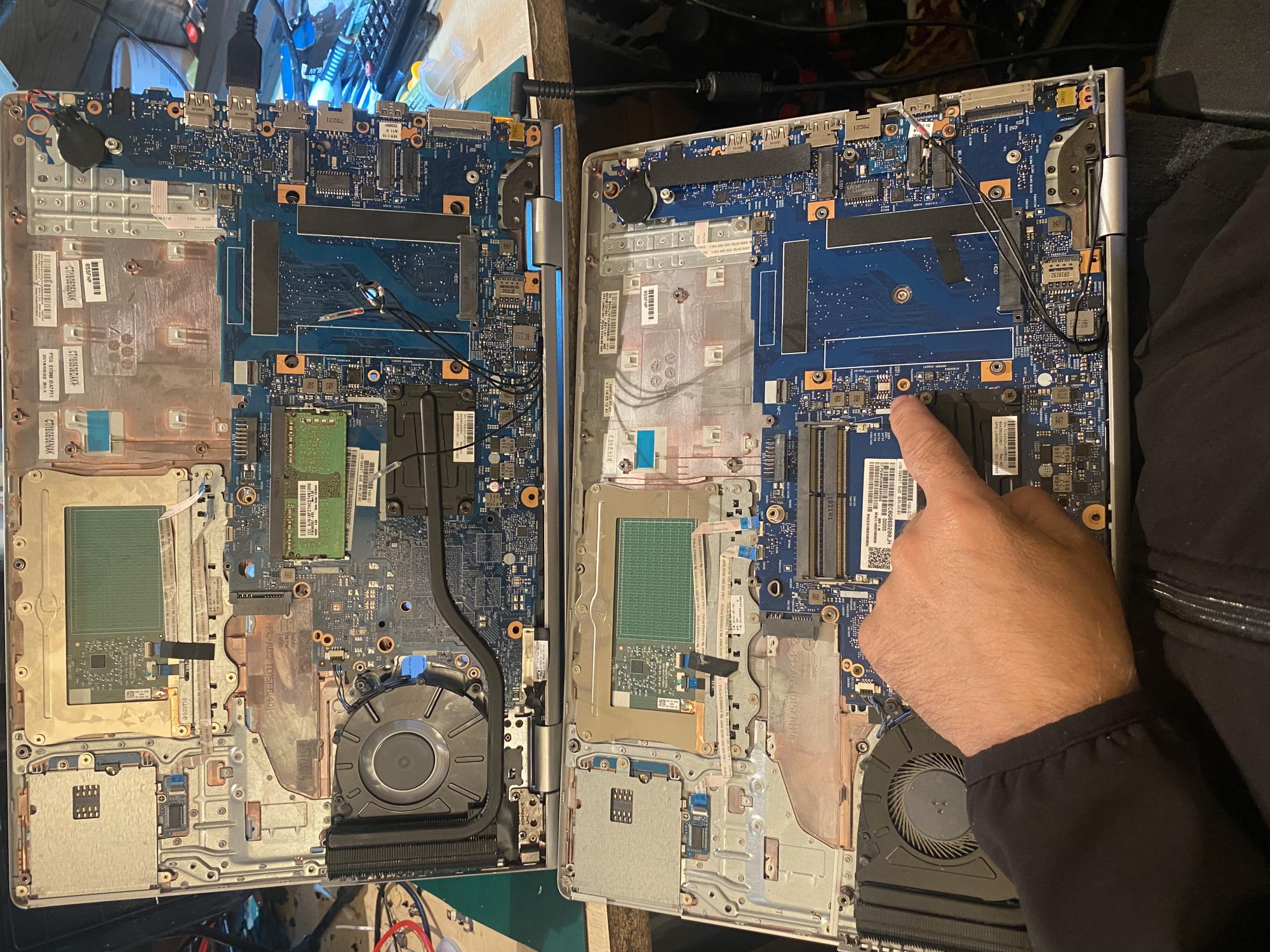

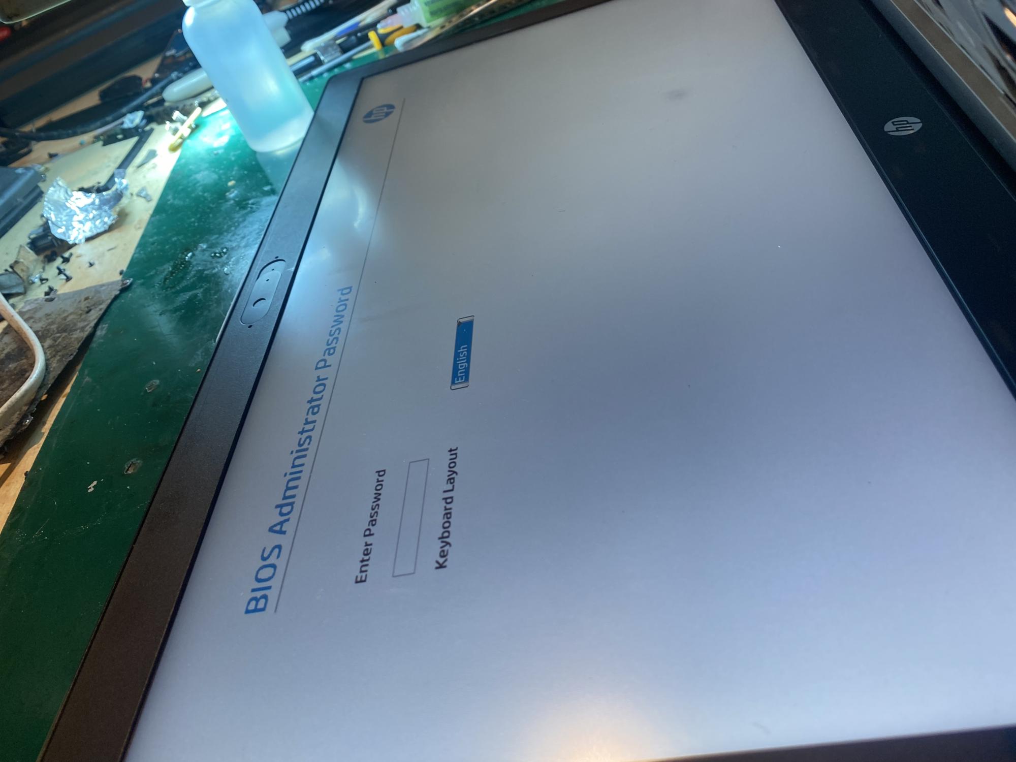

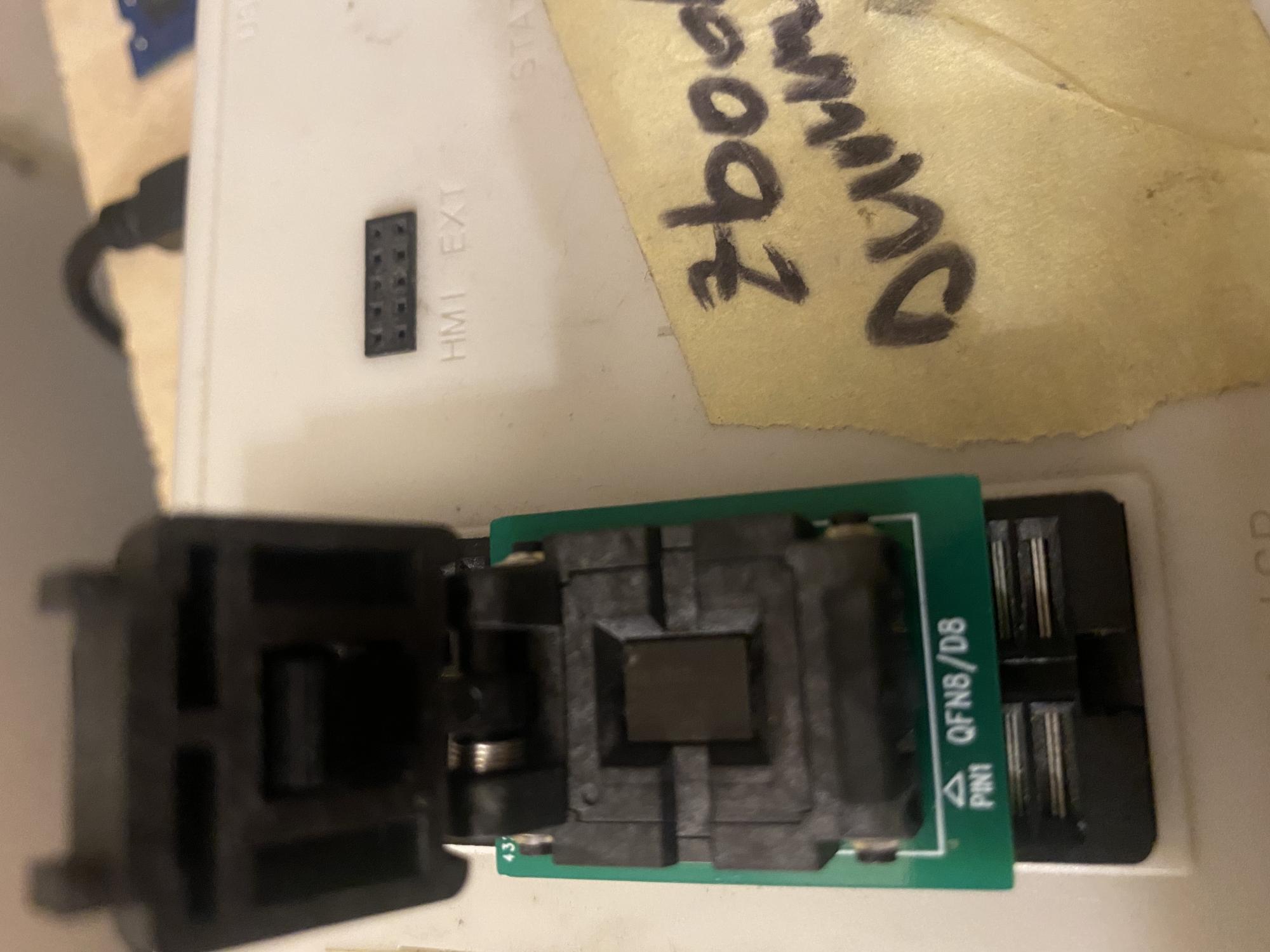

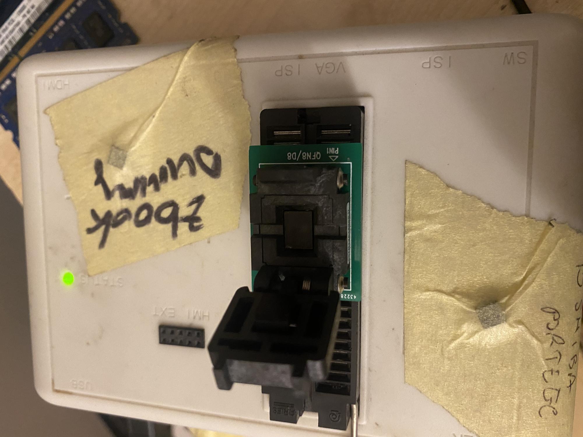

                      So I have a hp 830 g5, which also has this big chip and I am not comfortable to sell this laptop, so I decided to create bios password and test again the procedures, with other chips I always try to find the name on the list which is printed on the chip for example I would find mxl12875f rather then on right side click on the first one on the list, so with this 830 g5 I decided to scroll down to find the closest name like printed to the chip rather then choosing the first one, so this laptop works this way, but choosing what I have highlighted on the picture broke 2 laptops, I am going to choose on the hp 650 g4 which had bios password I will choose a different file rather then the one on the picture

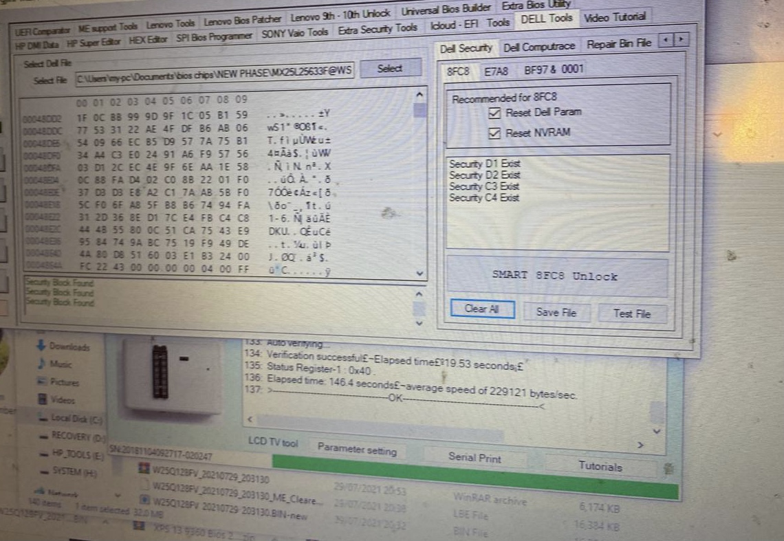

                      So far choosing what is ok the rt809h first file on the list broke, hp 650 g4, dell precision 7480, dell xps 13 9360, those all have big chips, hp 830 g5 working after choosing the file which is closest printed on the chip

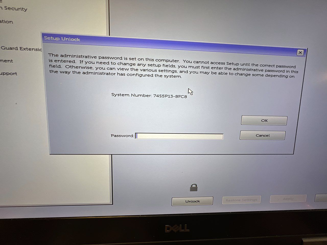

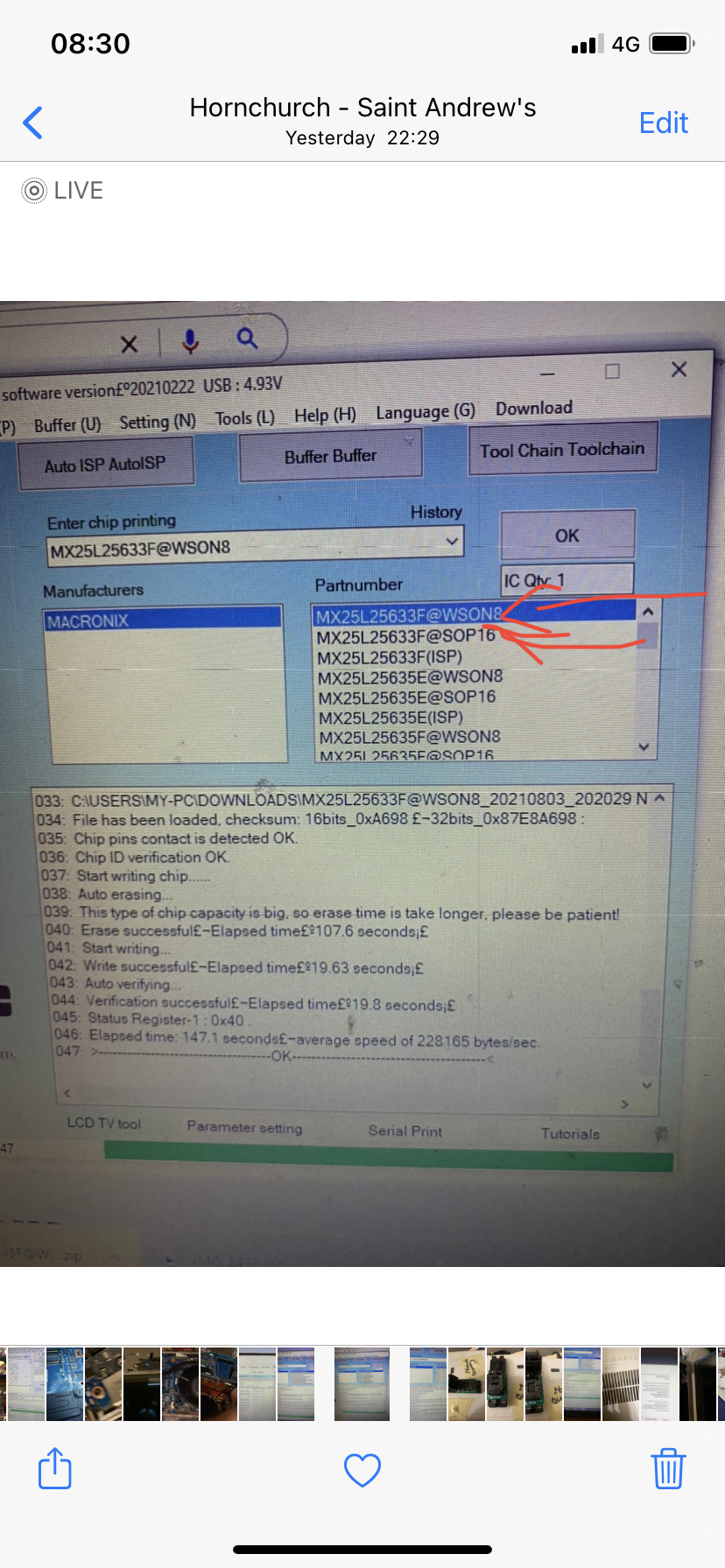

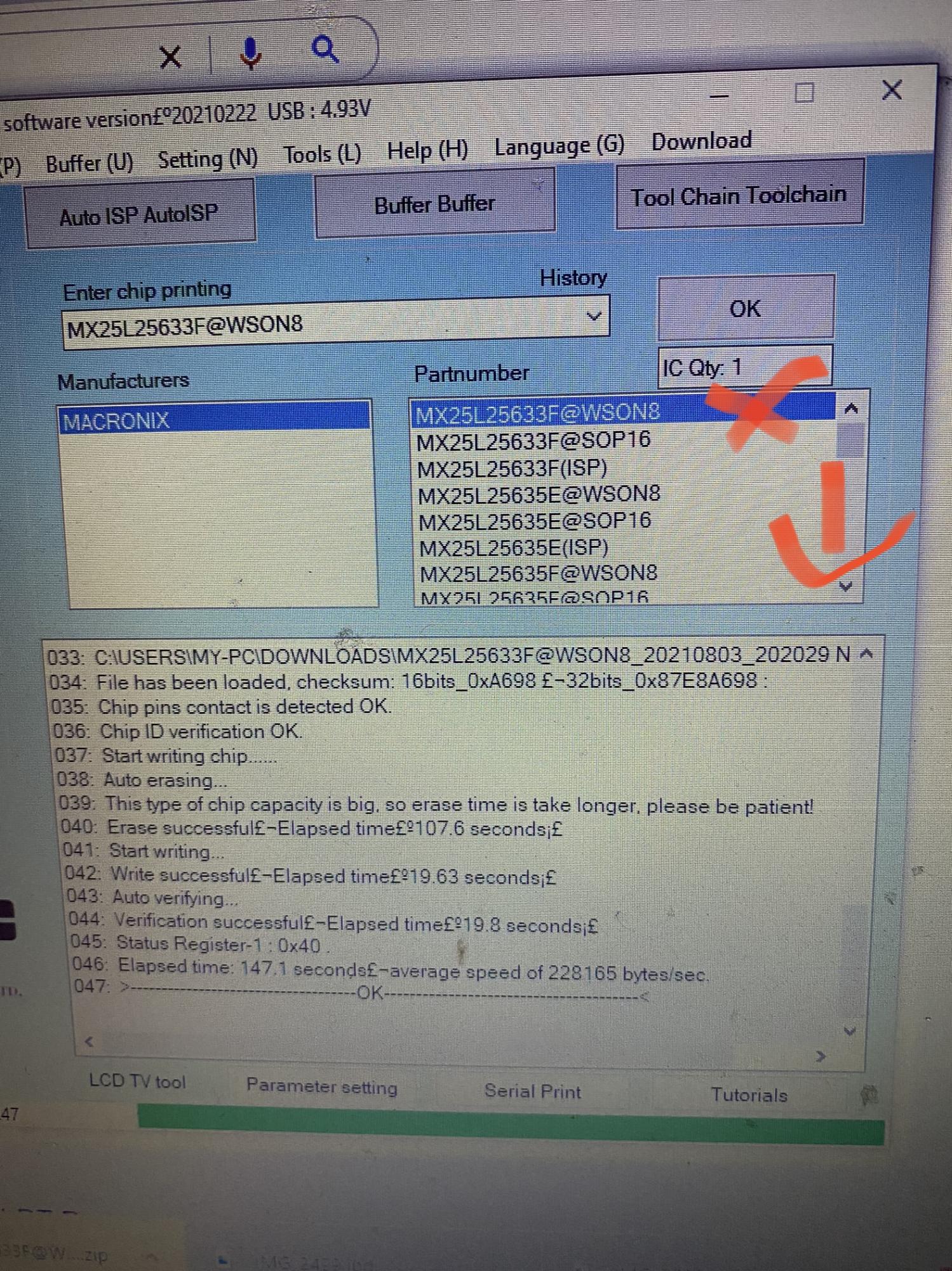

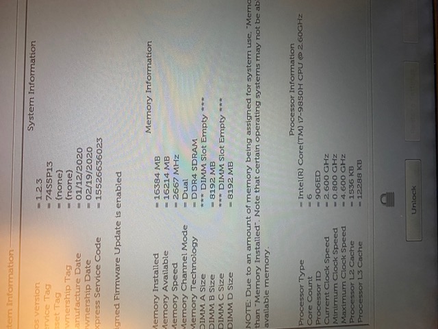

                        I don't want to flood this post but just an update, so by choosing the first file on rt809h broke 3 laptops of mine, one of them was a 650 g4, I have 2 of those, so I decided to remove chip from the other one and put on this one and now laptop works, I have tried to put the original file where I took it from and i had same issue, so somehow I have to replace the chips on those other laptops
                        • Anchar777

                              hi all, EDA50 LA-H271P Rev.1 bios need for my locked file pls
                              • rex98
                                • Feb 2023
                                • 1293
                                • Mandaue CEBU, Philippines
                                https://www.badcaps.net/forum/troubl...before-posting
                                You MUST:
                                • viji90
                                  • Jul 2017
                                  • 22
                                  • india
                                  Service Tag do not know sticker got erased
                                  • rex98
                                    • Feb 2023
                                    • 1293
                                    service tag: CV15H53
                                    1st boot, press F2, write service tag, disable Absolute, save (Apply changes), restart. 2nd boot press Alt+F to exit manufacturing mode
