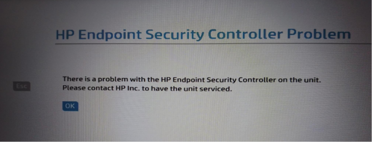

    have a Notebook with error attached,
    would try to change bios, probably corrupted,
    have any suggest?

    enter the bios and restore the security settings to the default values and restart the laptop.

      As soon as he takes me the notebook I will do all the resets, but he says he already did these resets, the notebook is not yet here with me, but if with the reset of security he didn't solve, I think the bios is corrupt.

        have make all reset, but the problem is not resoved,
        the notebook give all time the indicated error.

          post both 32MB and 16MB bios and the full name and model of the laptop.

            i'm trying to copy the bios to you, but i can't do it, I found these two memory
            MX25L25673G
            25Q80DVIG
            ARE THESE?

              find memories!! Attached,

                GUY Nothing,I have changed the chips with others of a working card, but the error remains, it is not a bios problem.
                -UPDATE, i've roll back the bios on working mainboard, and now that also gives me the security error ... now i have two cards with the same error, can you help me?
