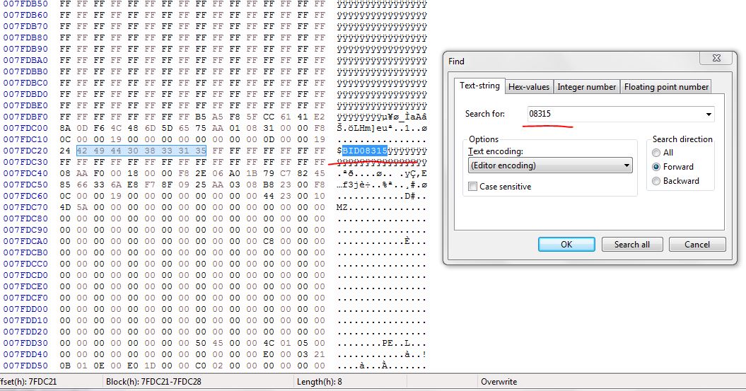

    i want this file to be repair.(warriors_amddis_mb_ddr3 16883-1}
    model=15-br068cl
    SN#=8CG7443N75
    I have attached the old dump
    • 20574
    Re: warriors_amddis_mb_ddr3 16883-1 bios repair

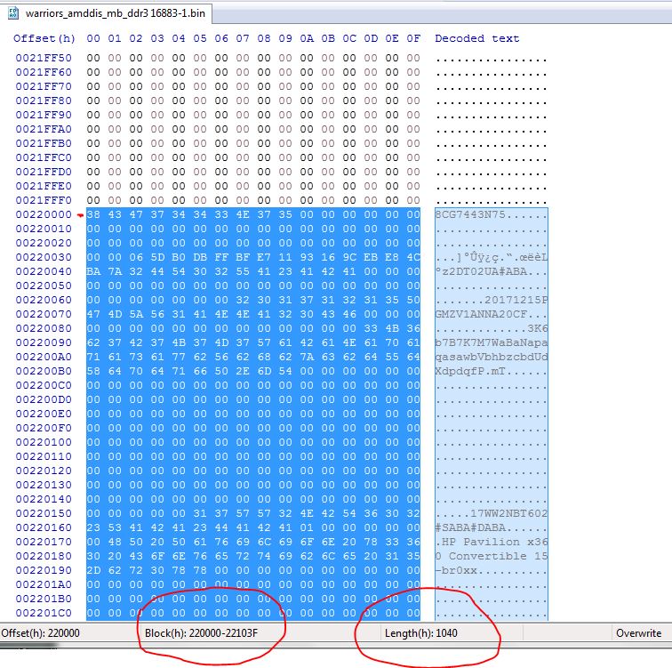

    Download and run the bios update exe ,select the copy option.There are 2 different bios versions.Search through your bios backup using a hex editor looking for both bios numbers, see the attached picture your bios is 08315. Next, use the hex editors search function to look for the serial number in your bios backup. See the attached picture for the DMI area , copy that to the new bios .

      Thank you . but please how can i replace the dmi area i have copied to the new 08315 bin
        (copy - paste) ... from the original bios, in update.
