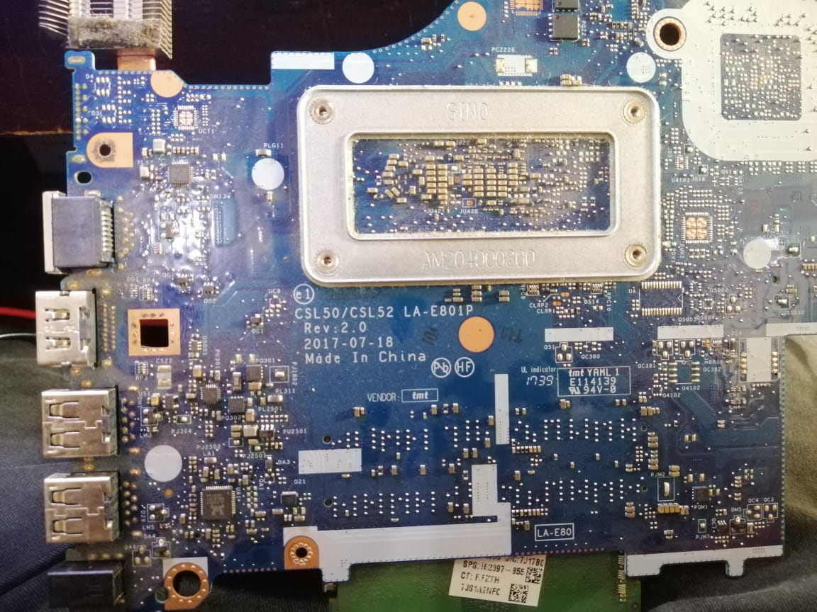

              HP 15-BS588TU CSL50-CSL52 LA-E801P Rev:2.0 Bios
              Please I need HP 15-BS588TU bios
              MB : CSL50-CSL52 LA-E801P
              Rev:2.0

                Re: HP 15-BS588TU CSL50-CSL52 LA-E801P Rev:2.0 Bios
                Rev:2.0
                2017-07-18
                post the bios backup.
                  backup here

                    #29
                    backup here
                    iit's empty ... try again
                      Again I read that IC.
                      But same result.
                        But same result.
                        Are you using a CH341A programmer
                          yes
                            yes
                            Try it with this alternative software. Make 2 backups and check if both dumps are the same,that way you know if you got a good read, use a hex editors File compare option, or some other method.If you`re using a sop8 clip then attach the charger to the board before making a backup.
                            https://www.badcaps.net/forum/showpo...04&postcount=7 NeoProgrammer
                            https://www.badcaps.net/forum/showpo...6&postcount=10 AsProgrammer
                                any way to get bios.bin file from bios.exe file
                                  https://support.hp.com/lt-en/drivers...A&ssfFlag=true
                                  You can run the exe and make a USB recovery key (try it first) ,or copy and save the bios. The update is for more than one laptop model and it has 5 different ones. To know which one to use you should check your bios backup for the right BID bios ID / number .If the USB recovery key doesn`t work then post your bios backup. Your DMI info (serial number,feature byte,windows key) can be copied from your bios backup to the new bios easily using a hex editor.
                                    USB recovery key not success. now problem is chip damage while I am trying.
                                    before it can read and after save read copy, nothing in saved file.
                                    please may I know to,way for get Bios file without old backup.
                                      Try... one of them it's for your laptop
                                        08328.bin is working for my board.
                                        No power on with all other files.
                                        but display not working.
