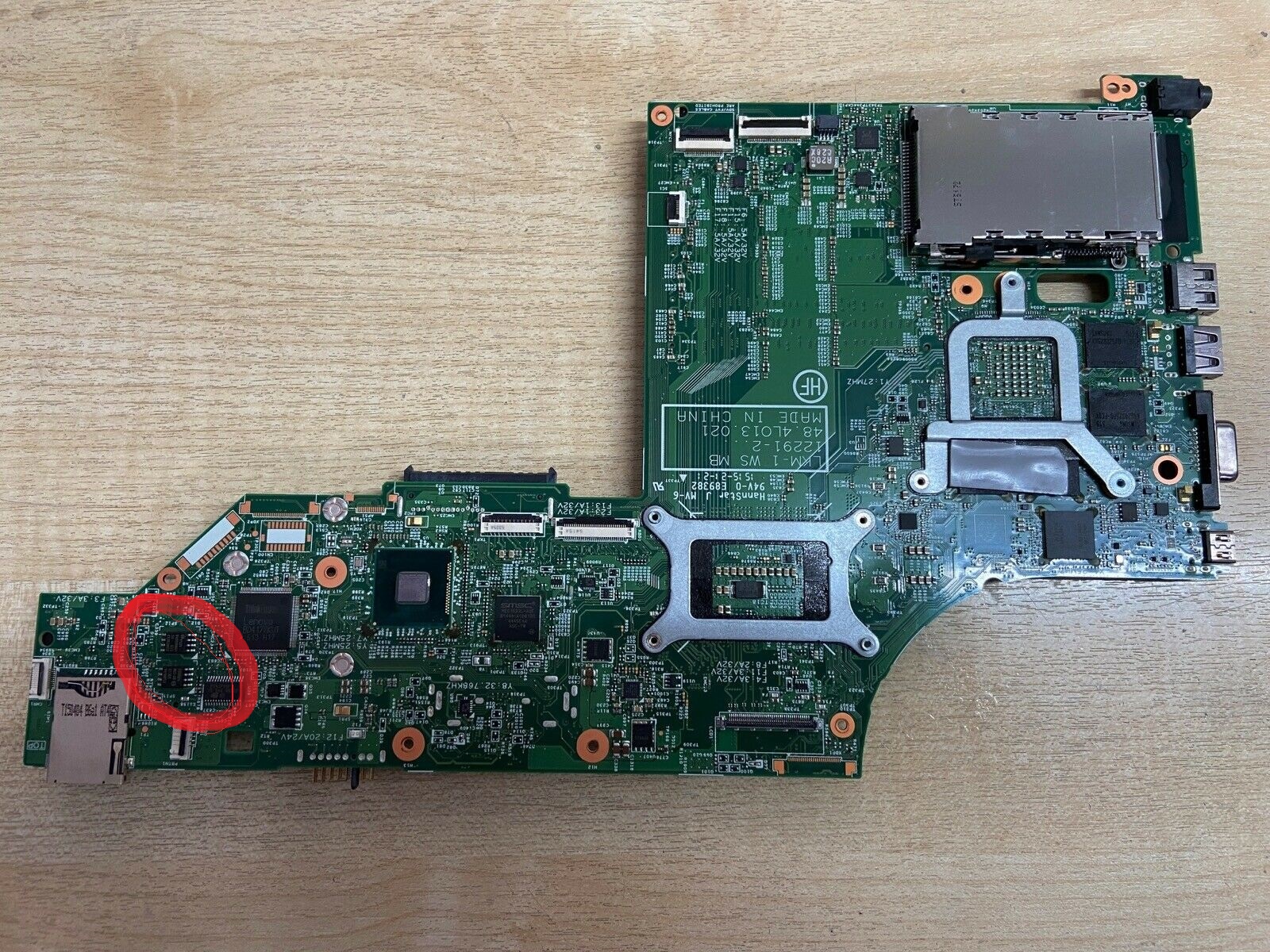

    Just bought a used Lenovo W541 and it has the supervisor password set. I know I need to copy the BIOS chips. But for the life of me, I can not find the 8-pin chips on the motherboard anywhere.
    Supposidly there is a 4MB and an 8MB chip. I've looked this board back to front and even sideways if that would help.
    Does anyone have the chip part number or the silkscreen U number that I should look for on the PCB. Even a photo would be greatly appreciated of where these two chips are located.

    Re: Lenovo W541 BIOS Chips
    SPI1 and SPI2 maybe
        Here is the Location
          Found them.
          The description and the picture were a great help.
          Just didn't realize I had to disassemble the entire board from the magnesium alloy tray. My little piece of cardboard to track the screws now has 31 screws in it.
