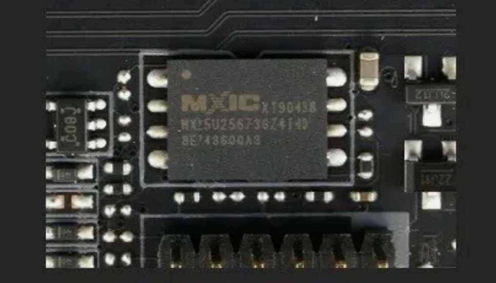

    Hello guys. Is there an adaptor to read out the flat bios chips like in the Foto? Thank you very much.

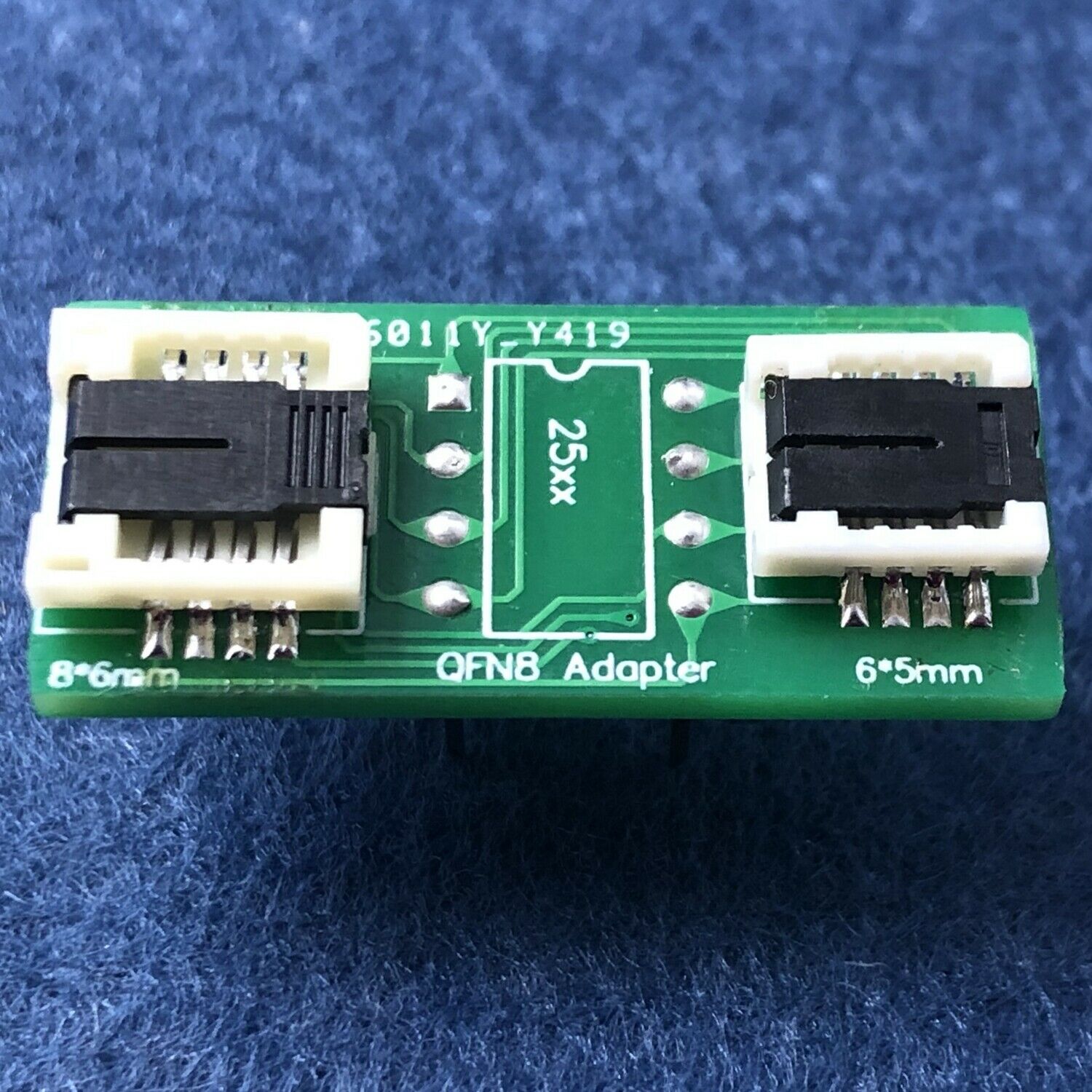

    Yes, there are a few, some are boards that you will have to solder in the chip. The easiest is this one: QFN8 /WSON8/MLF8/MLP8/DFN8 TO DIP8 socket/adapter for 6*5MM and 8*6MM chip USA eBay item number:193922530168
    I just bought one and arrived yesterday, tested it out, easy to read from, no soldering.

      added picture

        THANK YOU SO MUCH !!!!

          What do you mean with: No soldering ? I mean, first i have to solder the chip out to plug it in the adaptor right ?
          Ore maybe you mean, you dont have to solder the chip on the board ?
          Thanks !

            The socketed adapters are more expensive than the unsocketed ones
