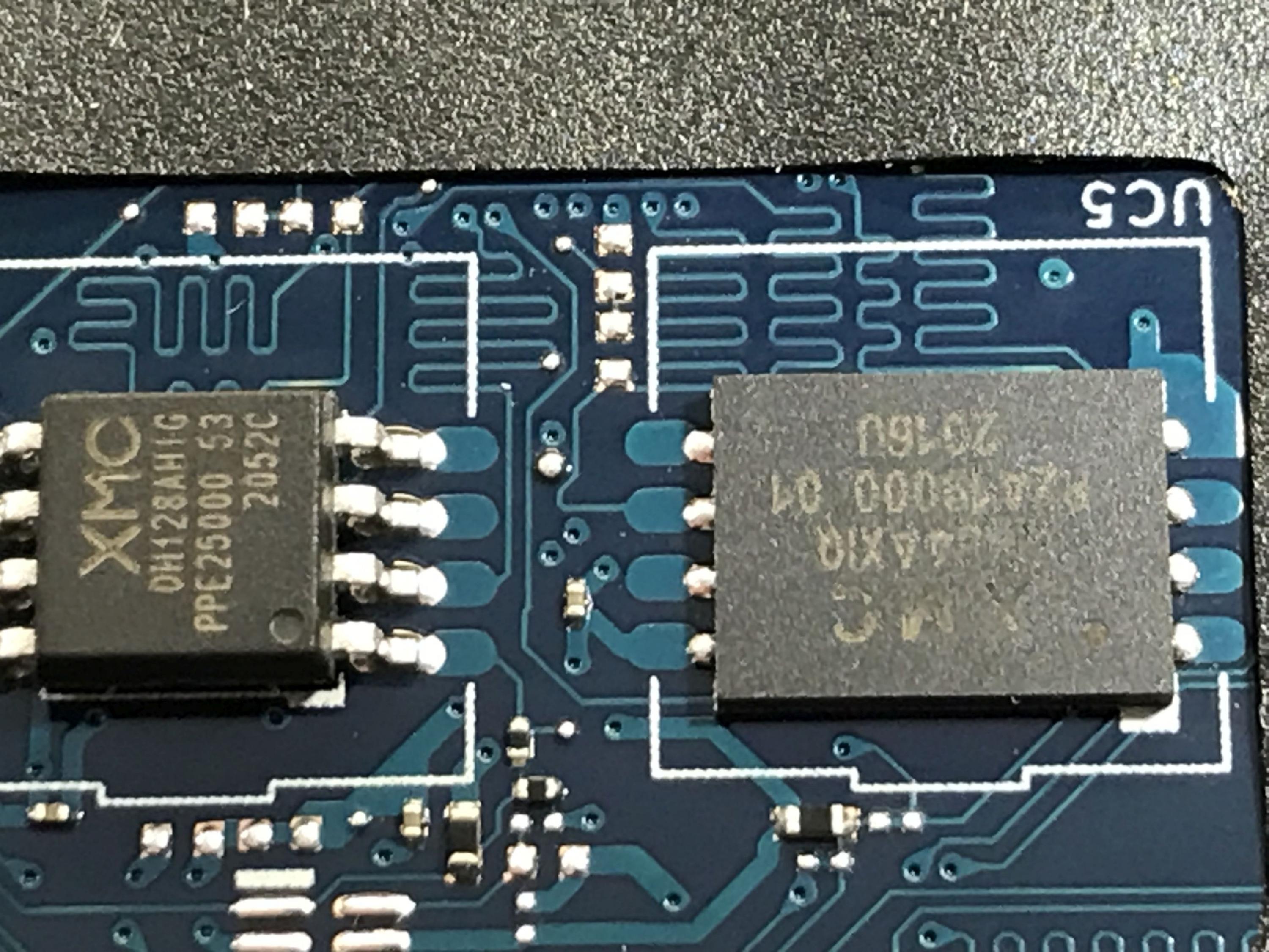

            Re: PASSWRD Dell Latitude 5510 FDW50 LA-J381P
            Hi guys,
            Could you help to remove Password from Bios
            Latitude 5510
            FDW50 LA-J381P
            • Vesko356
              VIP Moderator
              • Aug 2018
              • 4386
              • Bulgaria 🇧🇬
              #146
              Originally posted by potrebitell
              Hi guys,
              Latitude 5510
              FDW50 LA-J381P
              Upload the dump from the second (8MB) chip.

                #147
                Sorry...
                I uploaded the new file.

                  #148
                  Sorry...
                  1st boot, press F2, write service tag, disable Absolute, save (Apply changes), restart. 2nd boot press Alt+F to exit manufacturing mode.
                  • potrebitell
                    • Feb 2021
                    • 14
                    • Bulgaria
                    #149
                    Thanks! Problem solved!

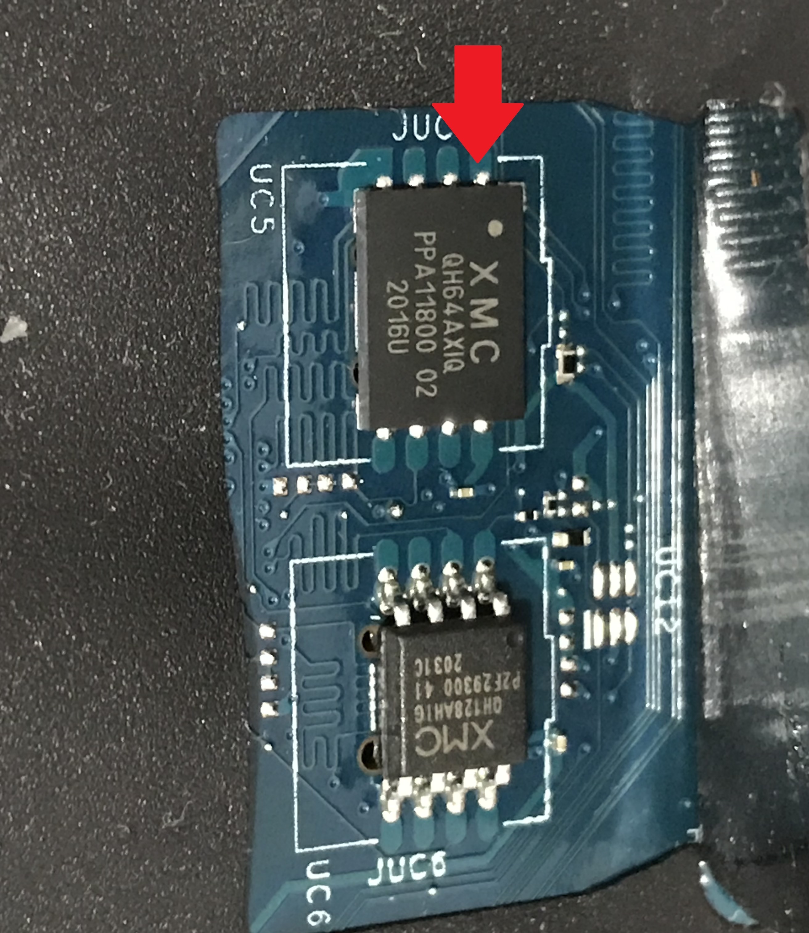

                                      can someone please help me to clear this
                                      ST:C6C8S73
                                      i Upload the dump from the UC5 chip I use NeoProgrammer and ch341a programmer

                                        #160
                                        try
