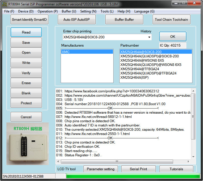

    Sorry it was late reply, I said i posted the picture. I will upload content of 8mb chip once i have it. Sorry

        Wrong chip or bad read

            #245
            Bad read , choose wson8

                #247
                Originally posted by Alexander Mils
                Done
                Don't forget to save a copy of your original dump
                always make 2 or more copy and compare it to be sure
                RT809 have always a issue with XMC bios chip
                1st boot, press F2, write service tag, disable Absolute, save, restart.
                2nd boot press Alt+F to exit manufacturing mode.
                Good luck.

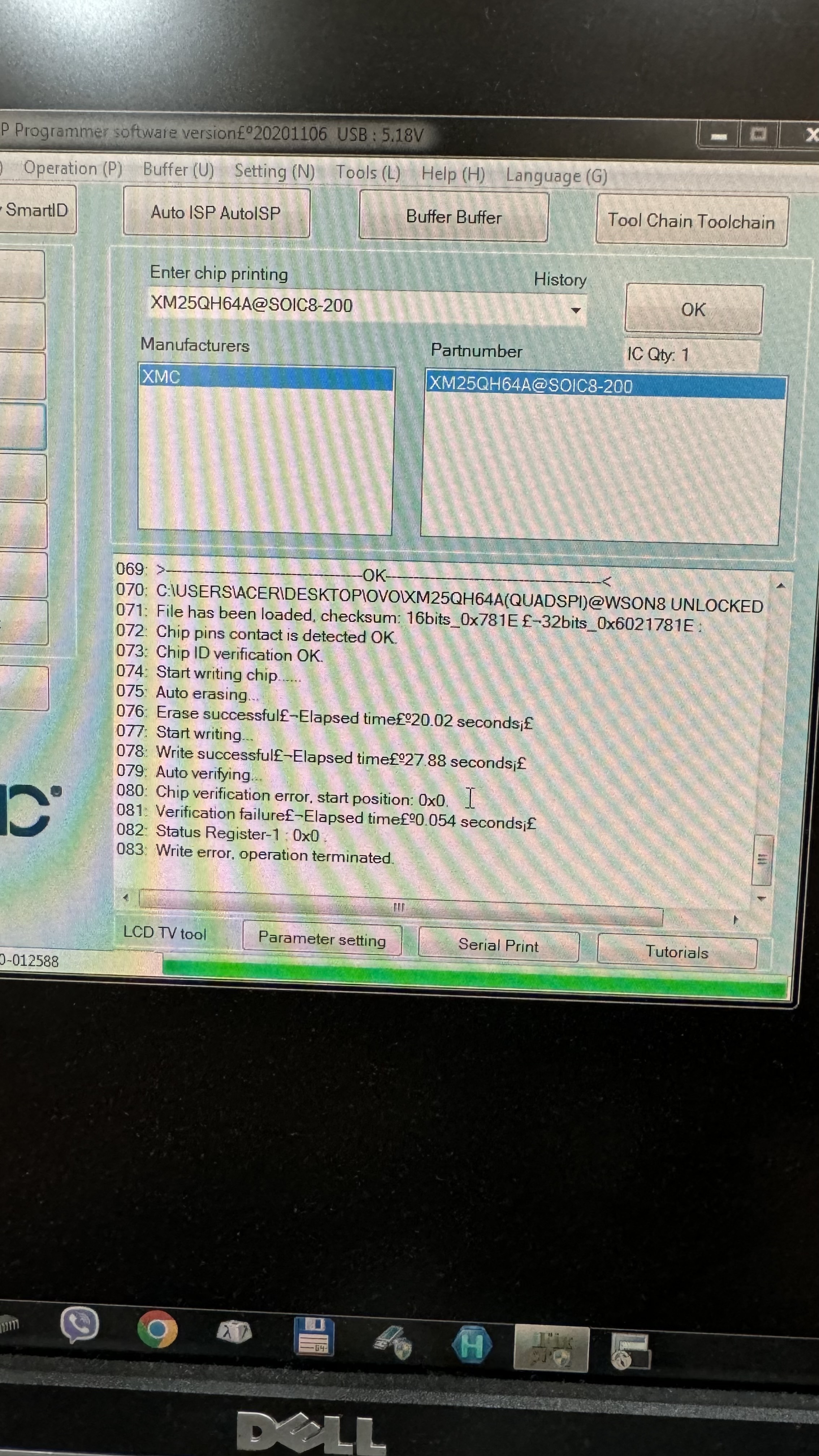

                • Alexander Mils
                  • Jun 2025
                  • 10
                  • Serbia
                  #248
                  Good luck.
                  Yes I have chip verification error. What shout I do?

                    #249
                    ignor it..or try again and pressing at the bios chip in the programmer until it complete writing

                      #250
                      Tried everything and nothing Any other solution?

                        #251
                        Try to update your rt809 from official site..

                          #252
                          Nope, tried everything, old file, new file, nothing. only empty bin is working and verifying successfully 🤷🏻‍♂️😞
