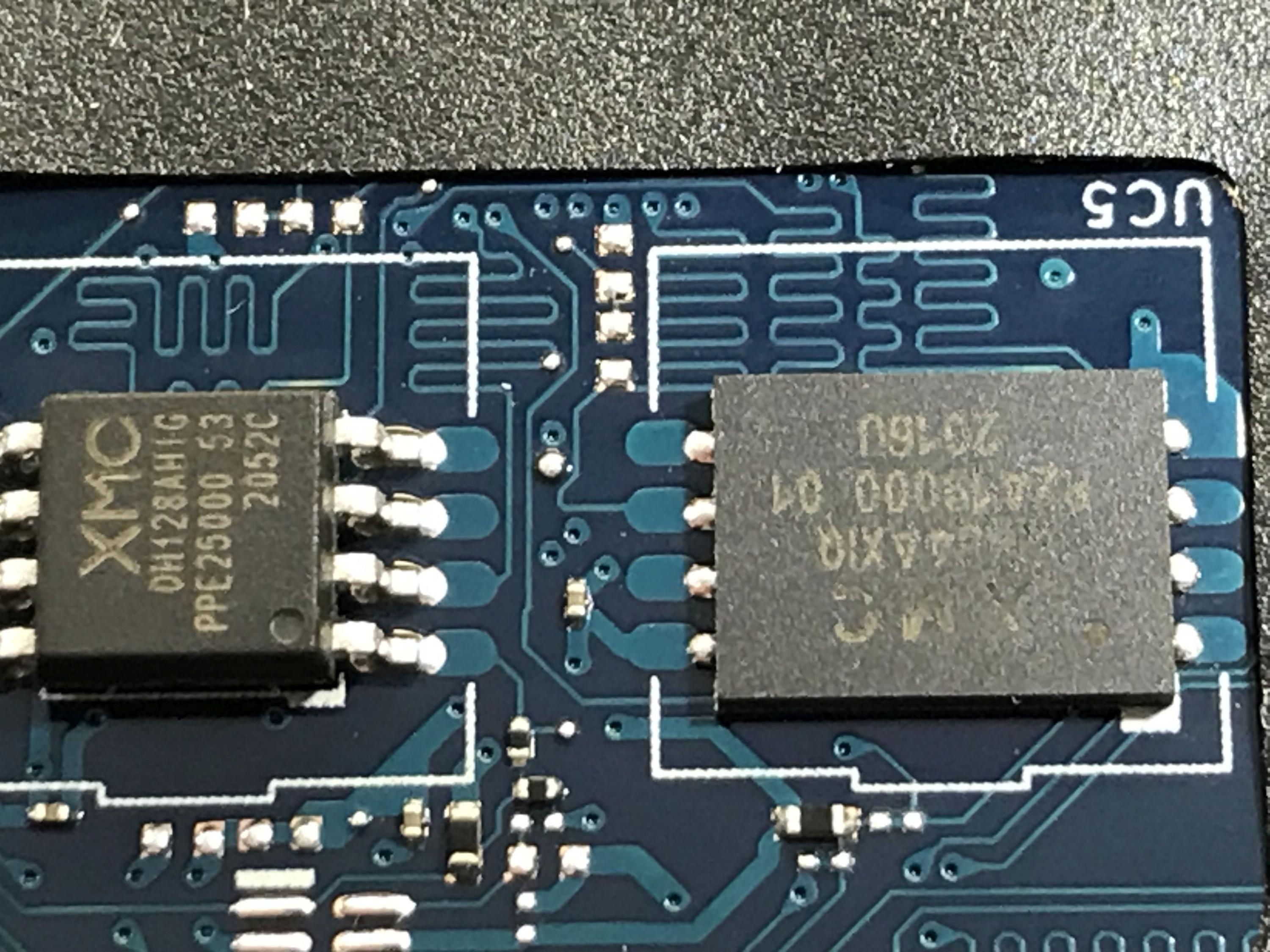

                I have a Dell Latitude 5510 that has dual BIOS. Please advise if I need to post both dumps or only the main one if I ask to unlock.

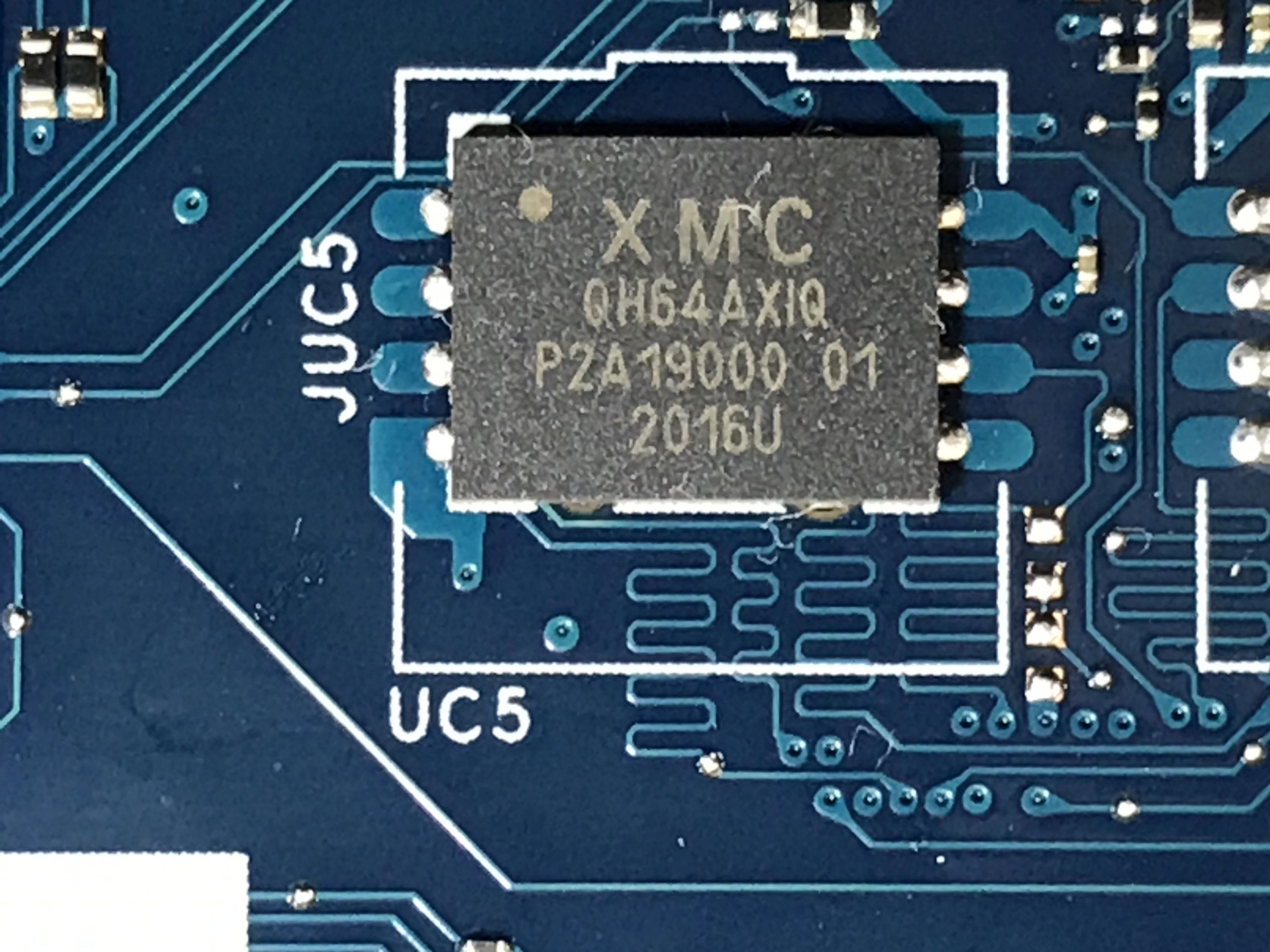

                        Upload the dump from the UC5 chip only. What's the marking of the chip. I can't read the markings - photo is unclear.
                        Become a Badcaps supporter
                        Thanks to all supporters.
                        • xxxxRobertxxxx
                          • May 2022
                          • 12
                          #52
                          Re: PASSWRD Dell Latitude 5510 FDW50 LA-J381P
                          It's
                          XMC QH64AXIQ
                          I upload the Dump a bit later as I need to remove chip and take the dump first.
                          Much appreciate your help.

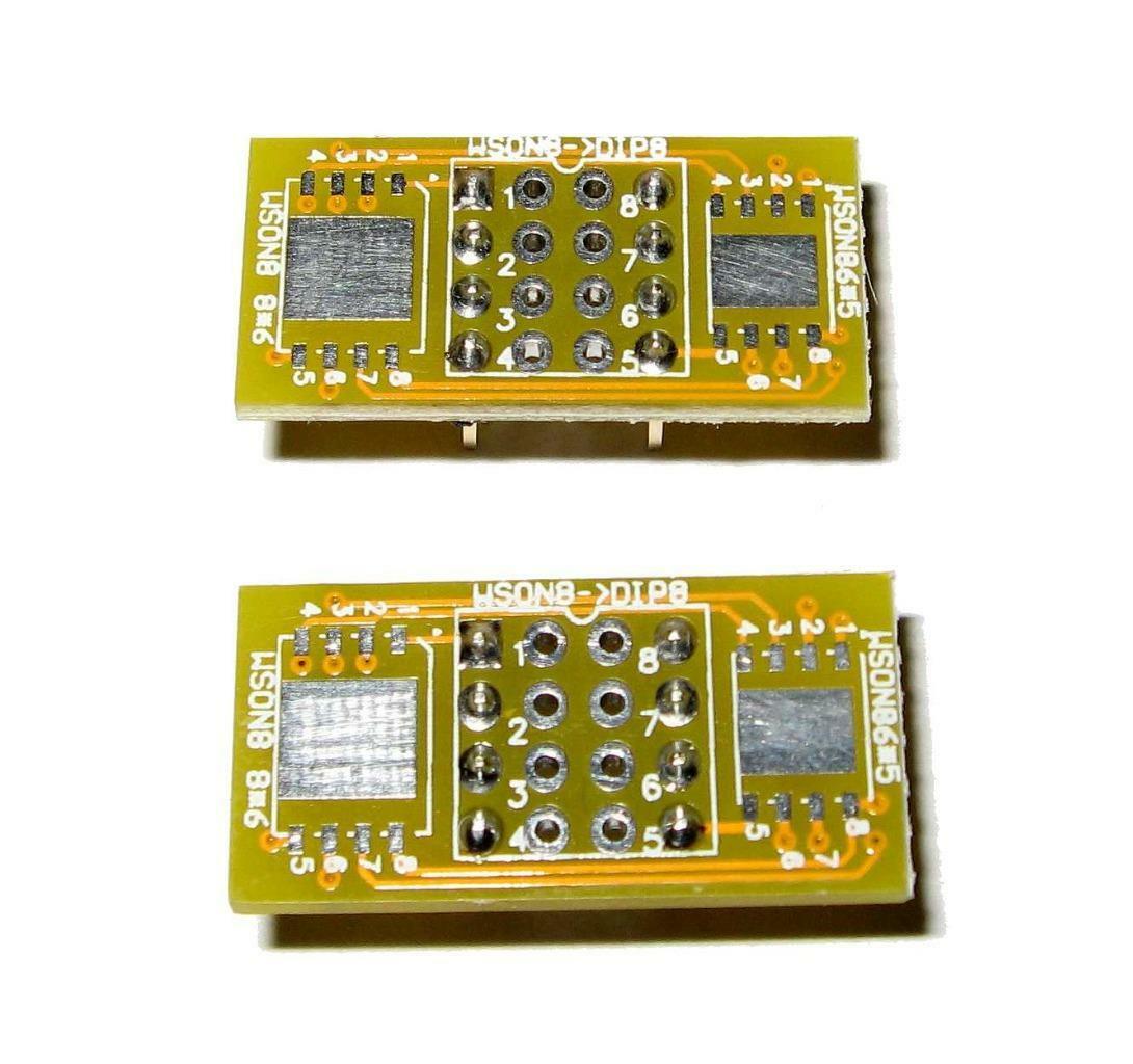

                                    • xxxxRobertxxxx
                                      • May 2022
                                      • 12
                                      #58
                                      Originally posted by Vesko356
                                      That explains everything. What software (name and version) do you use with it?
                                      Also what is the adapter for connection to the chip?
                                      I use NeoProgrammer 2.2.0.10 and adapter on the picture.
