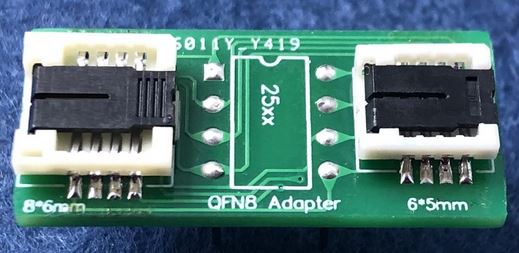

    Looks like it's time for new programmer. I think I go for TL866II as veryfication failed on both apps.
    Yes TL866II is a good choice for the money.
    Edit: I'll also suggest to get another adapter, for example:
    https://www.badcaps.net/forum/showpo...&postcount=228
        I just purchased TL866II and awaiting for delivery. I also ordered new adapter.
        Thank you for all your help so far. I come back as soon as I receive programmer and read the chip properly.
            Good decision, the only reasonable one in this case. Send me a message when you're ready because I'm not always here, and I'll be happy to help you, we'll remove the password without any problems, don't worry.

                  Hi there,
                  I just received my new programmer today and couldn't wait any longer to read BIOS chip from my dell 5510. I think I've improved reading 100%. as the programmer does the really good job. I have done 3 undependent BIOS dumps as you have advised to do. Please have a look when you got a minute.
                    Hi there,
                    Indeed, completely different story this time - the new programmer works as it should.
                    Below is your unlocked file, at first boot enter the bios and write the Service Tag, then restart and you're good to go:

                                About the verification part - do not rely on a automatic verification process built into the software. I've said it before on another occasion, but here it is again for your information:
                                Originally posted by Vesko356
                                The safest method for verifying the contents is to read the chip after programming and compare the resulting file with the source. This eliminates any doubt, and you can proceed to soldering the chip to the board.
                                In this way, each step of the process is verified, and in the event of a problem, only the last step can be checked - namely the soldering to be inspected.
                                Otherwise, everything has to be done again from the beginning, because it is not certain at what stage the mistake was made.
                                This also applies to the initial reading of the chip with the original (containing the password) dump. Two or three content dumps need to be made that are compared to each other. If they are the same then it is certain that the content has been read correctly.
                                The procedures described above can take five minutes longer, but save five hours of headaches.
