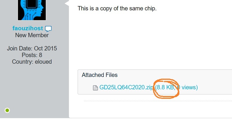

    Originally posted by faouzihost
    This is a copy of the same chip.
    Focus on ...you always post the wrong or bad read of your bios.
    Don't waste your/our time

        #303
        Do you use a clip to read your bios !!
        always you post a bad read
