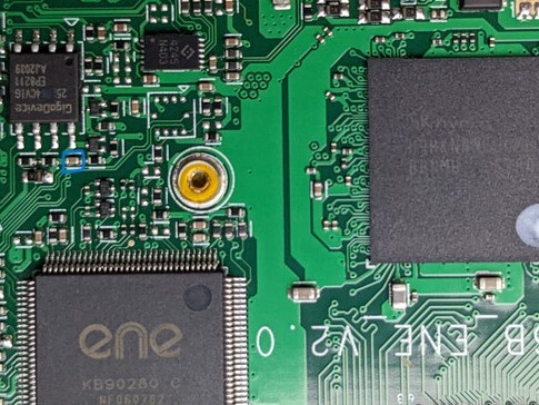

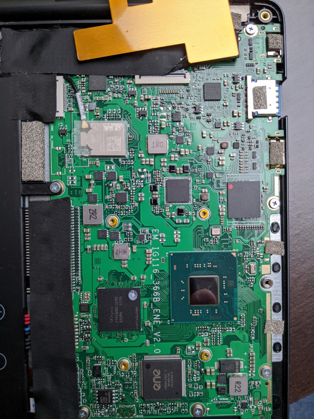

    Hi, is it possible to get a boarview or schemtics of UNOWHY Y13G010S4EI
    motherbord : EM_IG116_366B_ENE_V2.0
    or a picture of the bios chip area will be appreciated Thank you in advance

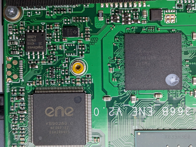

    I have exactly this model, here are pictures of the BIOS chip.
    I'm looking for a picture of this BIOS because my PC doesn't turn on anymore since I disabled the FastBoot option in the bios.
    If you have a BIOS dump, I'm interested.

        This is exactly what I was looking for. I just flashed your BIOS with a ch341a, but unfortunately my PC still doesn't reboot ...
        Did you get this BIOS with afuwin ?
        Thanks again anyway

              I saw this on motherboard
              BIOS and RTC

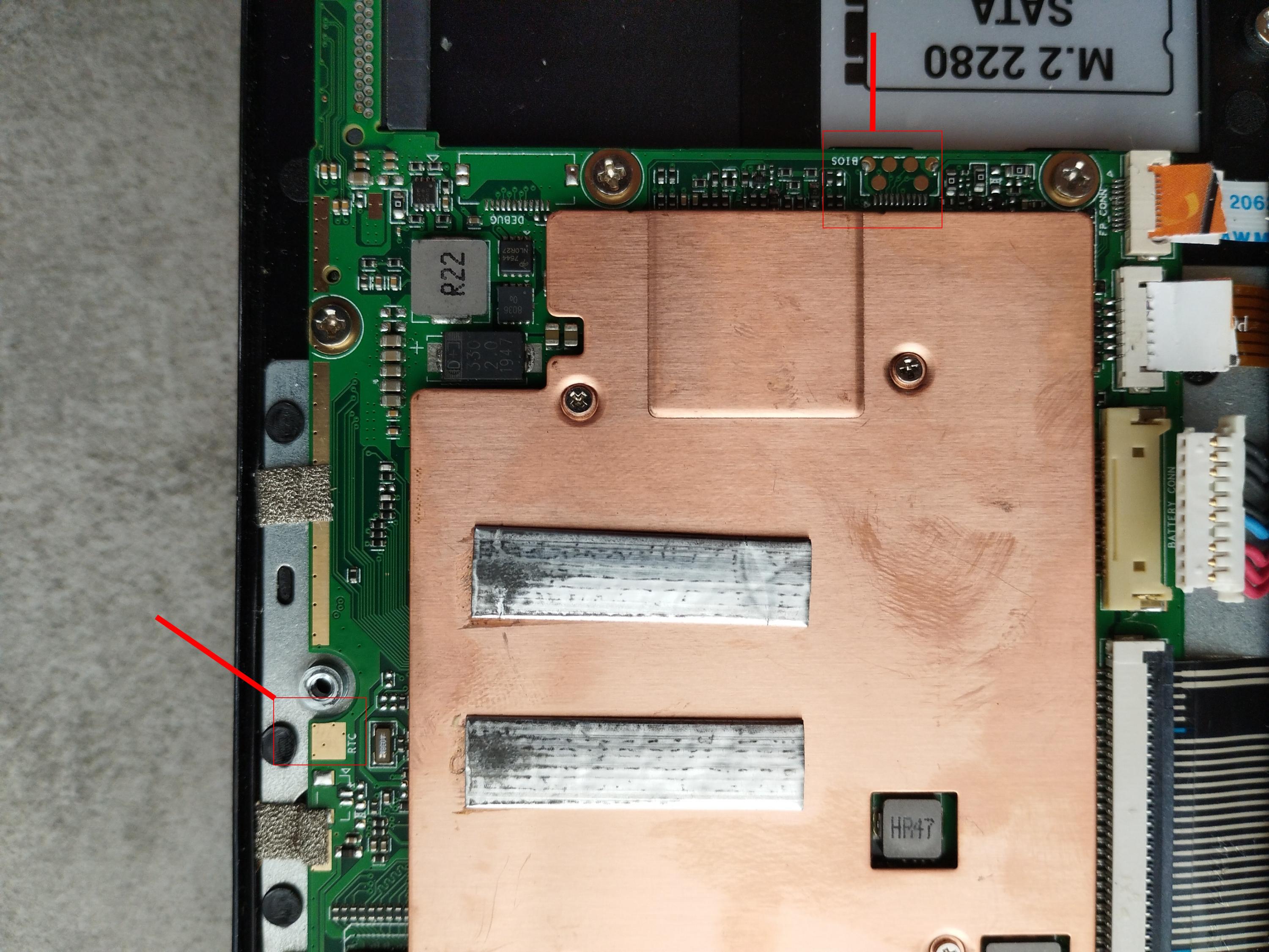

                Hello friends, I need your help. I need the specifications and values of the parts I’ve drawn in the picture. I damaged mine
