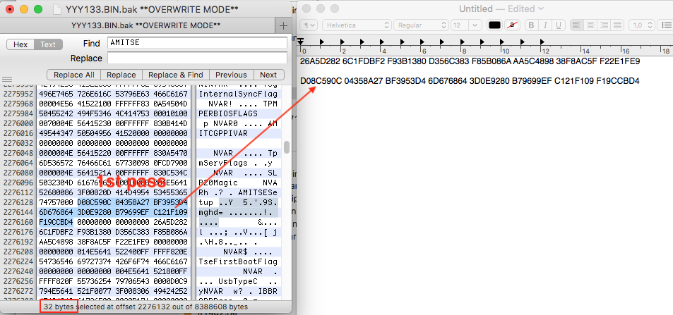

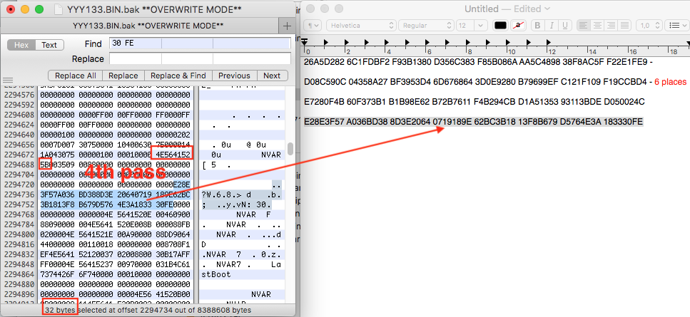

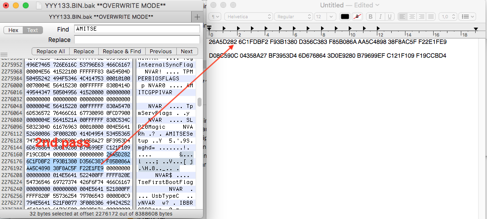

                    I will try to explain how I remove passwords in Unowhy:
                    1. Open bios backup file with hex editor.
                    2. Search for text "AMITSE".
                    3. Copy hex values found under "AMITSESetup" entry into a text editor - sometimes there are 2 strings of 32bytes each - see photos
                    4. Fill with "00" hex strings of 32bytes found under "AMITSESetup" entry
                    5. Search for hex strings of 32bytes copied in text editor -you'll find them in many places, sometimes in 5-6 places. Fill them with "00"
                    6. Search for text "NVAR[" or hex "4E5641525B" - sometimes there are 3rd or 4th password in that entry. They have also 32bytes. Fill them with "00"
                    7. Photos are from bios backup of post 265 with 4 passwords. Usually there are only 2 passwords of 32bytes, this is an unusual case.
                    Click image for larger version  Name:	Screen Shot 2025-04-10 at 18.10.19.png Views:	0 Size:	99.1 KB ID:	3612184
                    Click image for larger version  Name:	Screen Shot 2025-04-10 at 18.10.38.png Views:	0 Size:	102.0 KB ID:	3612185
                    Click image for larger version  Name:	Screen Shot 2025-04-10 at 18.17.56.png Views:	0 Size:	114.9 KB ID:	3612186
