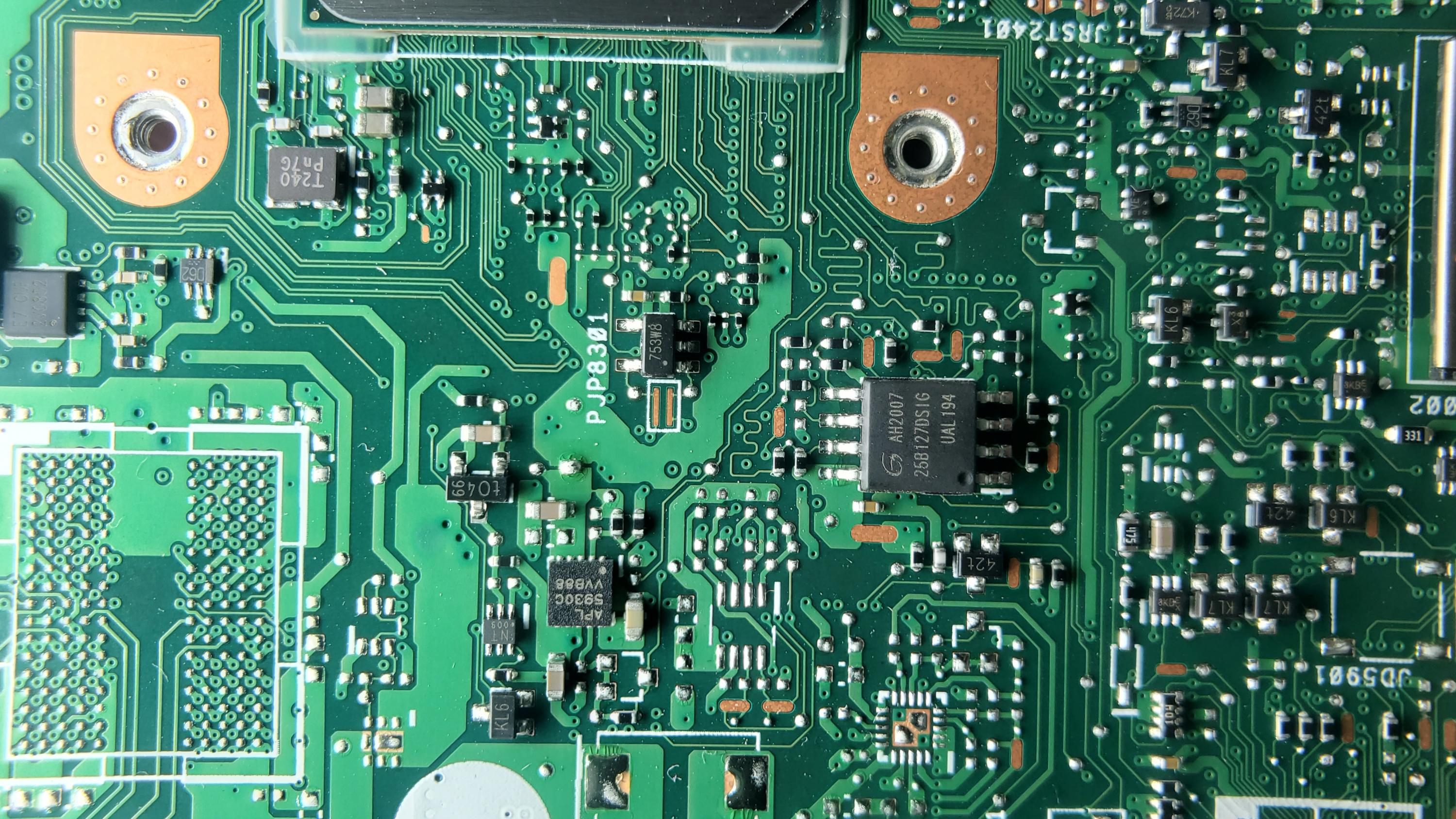

    I am finally reaching out for some help after I attempted different routes. I have an Asus VivoBook S14 with a locked down BIOS. I have been trying to remove the password to enable USB booting. I can access the BIOS via USER settings (minimal) and login to Windows. The board has a GigaDevice 25B127DSIG which can be read and write using Gigadevice GD25Q128 in the programmers. There are no other chips on the board.
    BTW I have the chip off the board currently at the moment. I would like to avoid putting it back on the board until the issue is resolved as the clips for flashing SUCK and I have already used the hot air iron to remove the chip twice now.
    I have been using CH341AUSB Programmer and have tried ASProgrammer. Flashrom can be available also if I need it but I have no issues with the current programmers.

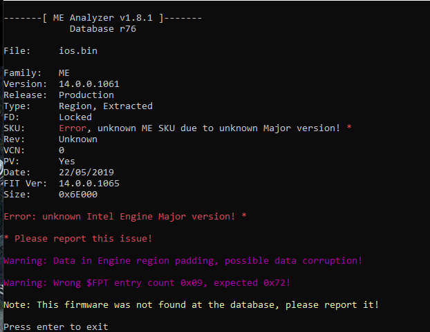

    4. Attempted to extract the ME region and use ME Analyzer to verify ME version but fail to find a clean ME region download online. and ME Analyzer errors out with an unknown version.
    Upon further investigation it looks like the downloaded firmware form the website contains the entire BIOS with everything. Correct me if I am wrong, but can I not just delete the first 2KB as someone explained in another post then flash the chip? I was in the understanding regarding the Serial Number, Windows Key, and MAC address in the DMI table. But honestly I am not too worried about that anyways as I will be swapping out the wireless card and eventually not be running Windows on the machine if I can get past the BIOS password issue.
