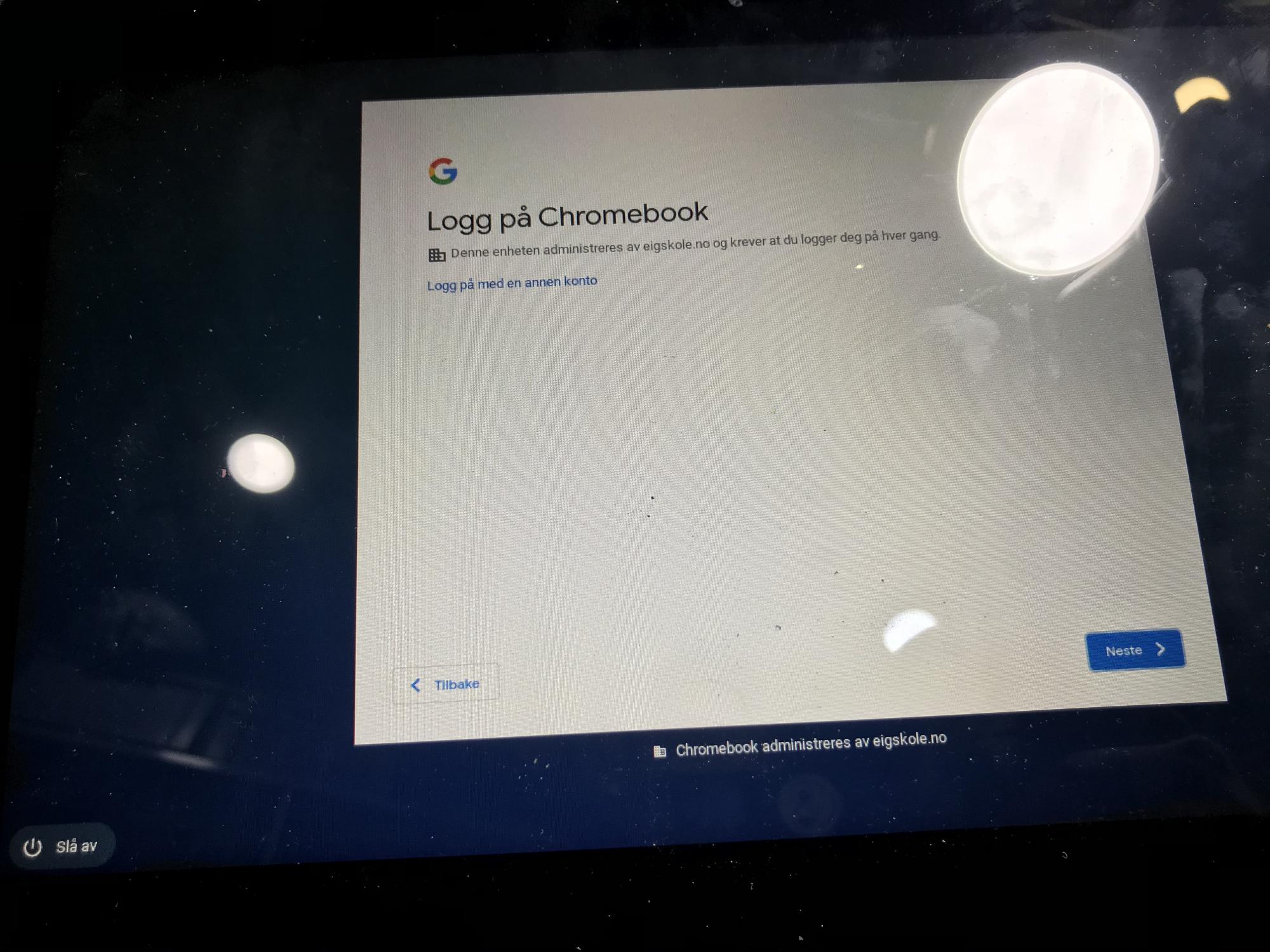

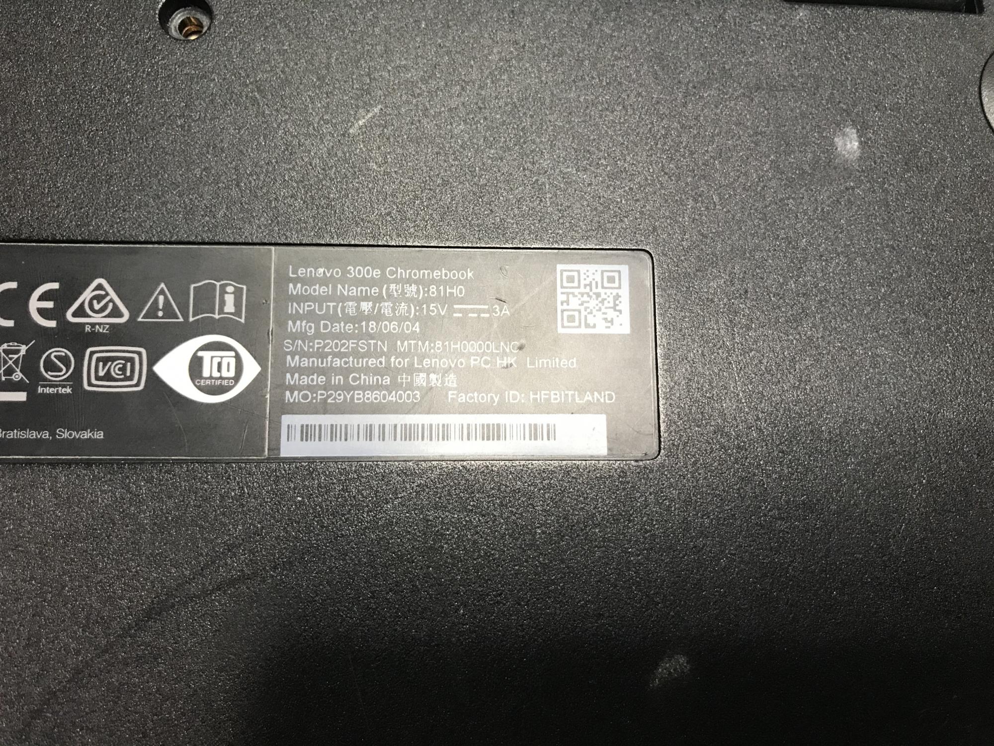

        Hi everyone I have Lenovo Laptop with Chromebook OS with gmail administrator password.
        I try Reinstall OS form USB, try PowerWash Method but Chromebook Administrator privileges stay here.
        Trying flash Bios Can fix this problem or anything else.
        I upload some images of laptop.

          Re: Lenovo 300e Chromebook
          Where's the bios dump file?
              Flash this file. It will not be unlocked straight away. You need to enable devmode first. It will not let you go to devmode but that's okay. You need to let it reboot into normal mode, which clears the system. Then you will be able to log in and powerwash. After powerwashing, devmode is unlocked aswell.
                Working Perfect, thank you.
                Can I use this dump for 6 laptops with same problem?
