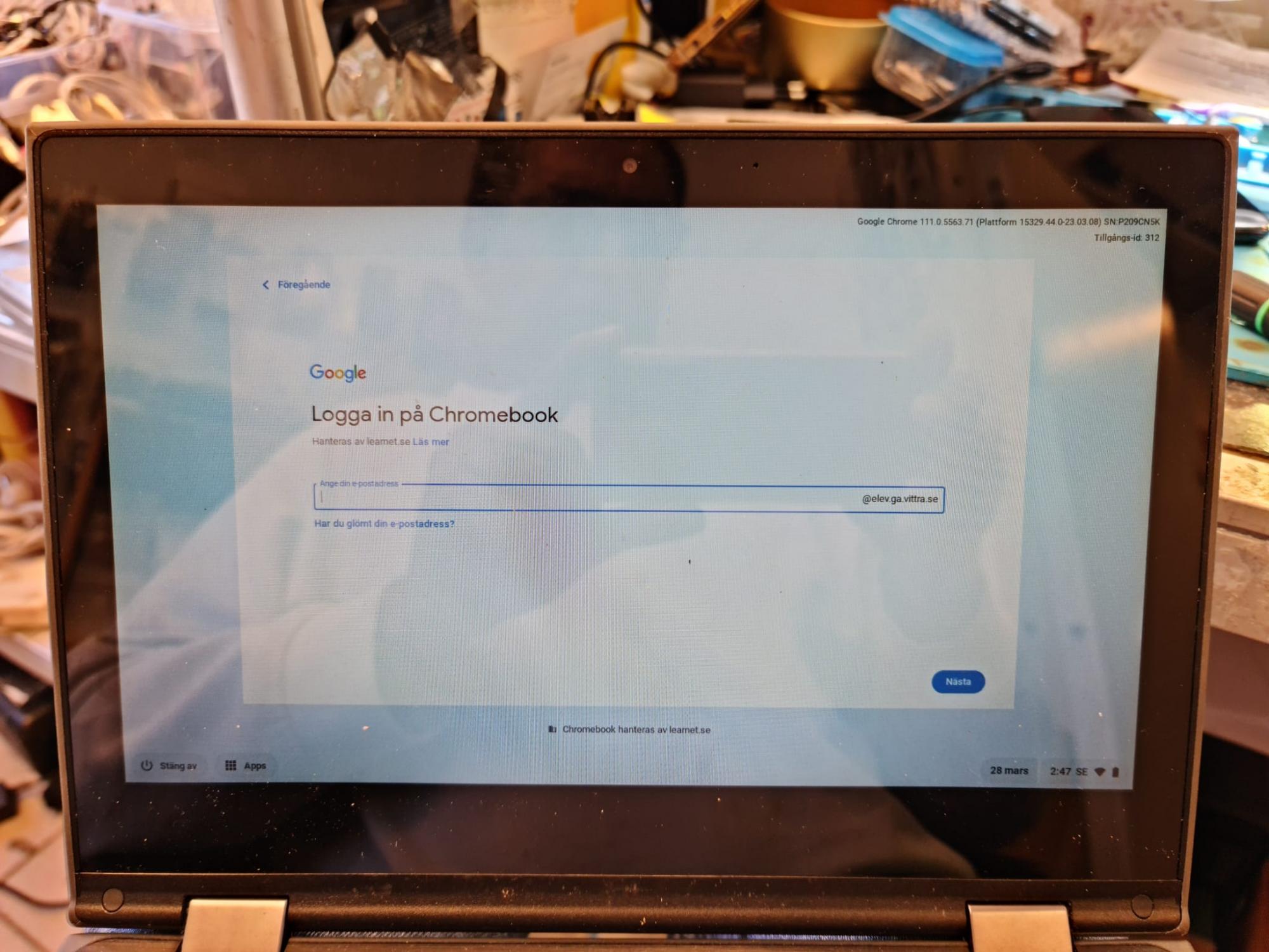

                  • Sweden
                  #68
                  Re: Lenovo 300e Chromebook
                  Hi
                  i had issue lenovo e300 gen2 not unlock i have many try with rcunlocker and manual
                  lbe but nt unlock
                  please some unlock this file

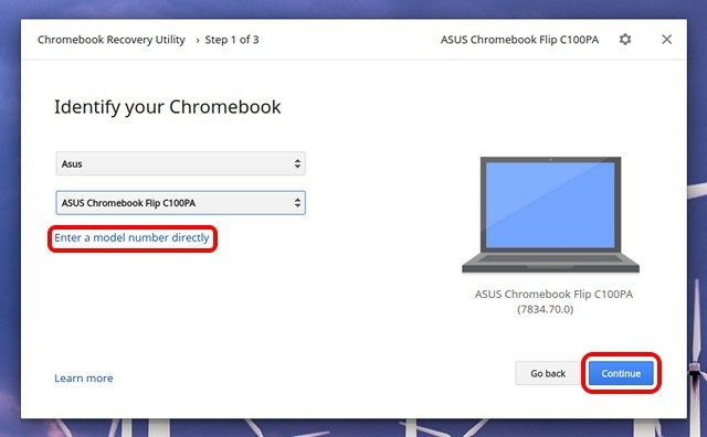

                  • hardware1

                      #70
                      Hi
                      i tired this before and not evan don this new Os still not unlocked not evan unlocked with your file
                      • salim1gr
                        • Oct 2018
                        • 22
                        • Sweden
                          Originally posted by salim1gr
                          Hi
                          Take an image for the message that appears to you.
                          all donations are welcome,
                          • salim1gr
                            • Oct 2018
                            • 22
                            • Sweden
                            #73
                            yes down is picture

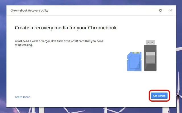

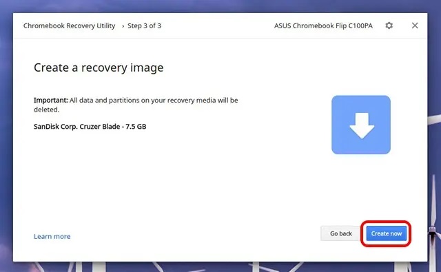

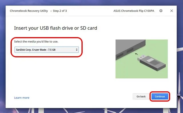

                              yes down is picture
                              Did you follow what I have said before?
                              Create a bootable USB drive for your device model using the chrome extension "Chromebook recovery utility"
                              Just choose your Device Model (Lenovo 300e).

                                #75
                                i know this
                                i have a don usb and install new Os but same
                                also tired with file please check it not unlock very strange
                                enterprise account.
                                thanks
