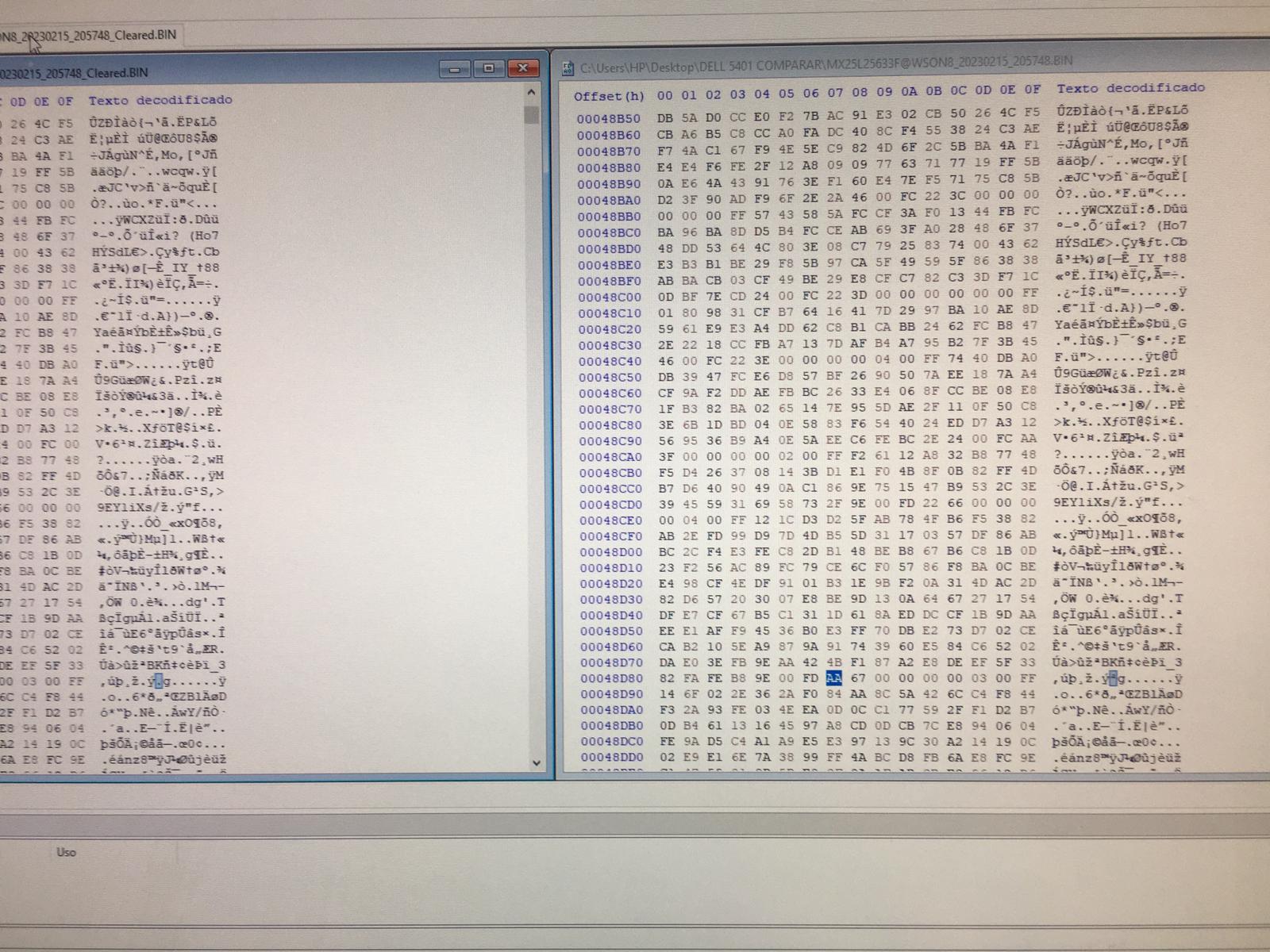

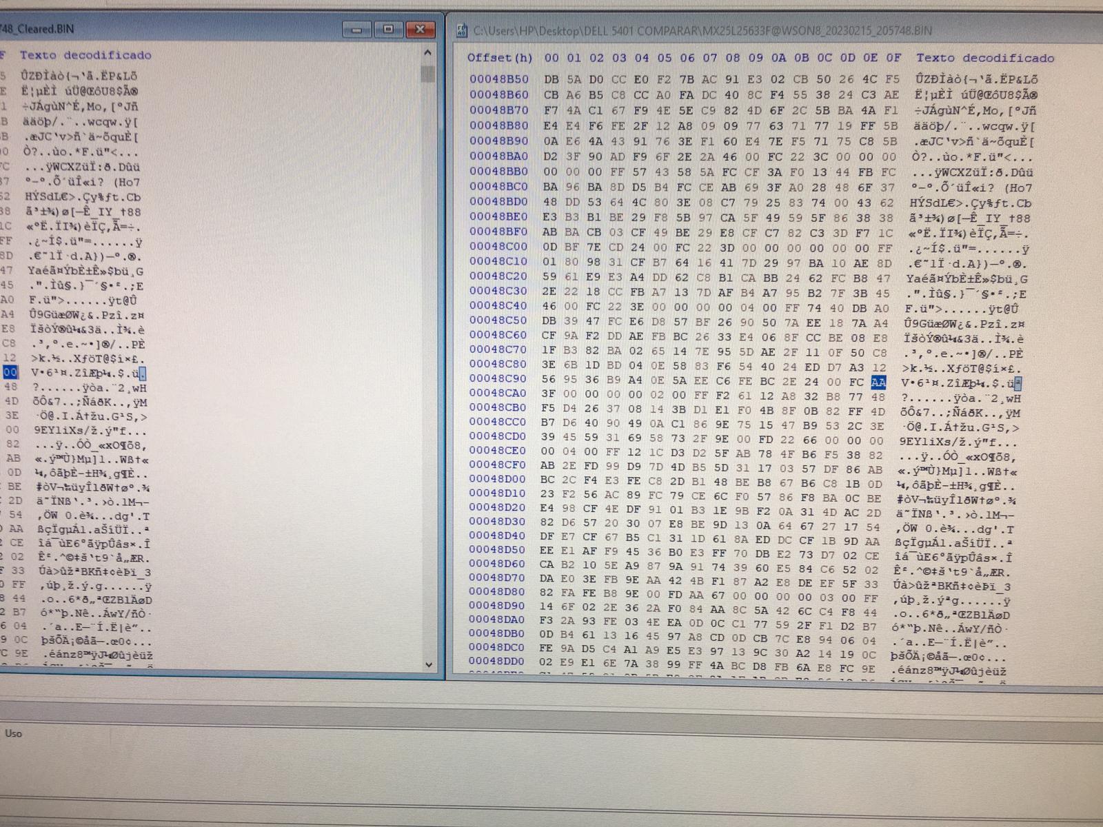

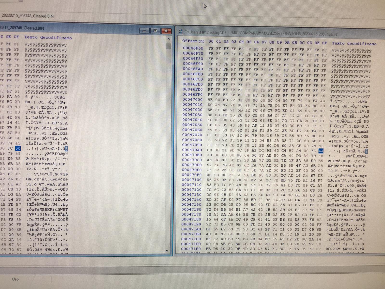

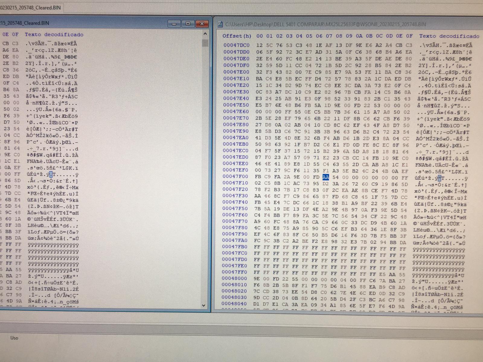

          DELL Latitude 5401 BIOS Password 8FC8
          Need help with removing admin password from DELL Latitude 5401, 8FC8.
          Board model LA-H172P.
          Tried replacing ME and BIOS regions, without success.
          BIOS dump attached.
          • Lafika
            • Apr 2022
            • 3
            Re: DELL Latitude 5401 BIOS Password 8FC8
            Managed to restore the system to manufacturing mode by writing 0xFF to BIOS addresses between 0x45000 and 0x48FFF which belong to EC region.
