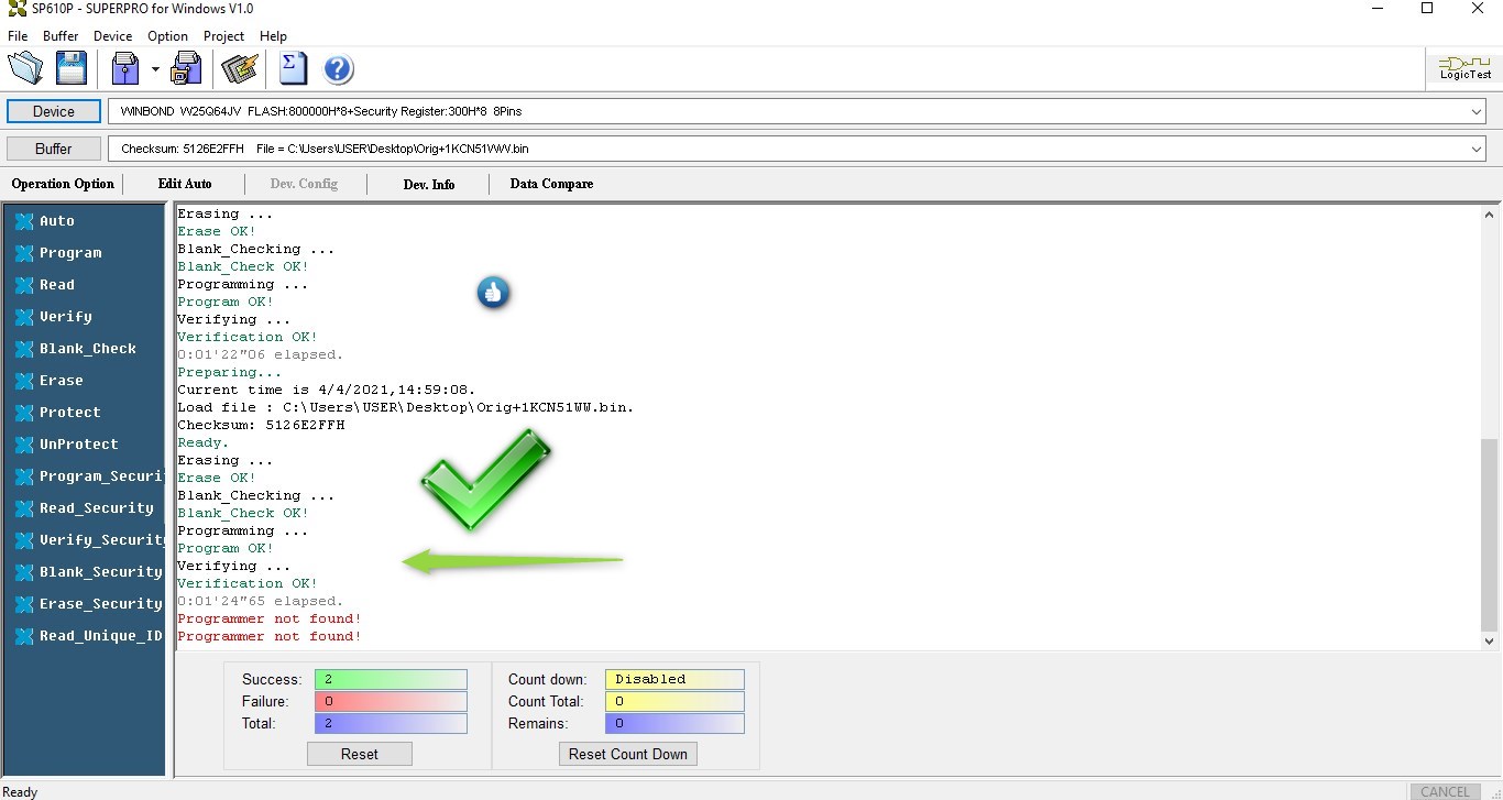

    • huss584
      Hussein
      • Apr 2020
      • 230
      • Palestine
      Re: Lenovo V110-15ISK Unlocked BIOS Password
      Originally posted by peste
      try this..
      Thank You, Done
      [/ATTACH]

        • huss584
          Hussein
          • Apr 2020
          • 230
          • Palestine

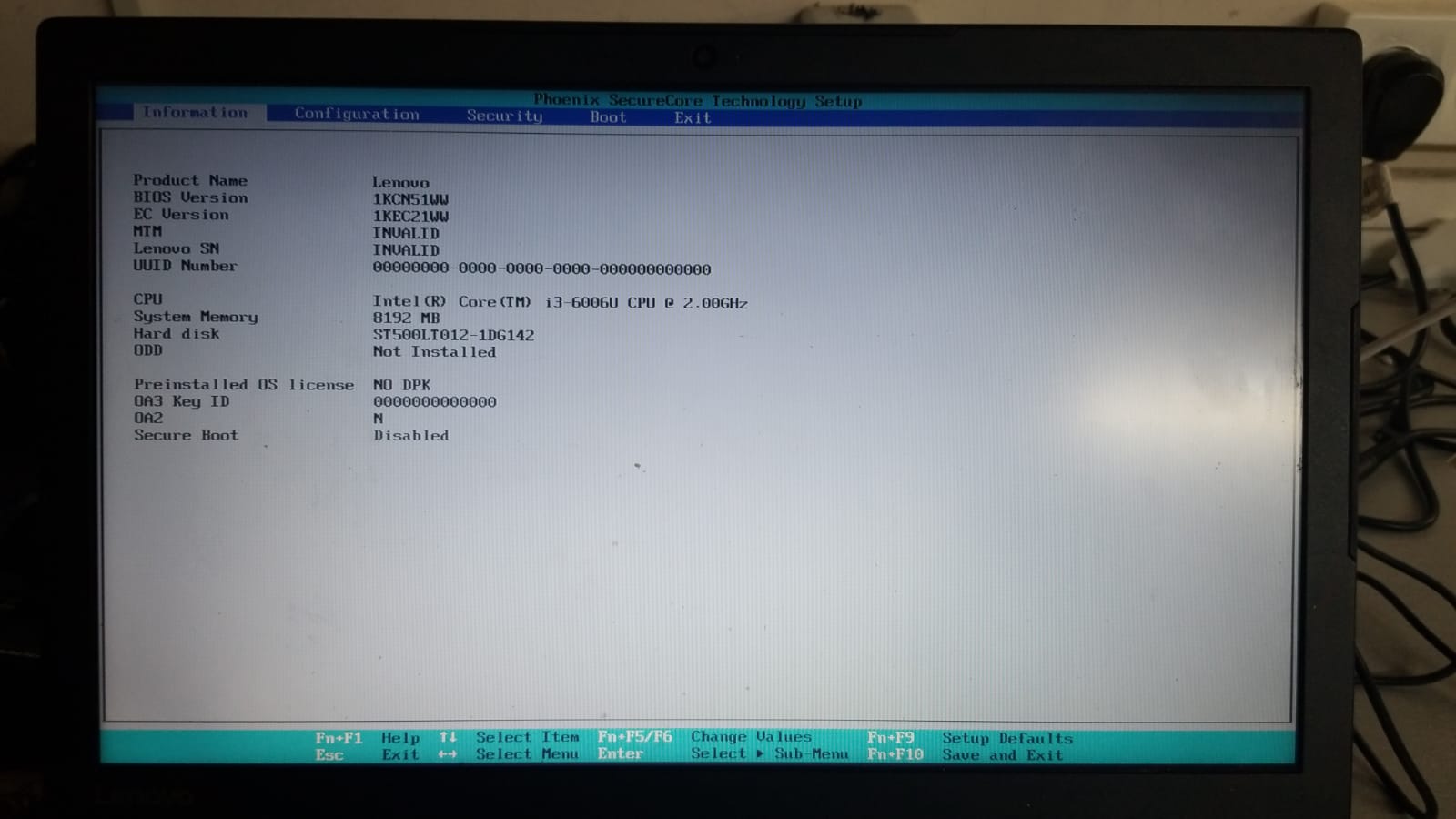

          dmi 201000-2011ff
          BUT the Serial # an MTM show me invalid as you see in picture above
          • peste
            • Dec 2016
            • 13723
            • ROMANIA
            move the DMI information from the bios posted by you. in the bios posted by me ... I passed the interval in which the DMI information is (item # 4) (give your copy-paste), at that interval from one bios to another..use the HxD program ..
