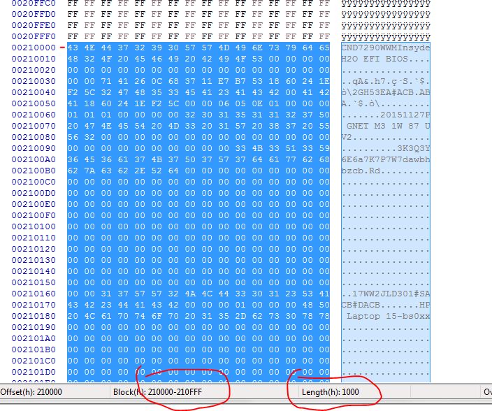

          • 21679
          Re: Hp 250 g6
          Originally posted by Daudi83
          Hello I have a HP 250 G6 No keyboard , no display.
          CSL50/CSL52 LA-E791P REv 2.0
          Core i3-6006U/ discrete graphics
          Here is the original bios.
          CAn anybody help me, with it?

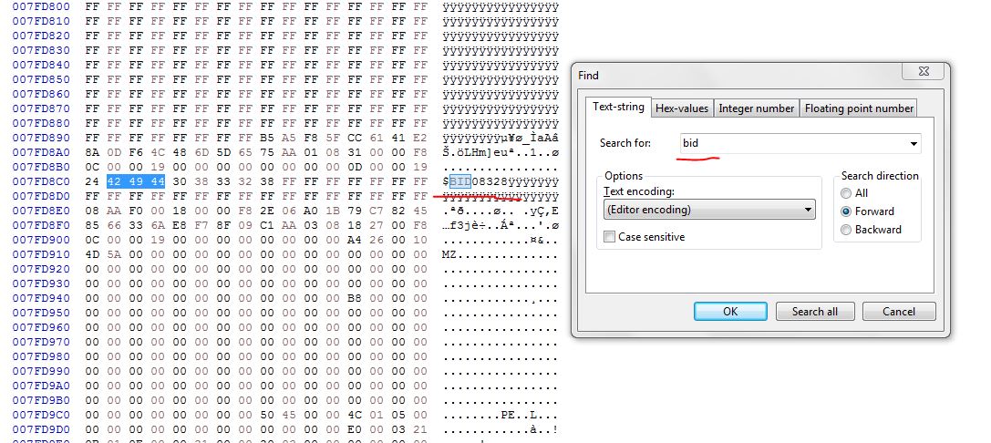

          Open your backup with a hex editor https://mh-nexus.de/en/hxd/ and search for the word BID ,keep pressing F3 to find the next instance until you see BID***** .Go to the HP support site, enter the laptop serial number to find drivers. Download the bios,run the exe ,it will give you the option to save the bios.
          Open your backup and the new bios with your hex editor,copy the DMI info from your backup (Edit-Select Block),and paste-inset into the new one using the same off-sets (Edit-Select Block)
          210000 - 210FFF

                My brother how do you copy the DMI info, i did all the steps and it was easy, only got confused when copying the DMI info, i was lost from this step, i ended up using the bios with no serial number
                  • 21679
                  Re: Hp 250 g6
                  Basically its just copy whats in one region of the old bios to the new one. Get some practice with this guide -> https://www.badcaps.net/forum/showthread.php?t=98038 ,although its for a different laptop once you know how to do all the copying/pasting you won`t have any problems with this one.
