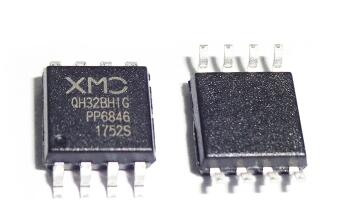

                  i using Ezp2019 Flash Disk Usb Spi Program Support 24 26 93 Eeprom 25
                  not detect

                    Choose winbond 25Q32 instead and untick check-id if thats an option.Then try to make a backup .

                          good day sir. how about via ch341a black edition,, is there anyway to read that exact file

                            Do you mean to read the XMC chip. Try NeoProgrammer software ,it supports quite a few XMC chips.
                              https://www.badcaps.net/forum/showpo...50&postcount=5
                              thank you very much sir,,,
