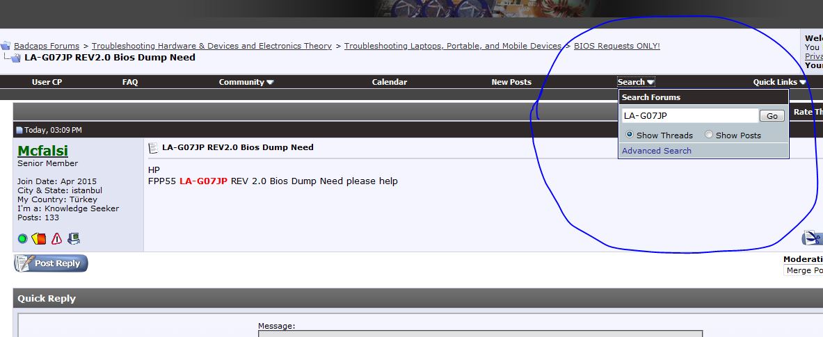

                  LA-G07JP REV2.0 Bios Dump Need
                  HP
                  FPP55 LA-G07JP REV 2.0 Bios Dump Need please help
                    • 21186
                    Re: LA-G07JP REV2.0 Bios Dump Need
                    Use the forum search please...

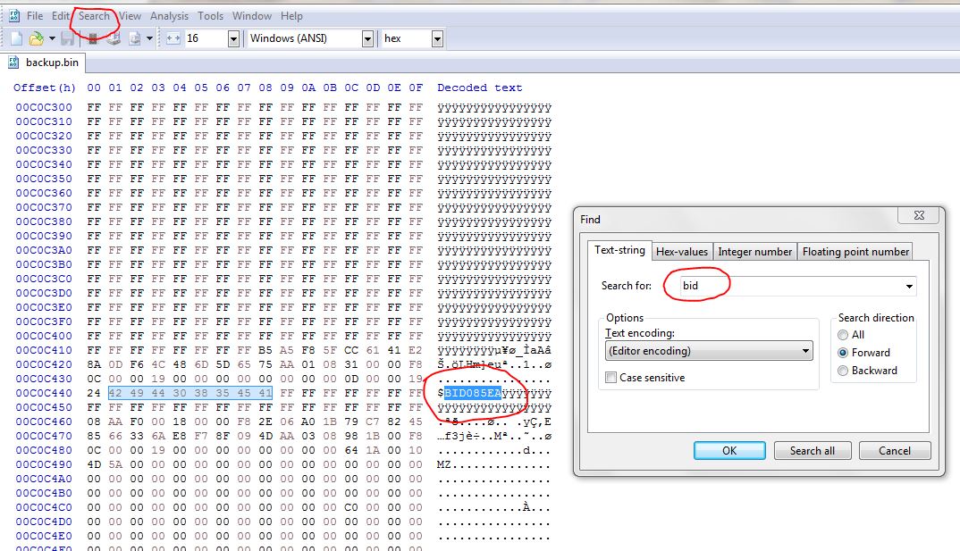

                        Post the full laptop model number ,and your bios backup. Most new HP bios updates can be extracted by running the bios update.exe and selecting copy. You will lose DMI info though.

                            See post #6. Check your bios using a hex editor to find your BID number. Peste has given the DMI area to copy from the old bios to the new one.
                            From post #12 "Most new HP bios updates can be extracted by running the bios update.exe and selecting copy. You will lose DMI info though."
                            EDIT: HxD hex editor has a tukish language version - https://mh-nexus.de/en/downloads.php?product=HxD20
