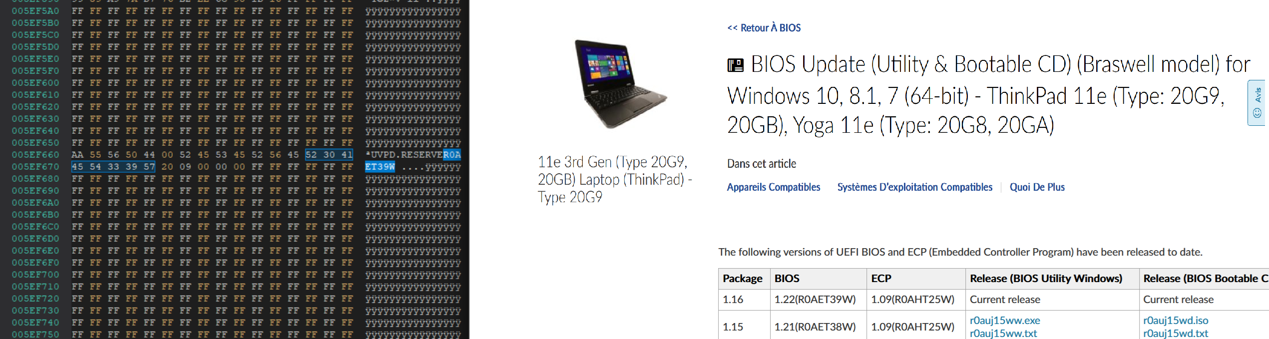

    Originally posted by joby91
    For anyone still searching for solution here it is:
    The password is stored in EC chip NPCE288 from 0x2600 to 0x2647. Just fill in with FF.
    Here the Screenshot and also my locked and my unlocked EC file.
    thanks for solution ...

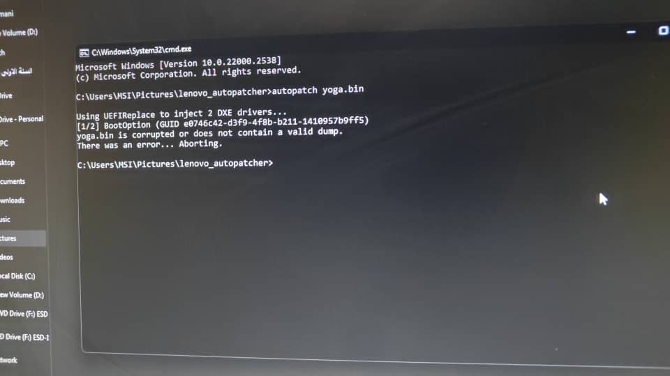

        Hello
        can you help me please to unlock thinkpad yoga 11e
        mb: DALI8GMB6D0 rev: D
        serial number LA-0B05XZ
        • TECHO TN
          • Jan 2024
          • 67
          • algeria
          #104
          Originally posted by TECHO TN
          Hello
          Hello again
          I tried to unlock it with autopatcher but it says that there is an error and the dump is corrupted
          what should i do ? ?
              Hello again
              sn not good

                  #108
                  Originally posted by sosit
                  please help i can't find correct bios
                  • system board serial number 8SSB20K87688A1SH68K00H
                  there are not 2 chips on this model?? 32 and 64 MB
                  Type of CPU celeron/pentium (Braswell) or Ix (Skylake)
                  Two differents bios
                  For me it's Braswell because R0AET39W on bios
Name:	Nouveau Image bitmap (2).png
                  otherwise it would be R0Bxxxxx if skylake
