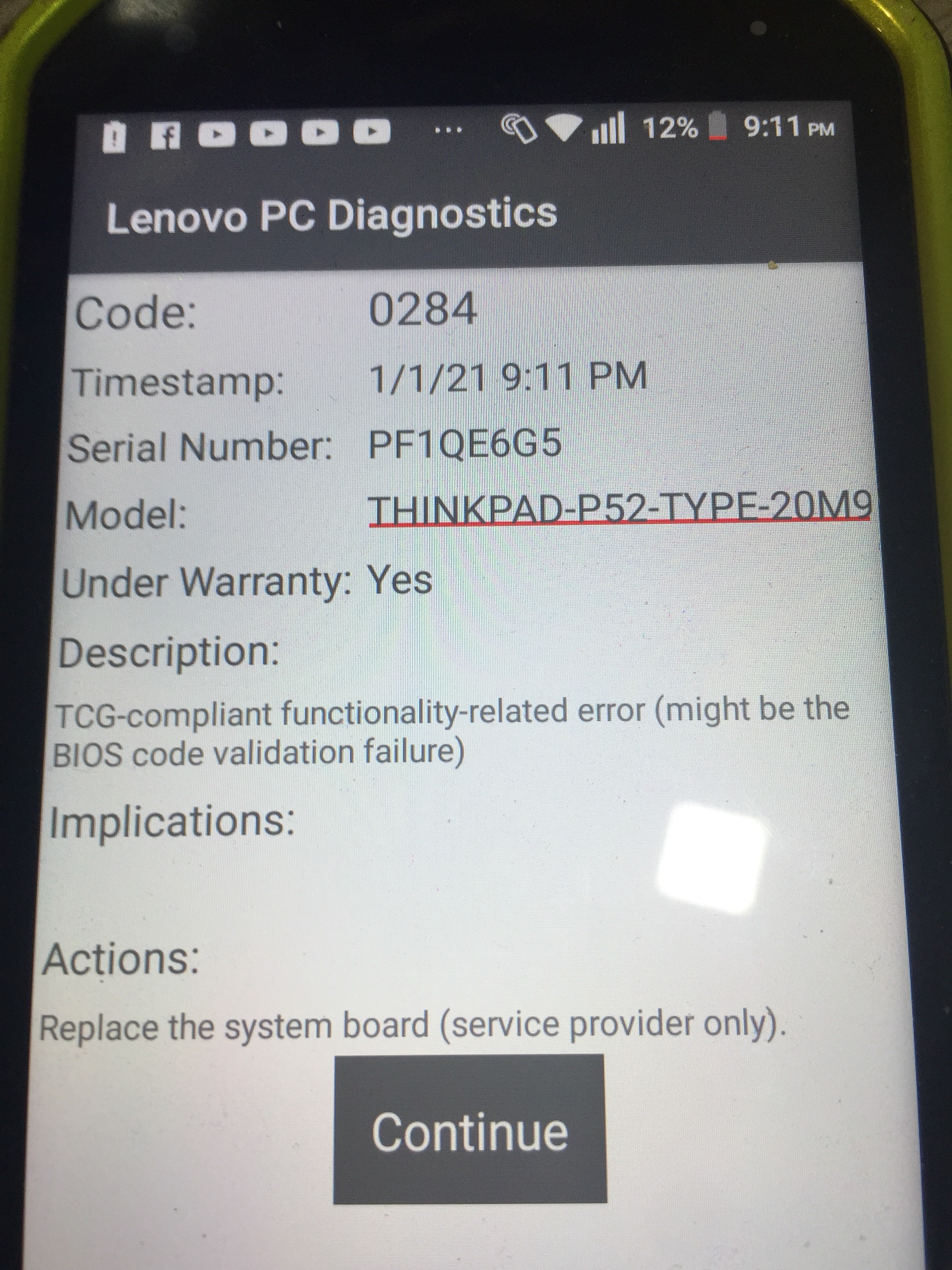

    P52 Bios 20m9 Need
    Some one have P52 Type 20M9-000LUS can share me please!
    My org bios turn on but not coming display!

      • black0hackers
        • Jul 2020
        • 365
        Re: P52 Bios Need
        Originally posted by peste
        try..
        thank you for your help!
        it power on and still no display.
        sound beep playing
        i used Lenovo PC Diagnostic check and get info like picture attach

          Try this one.

            Thank you so much!

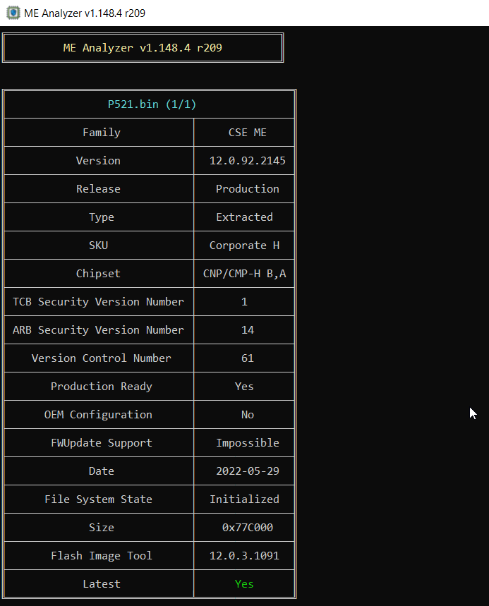

                          Re: Lenovo P52 not powering up
                          I´ve flashed again the version attached. I´ve got it from this forum, but don´t remember the exact post, I´ll try to figure it out.
                          With this BIOS, the Laptop is starting. I get no HDMI output, but I get the error code 0288 for Display Error, wich is fine, because there is no internal display attached.
                          Also I get 4 short beeps.
                          The system starts directly when I plug the charger. No blinking on power led. Power off and power on again works with the power button.
                          Fans are spinning and the system stays on.
                          I think the hardware is fine, otherwise the laptop wouldn´t start?
                          I´ve checked the bios with ME Analyzer, it says:
                          Note: This CSE ME firmware was not found at the database, please report it! (See attachements)
                          Any ideas on this?

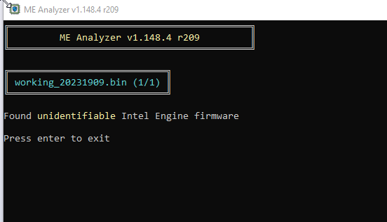

                                Finally the spare LCD-Screen arrived and I got the laptop working with the bios attached (working_20230919).
                                There is one thing that needs to be fixed.
                                With the running bios (working_20231909), everything works fine but it takes 30 seconds to get to the Lenovo boot image.
                                So I think this is because of a bad/missing/wrong ME.
                                But if I patch a bios you provided with a new/cleaned ME the Laptop don´t power on.
                                If I try to clean the ME on (working_20230919) I get an Error in the intel flash image tool (see attachments).
                                Can you please have a look again?

                                  File's corrupted

                                    Re: P52 Bios 20m9 Need
                                    Sorry, next try.

                                      Here you are
                                      • Clarify4082
                                        • Oct 2022
                                        • 61
                                        Thank you very much!
                                        Everything works now
