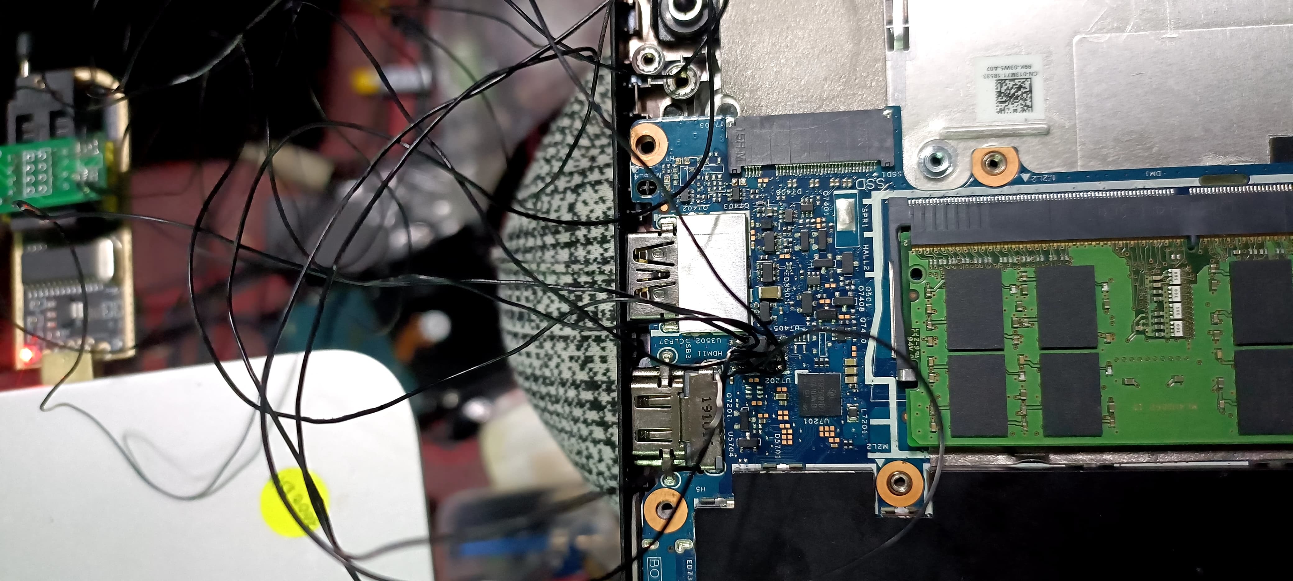

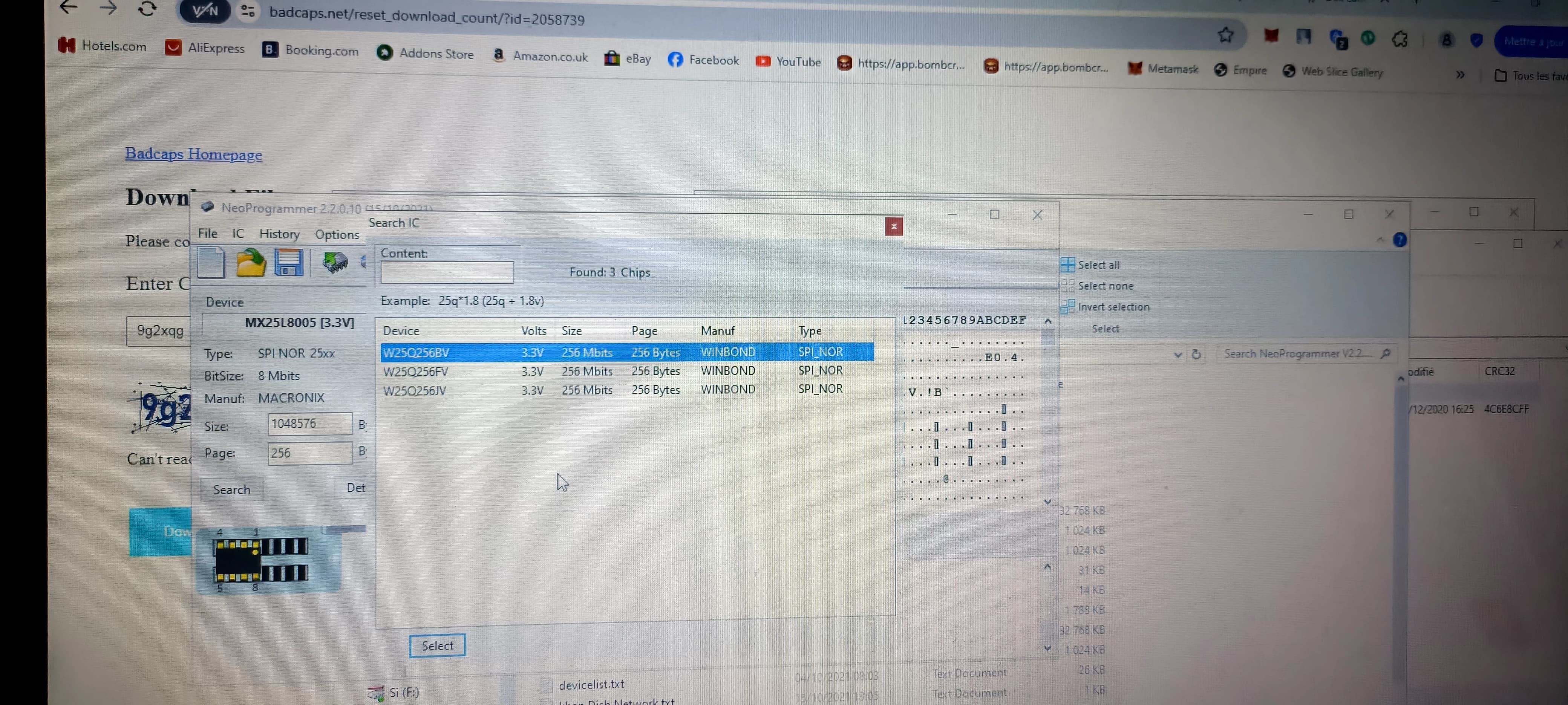

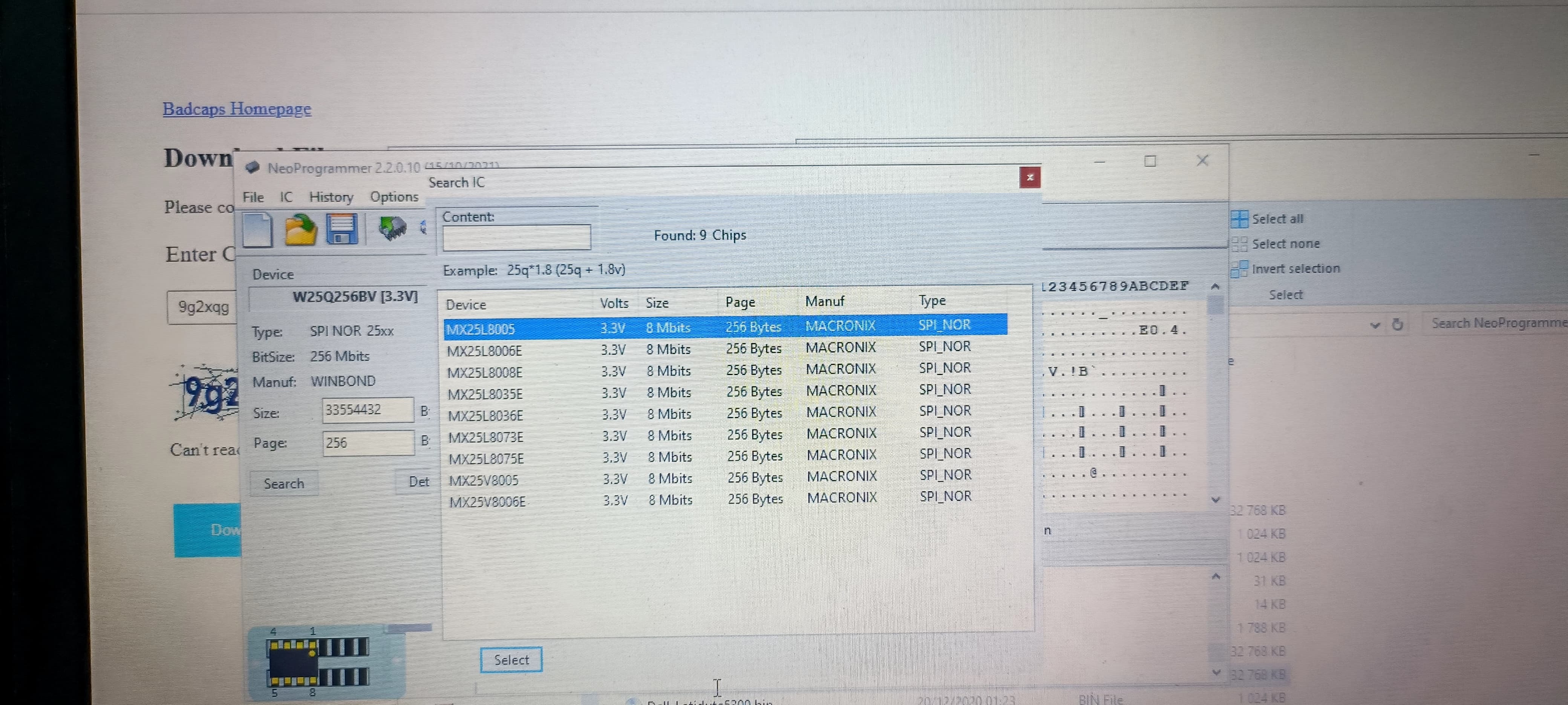

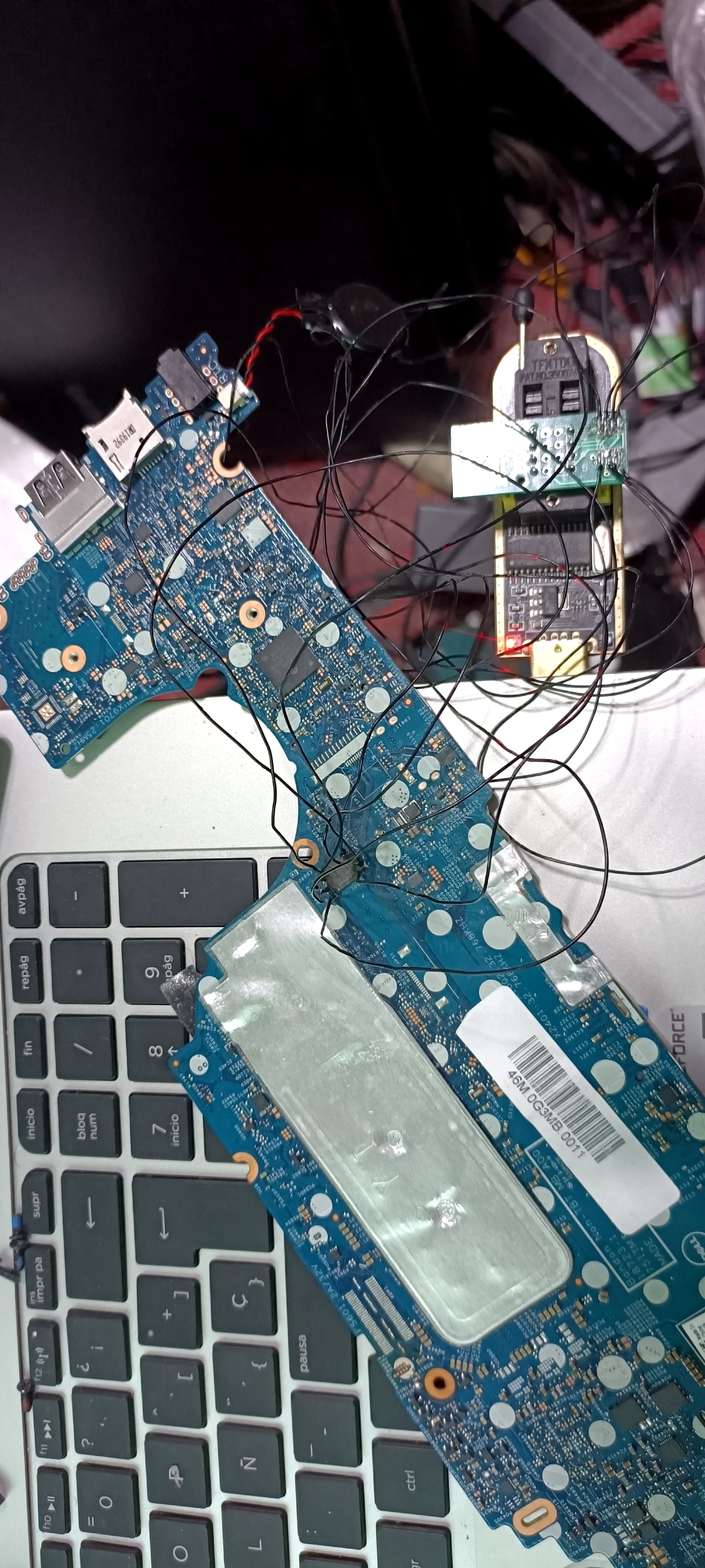

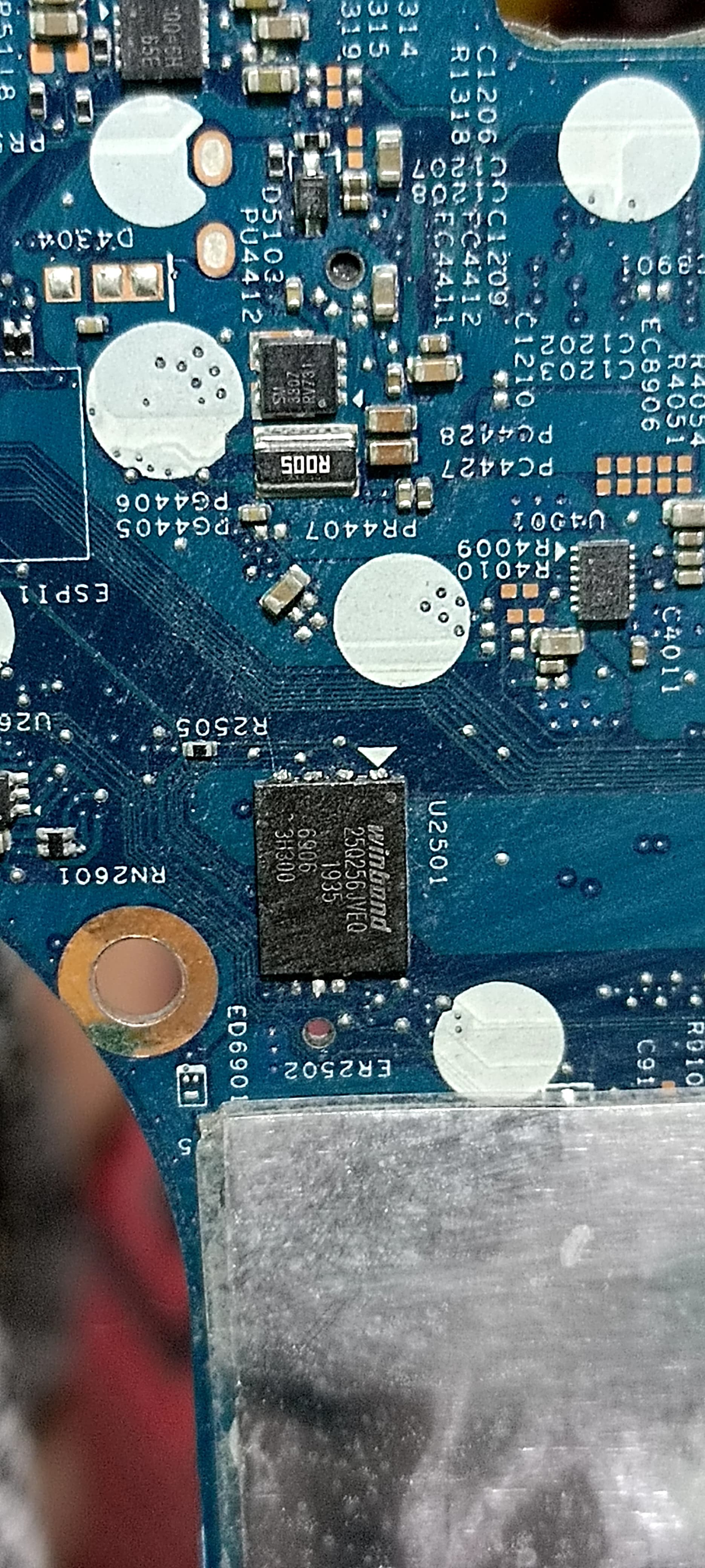

                              Hello, my device Dell Latitude 5300 2 in 1does not show anything on the screen. Please help. This is the chip. I have tried several keys to no avail.
                                SMDFlea commented
                                Editing a comment
                                25Q256JV is the right chip. The wires you`ve soldered are very long, they should be as short as possible. If you still can`t read from it recheck you have soldered the wires the right way. The most reliable way is to desolder the chip and put it in/on an adapter board.
