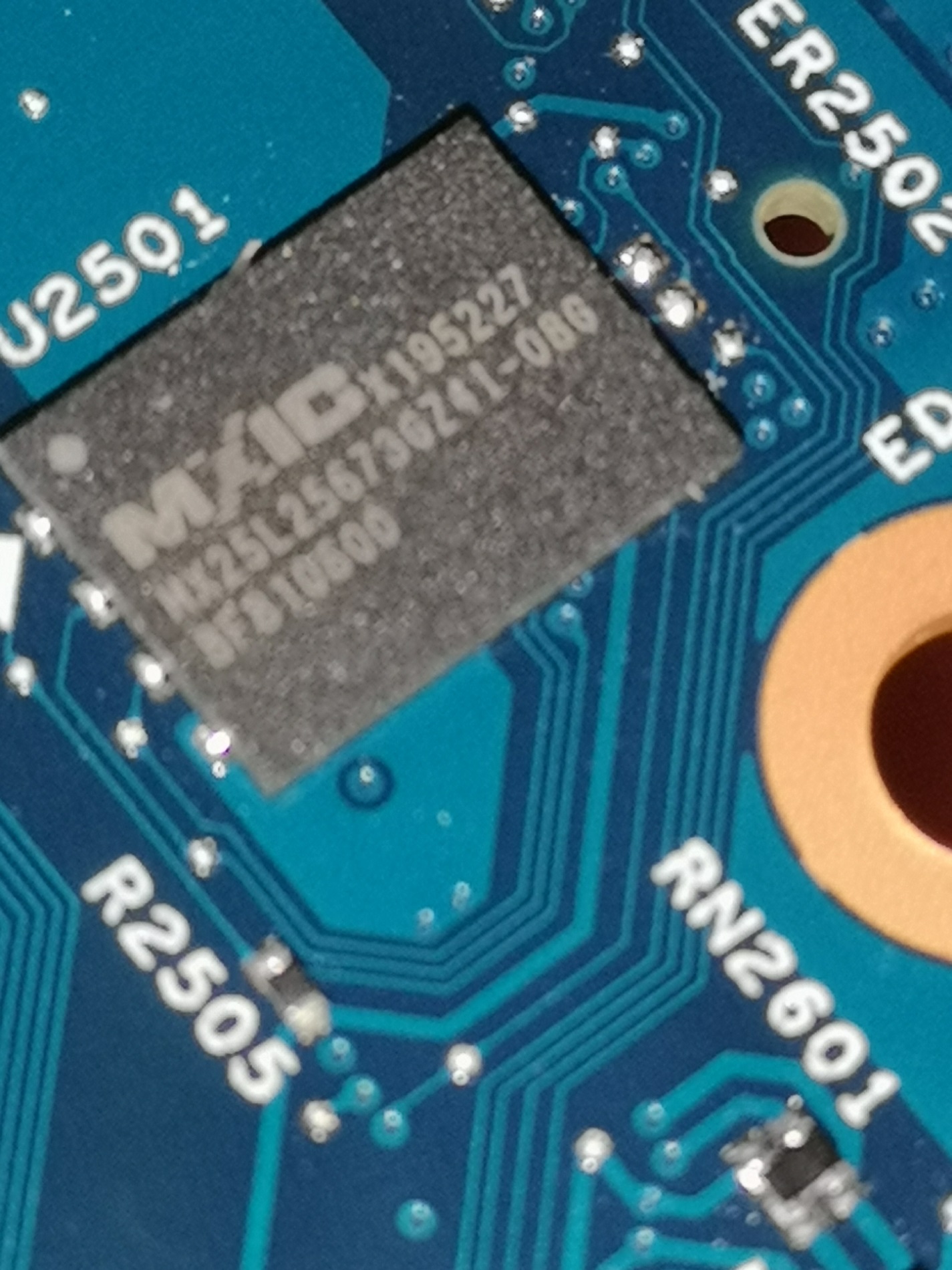

            another thing when i make detect auto on programmer i have mx25l25633f but on the chip is writted mx25l25673g can it cause problems

              Re: Latitude 5300 2 in 1 with a Locked Bios
              No problem, it's part of the same family.

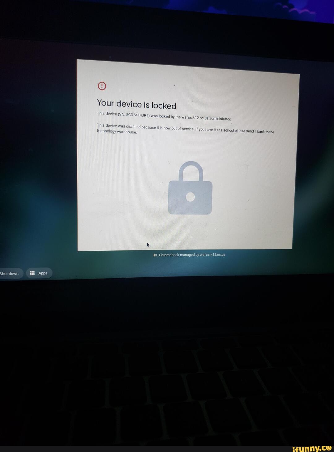

                              Dell Latitude 5300 2-in-1 bios protected
                              i have dell latitude 5300 at login i get a message blocked by solvay.com
                              motherboard : Fircrest13 18780-1
                              i need a clean file or clean my file by change serial number and clean please

                                  #36
                                  Re: Dell Latitude 5300 2-in-1 bios protected
                                  i will look again for another chip but i guess this chromebook have only this 1mb bios
                                  i get a lock like this picture mean my serial locked from an website or administrator

                                      #38
                                      "5CD5414JR5" This serial number belongs to "HP Chromebook 11 G4"
                                      Something weird.

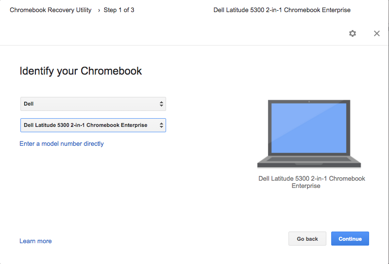

                                        • volinakis
                                          • Jan 2021
                                          • 2874
                                          • N/A
                                          #40
                                          edit my old post this is the full dump
                                          try this. after writing this bin you have to reinstall from USB stick created with chromebook recovery utility for your model.
