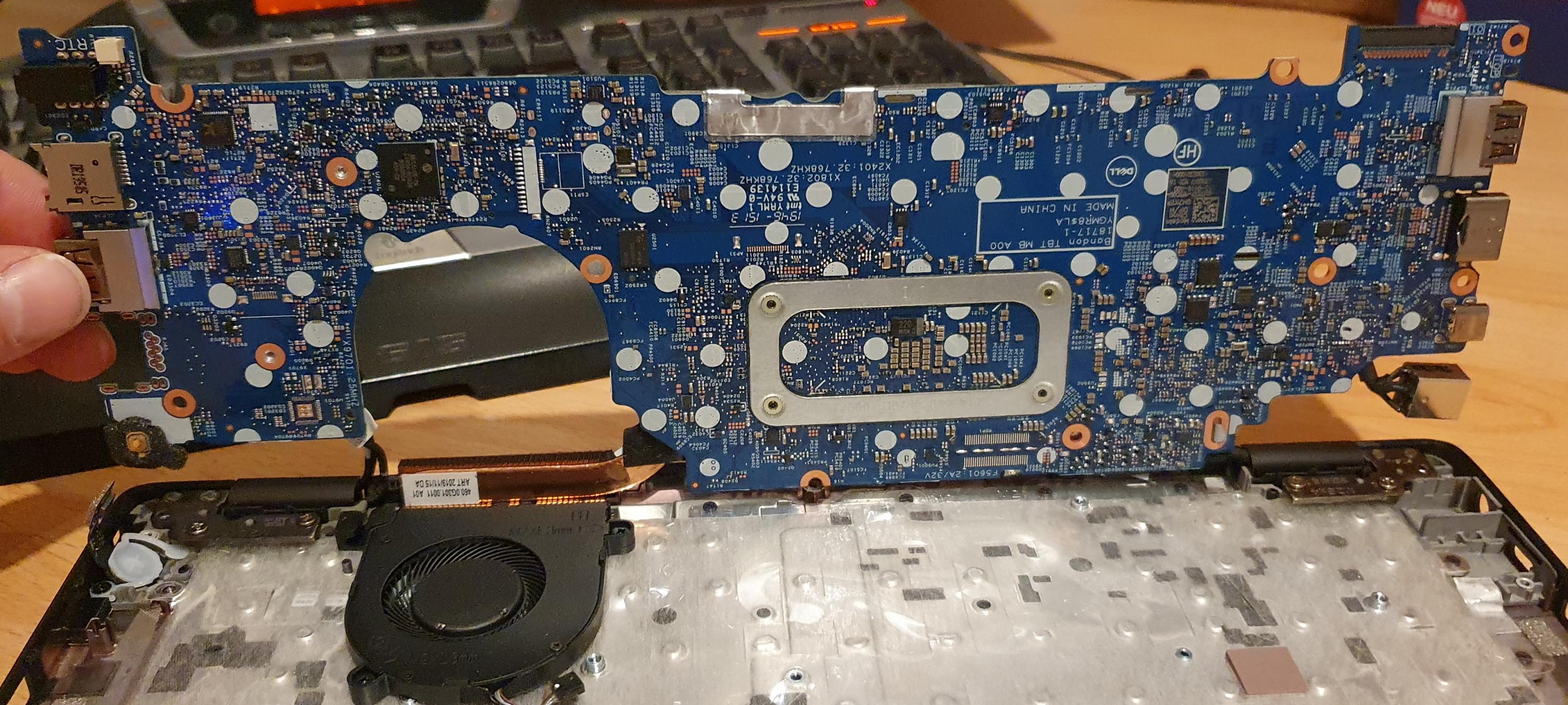

    Latitude 5300 2 in 1 with a Locked Bios

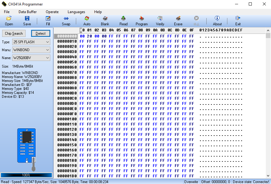

    i have a problem, i read my bios chip und it works but wenn i save the bin file it have only 1 MB... all bin files here in the forum are 10 or more MB... what make i wrong?

    Re: Dell Latitude 7400 Bios Password 8FC8 Suffix
    here pictures and the bin file.
      this copy is empty ... look on both sides of the motherboard and another bios chip, make a copy, check it with the HxD program, and post it here ..

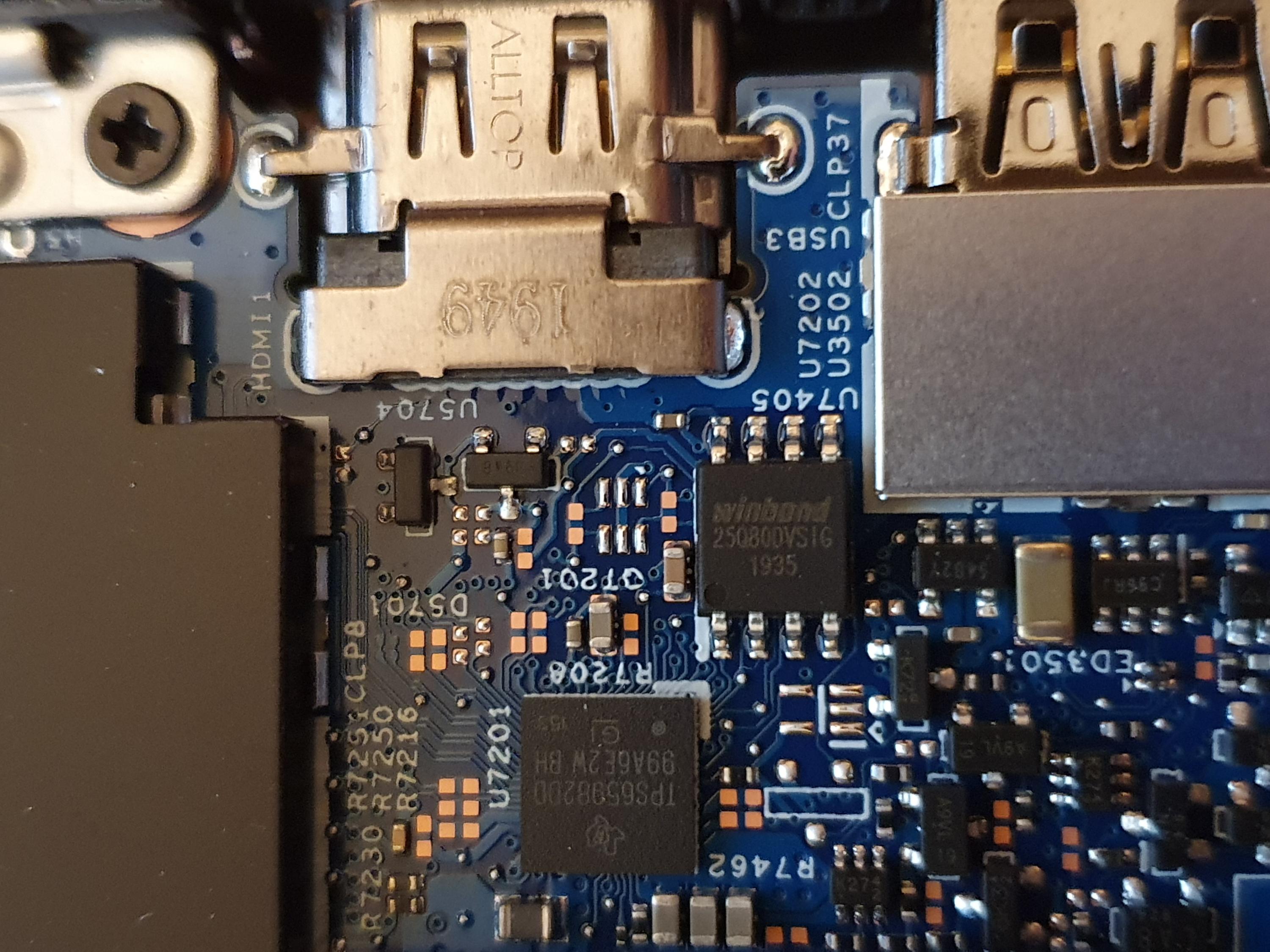

        Re: Latitude 5300 2 in 1 with a Locked Bios

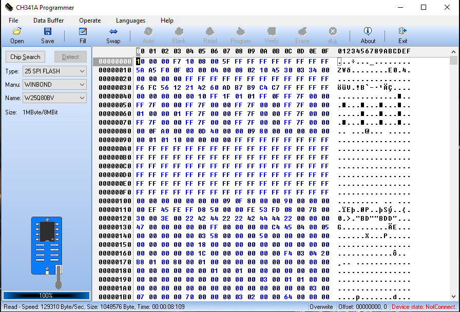

        i read the chip again, because i cant found a nother chip. I think the file is now not empty but ist still 1MB.
        The chip on the laptop has the number : 25Q80DVSIG 1935
        The Programmer detect: W25Q80BV Size 1MByte/8MBit
        U can see this on my Pictures.
        Thx for help

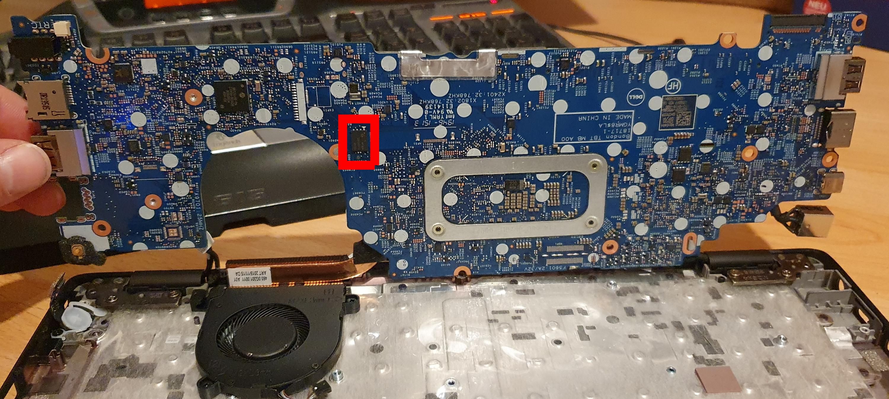

          Thx for help

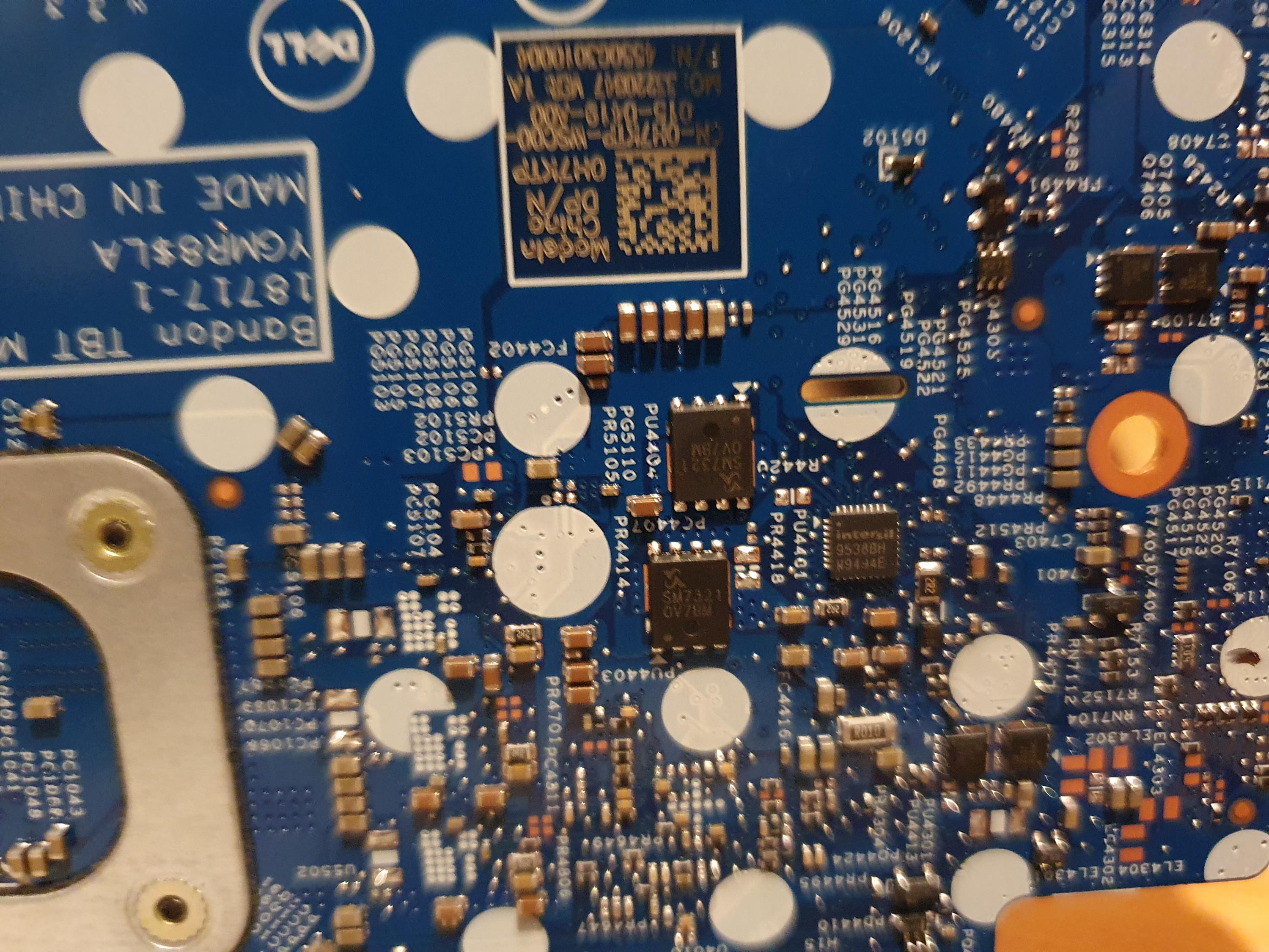

          what model of motherboard do you have ?? .. look between the fan plug and the battery plug .... I think there is the bios chip, and it has 32MB ...
            • 20709
            The motherboard is Wistron Bandon. I think the bios chip is a Winbond WSON 32MB
              Winbond 25Q80DVSIG is an 8 Mbit chip = 1 MByte

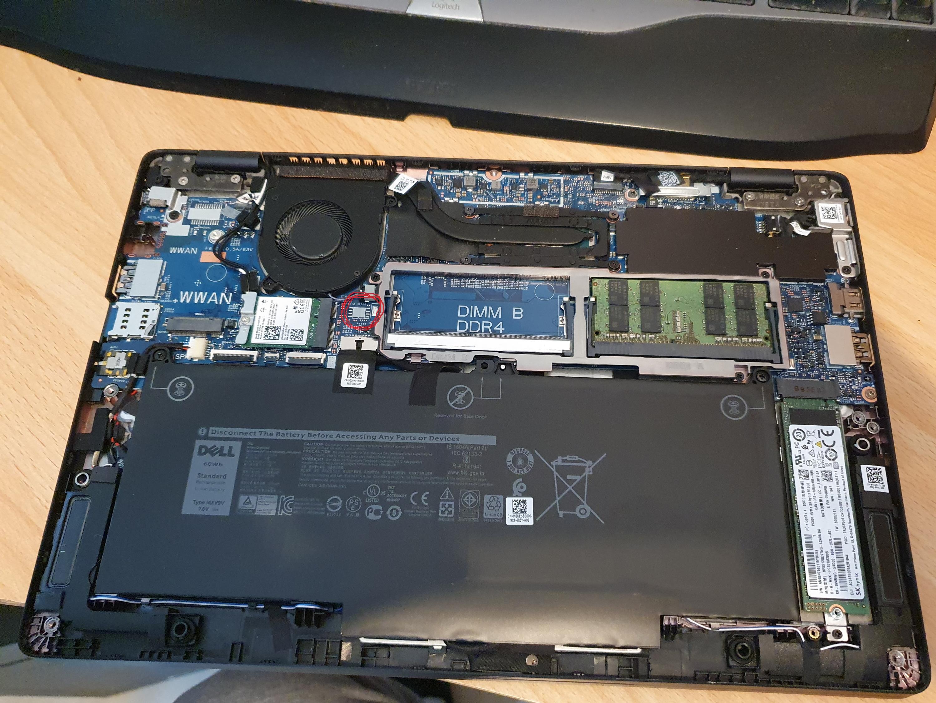

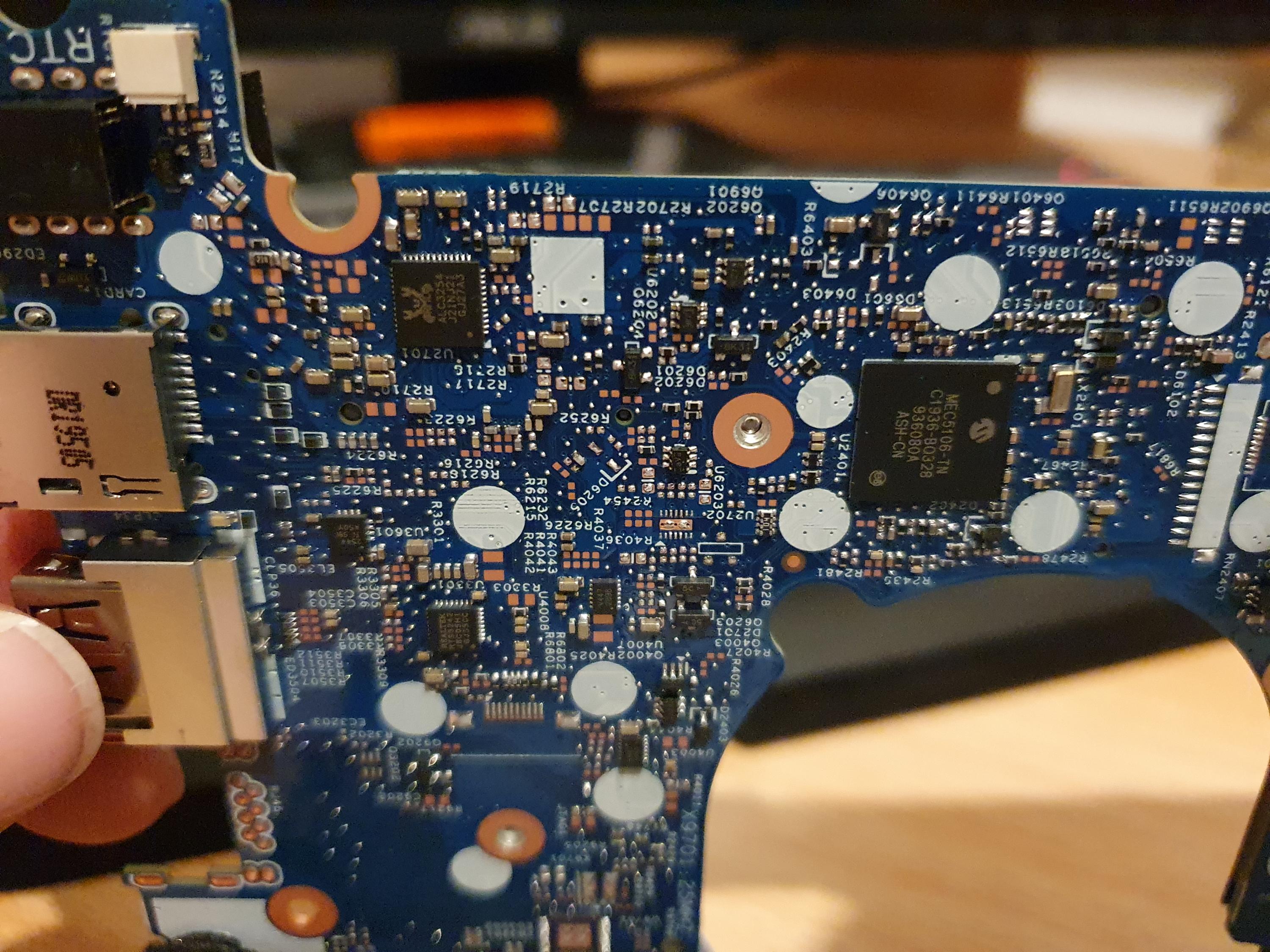

                i look between the fan und the Battery but here is no chip, can the chip mounted on the other side of the Board ?
                A Picture form my board.
                  • 20709
                  It is on the other side,near the metal CPU bracket. It will say Winbond on it ,post the part number and a picture

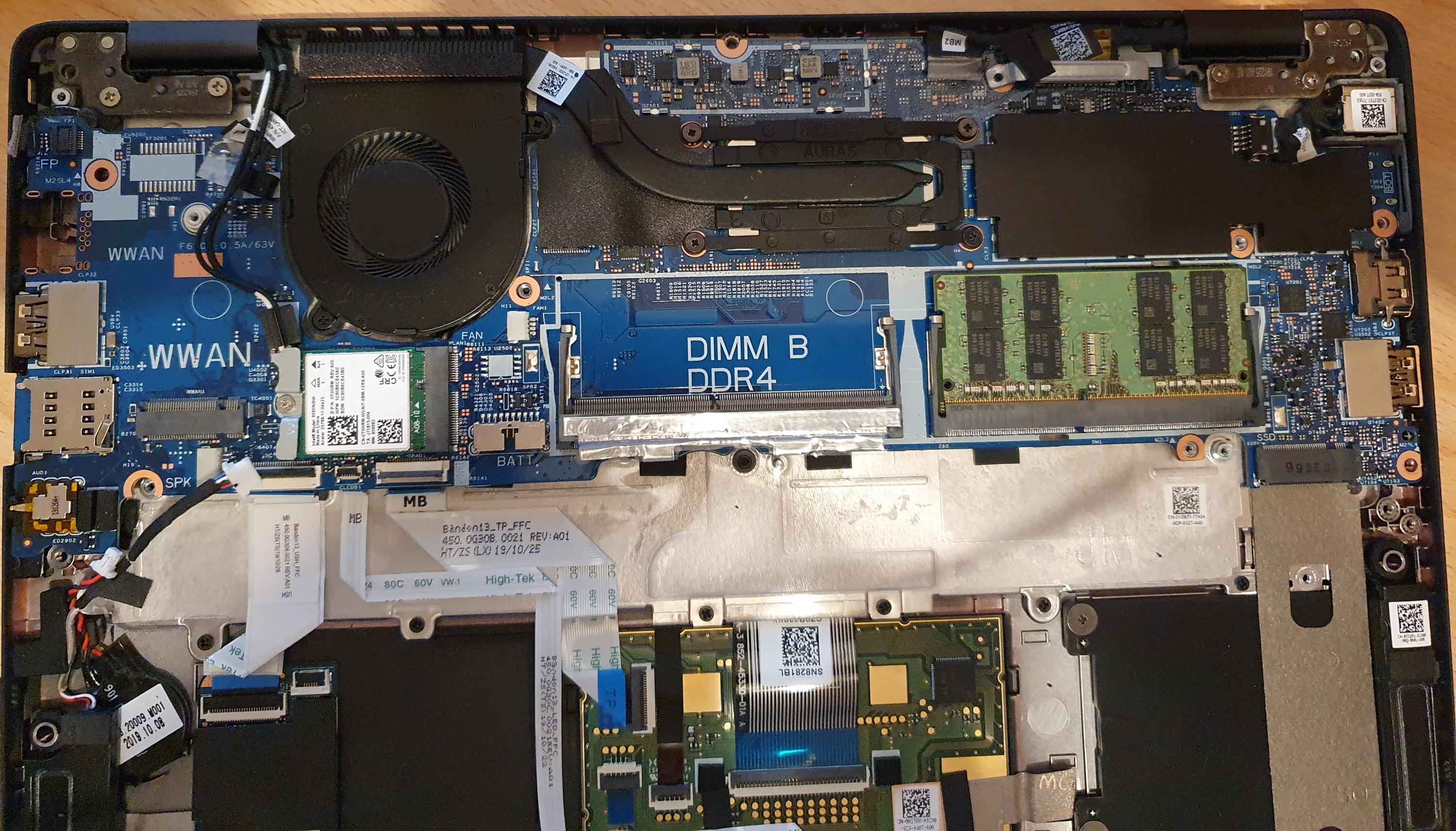

                    hi,
                    i nearly dismount the hole Laptop ,
                    part number of the chips:
                    - SM7321 OV78M
                    - intersil 9538BHN9494E
                    Im not sure if this are Bios chips ;(

                          Your rar has compressed down to 741.6 KB its no good ,make another backup.The code is mostly all FF`s look at it with a hex editor or the hex window in your programmer

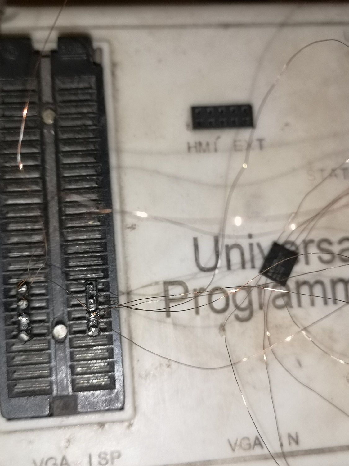

                            i have two backups the first 771ko and this 1.144
                            ok sorry i make another because i saw all ff
                              • 20709
                              Have you desoldered the chip from the board,something is wrong as both backups are different.If you have soldered the chip to an adapter it is not making good contact or the chip is bad and its not reading the same every time.
                                yes i have desoldered it and i have make only wire with adapter
                                  • 20709
                                  if you`re using an adapter you don`t need to solder any wires ? ,post a picture,resolder the chip to the adapter

                                      • aminealae
                                        • Jun 2013
                                        • 97
                                        • morocco
                                        the wire is insulated but the GND is not connected i search an adapter and i give you good backup
