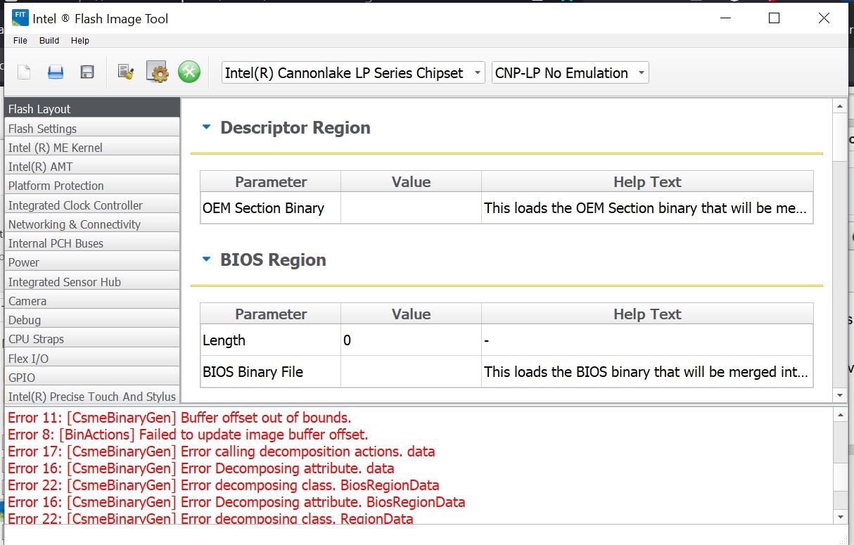

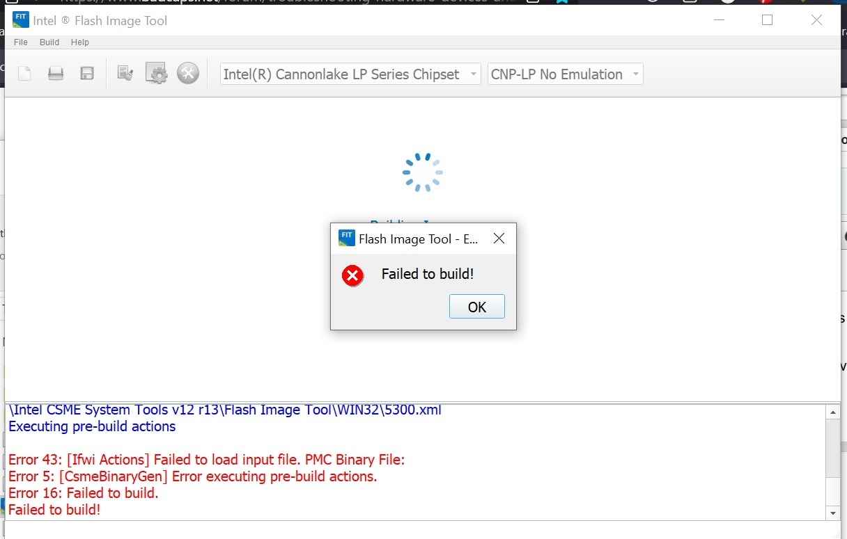

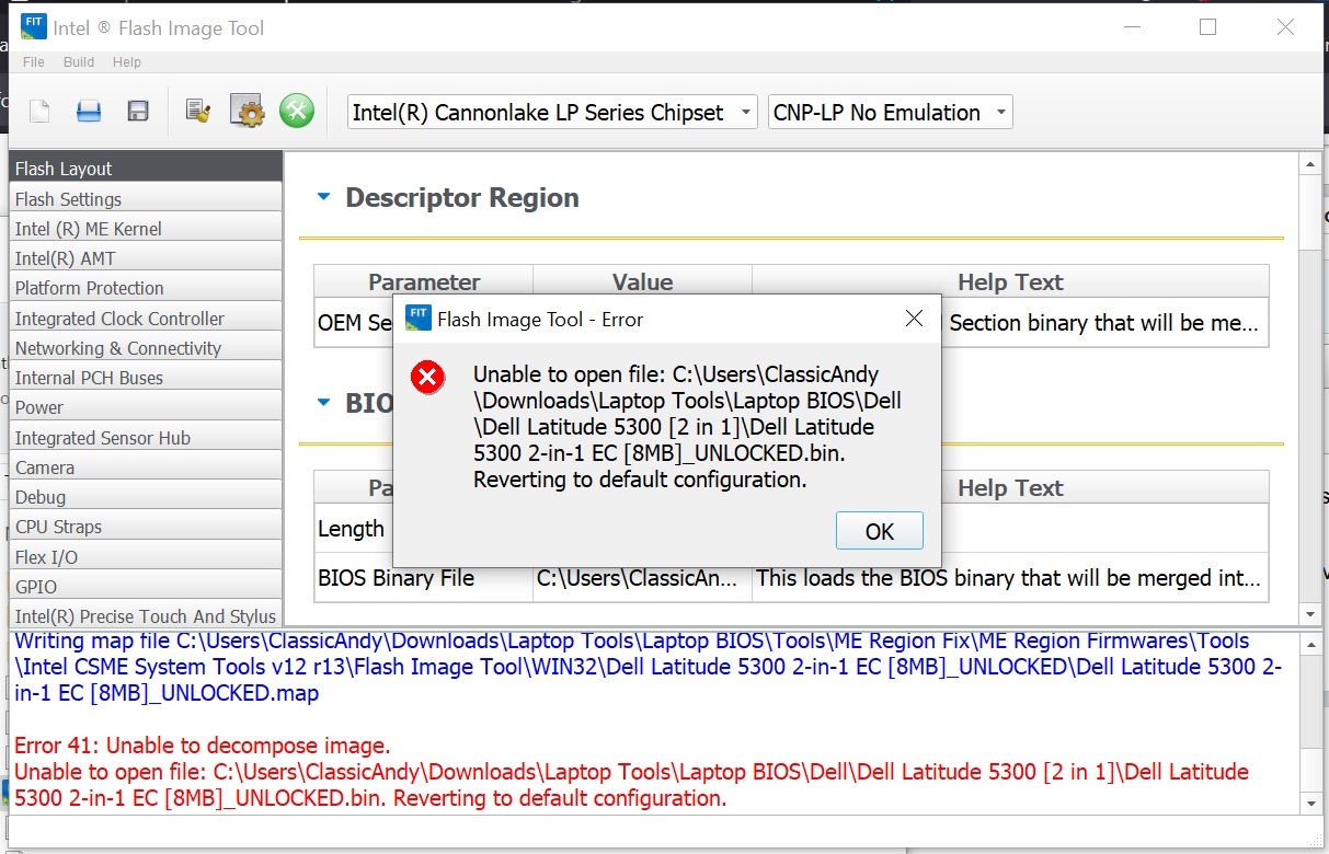

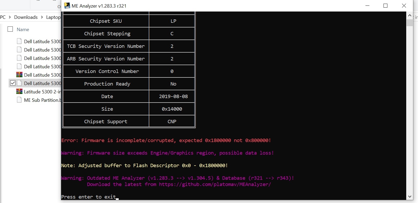

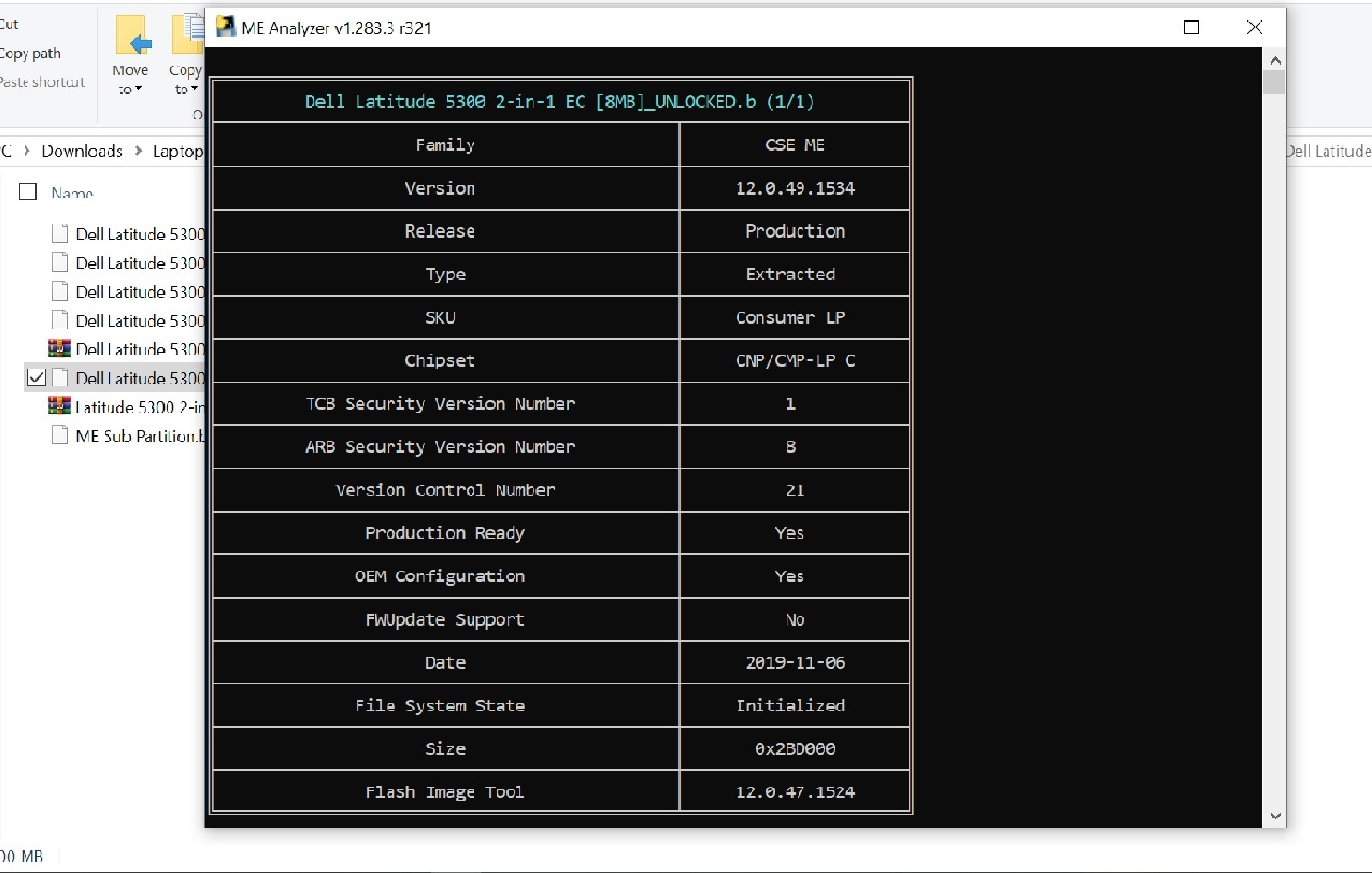

                            Hi, please I tried cleaning the ME Region in the file in the link below but i encountered an error. The file works for me but has 20 seconds delay. The laptop in question is Dell Latitude 5300 2-in-1 using 8+16MB BIOS.
                            https://www.badcaps.net/forum/troubl...34#post1830934
                            I have attached the errors I got using ME Analyzer and FIT. I renamed the file but it is the same as the one in the link above. Thanks in advance.

                            #74
                            I'm sorry if I made any mistake in my previous post, not intended

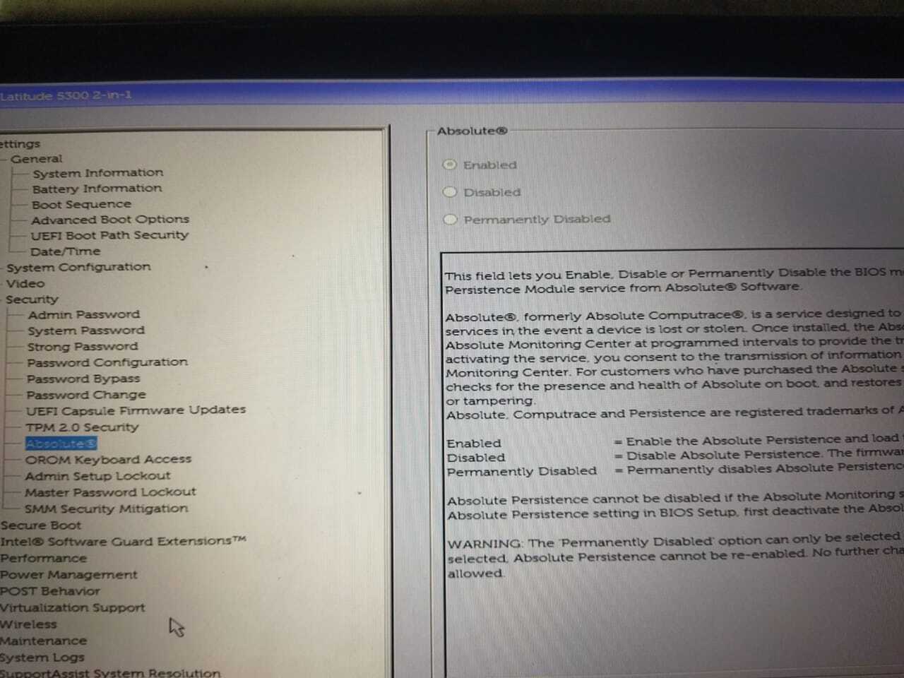

                              #75
                              Hello, can someone help me with this BIOS file reset and remove/disable “Absolute”. Dell Latitude 5300 2 in 1 Service Tag Number: HR45LT2 Thank you, I appreciate the help
                              • rex98
                                • Feb 2023
                                • 1293
                                • Mandaue CEBU, Philippines
                                #76
                                1st boot, press F2, write service tag, disable Absolute, save (Apply changes), restart. 2nd boot press Alt+F to exit manufacturing mode

                                  #77
                                  Great, it worked, thank you very much.
