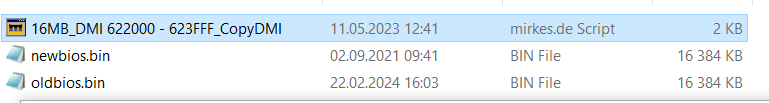

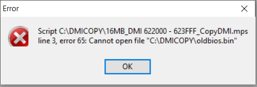

                    I have an error.
                    EDIT:
                    Resolved, stupid mistake, doubled file extension
                    EDIT2:
                    New BIOS didn't repair notebook. Still black screen and LED is blinding.
