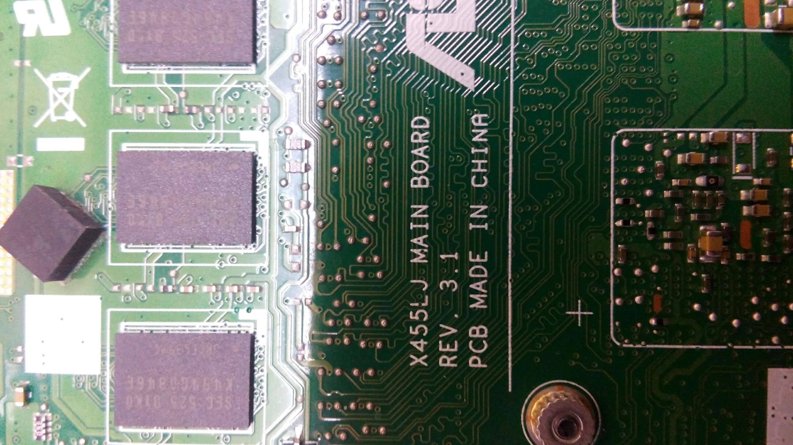

              • 22279
              Re: ASUS X455LJ - BIOS Request
              Originally posted by Duranitron
              what i found is this unit with board model ASUS X455LJ VER 3.1 is using bios program with different model i search its bin file and found out bios model is for ASUS X455LF. that is why all of the bios i downloaded here in badcap for X455LJ is not working.. anyone experienced this?
              Post a picture of the green/white stickers with the model number ,on or near the RAM slot

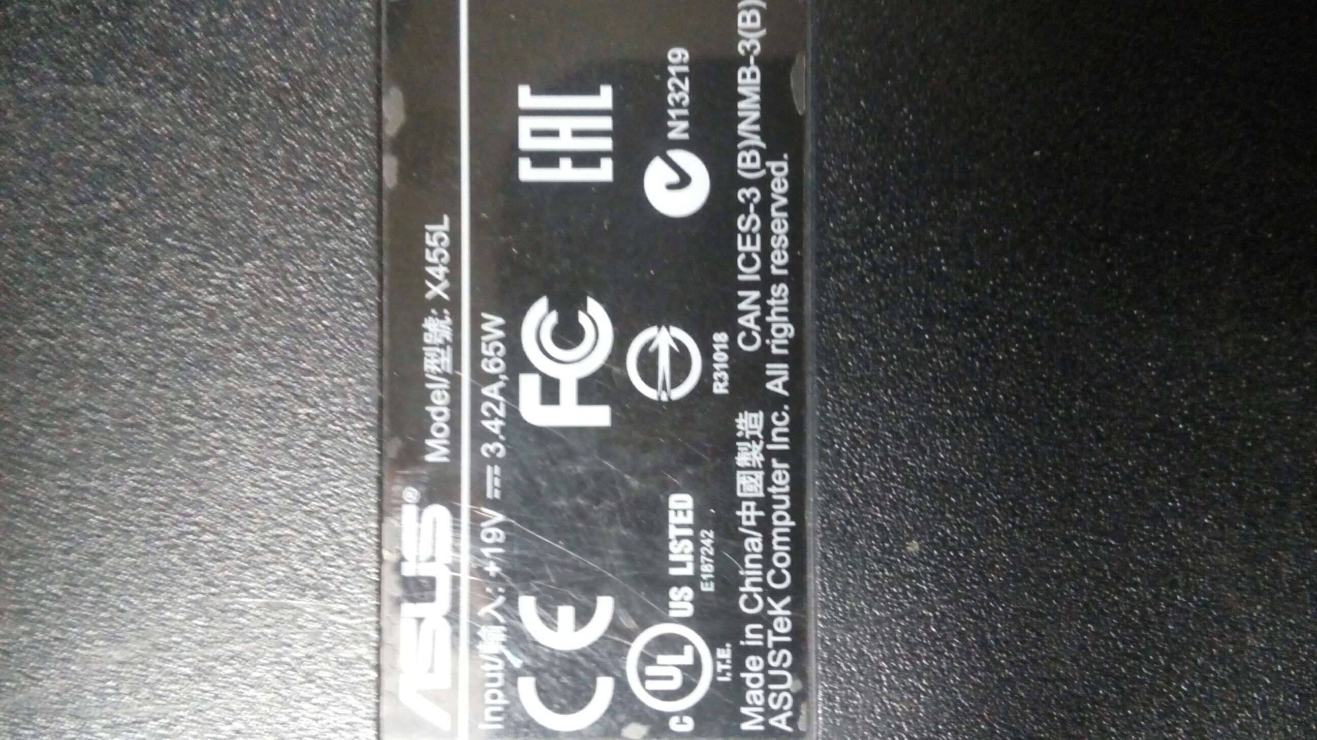

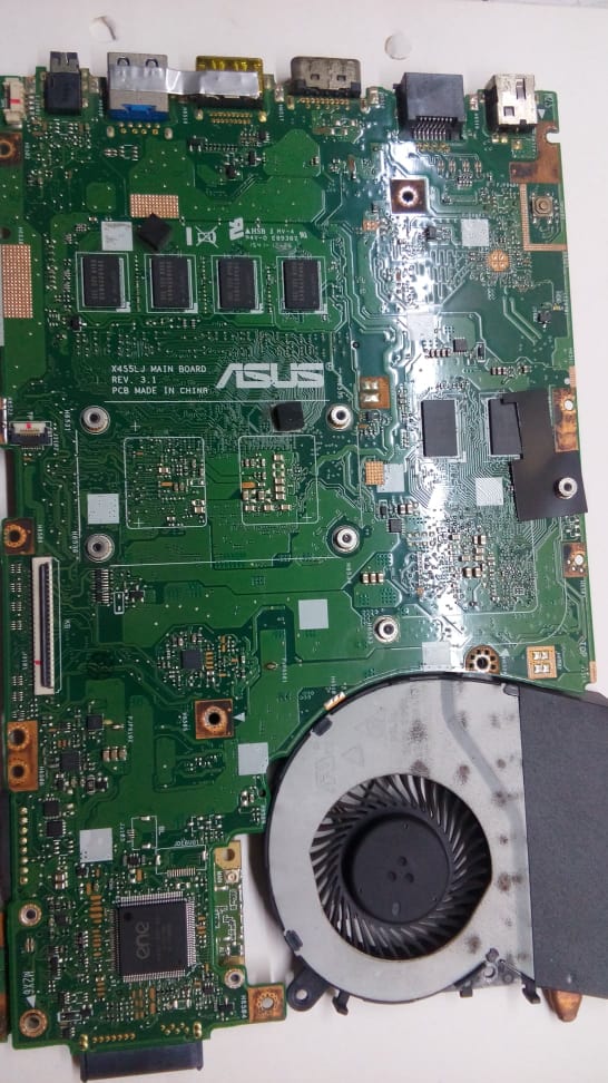

                            here is the model number in the cover of the laptop and the board
                            the programmed bios is for X455LF ..
